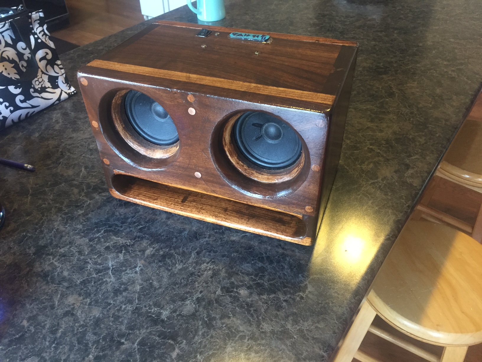

Hi Joe. I JUST did this for X-mas as a gift. Turned out GREAT!
Parts list (the major things):
1)lithium 18V rechargeable battery (they make them for wheelchairs)
2.)Charger (though some come with one, search E-bay)
3.) 50W (what it's labeled as, more like 20W but it's clean) Class D bluetooth board (again, search eBay)
4.) 2 fullrange 4" speakers (I used Focal's, work great)
5.) a piece of hardwood, 1x8x8Ft, enough to make entire project, might even get away with 6' depending on size
6.) brass threaded inserts (so you can bolt on back and take it off if you need to, you drill, put in inserts, and then bolt back piece of wood into them)
That was is except screws, glue, and a LOT of labor.

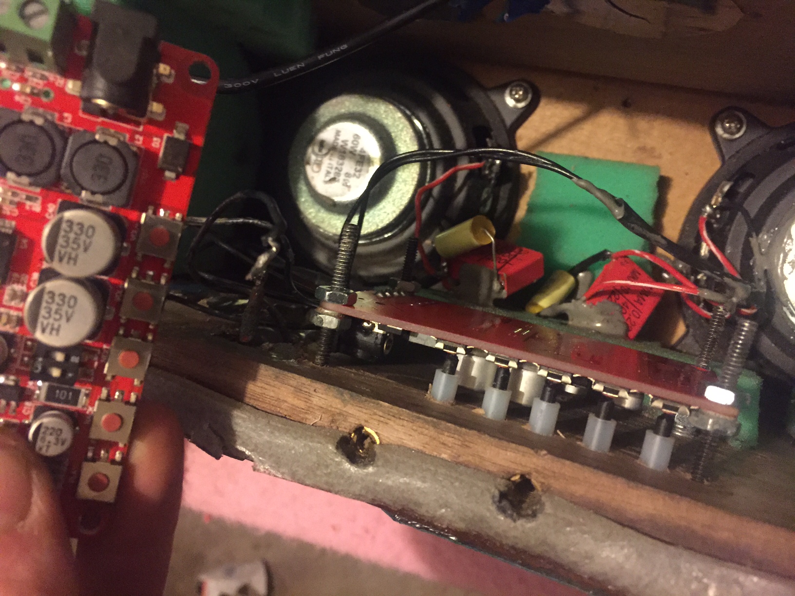

How do you press the buttons on the board once it's inside the box? Check out what I did:
The board in my hand is the same one in radio, I had 2. put those long bolts through and bolted the board up near top. Got some nylon hollow inserts and some nylon rivets to use as pushrods. Then you just glue something flexible over the top to hold in the pushrods. Bingo! Now you can use all the buttons, and your board is completely hidden!
