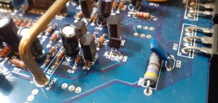

Hi could anyone help with an equivalent part B114 transistor .
There are lots of pnp transistors that will sub for that one (2sb115) It’s just a matter of do you have the correct pin configuration in stock or are you willing to use something that doesn’t match up with the pin fin configuration and willing to bend the pins to match up. What do you have in stock?
It’s your call.
