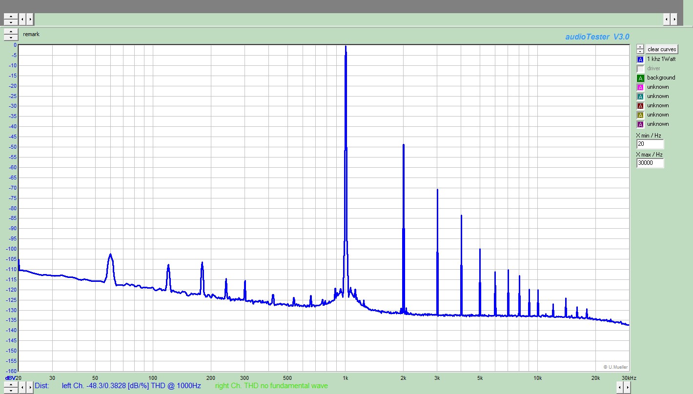

Its been a while (about 1.5yr) since I have built any amps, but I have had some parts burning a hole in my closet that required me to get off my butt and do something with.
What I built was a fully regulated 300B amp using a 6C45n driver tube CCS loaded into a power drive then into the 300B. I know of the mixed reviews of the 6c45n but I have them and I wanted to see if I could tame it. The OT is temporarily a Edcor XSE 15-8-5K and I am pushing 80mA bias @375V. The 6c45n is 150V at 15mA.
I have never really measured a SE amp so I am curious of others perspective of the results. The amp sounds nice but the measurements are ? I am happy with the noise floor however. at 1Watt(2.82V into 8R) i measured 1.004% THD. Is this pretty normal for a 300b SE? I would think there is alot I could do to make it better. The freq responce is 27(-3dB) to 90k(-1dB).
After working with my mullards, I have no feel for what would be good.

It sounds decent because of the distortion's spectral distribution.
Post a schematic, please. Maybe combination bias, without a bypass cap. on the cathode resistor, can be employed. That would linearize the 300B.

Its been a while so I am rusty on the test equipment which is why I posted such a lousy looking spectrum. Is that a normal harmonic distribution and magnitude for a 300B?
For a VT like the 300B, single-ended, that's a normal harmonic profile. Looks pretty good, what's called a "waterfall" distribution. You could improve on the harmonic distortion performance by including a higher quality (more $$$$) OPT and/or applying gNFB. Some SE designers/users would consider the latter "heresy". You've already gone heretical by including SS in the design, so why not wrap some gNFB around that 300B?
It's also a good thing that you opted for the "power drive" topology. Lots of complaints about less than stellar sonics from 300B's stems from inadequate grid drive. Power triodes like the 300B present the driver with a less friendly load than pents, due to the higher reverse transfer capacitance that gets magnified by Mr. Miller, the presence of grid current even before Vgk actually goes positive, and the much larger input swing. If you don't take that into consideration when designing a driver, you're likely to be disappointed with the end result.
Distribution yes, magnitude no. 1% at 1W and 1KHz is a bit high.

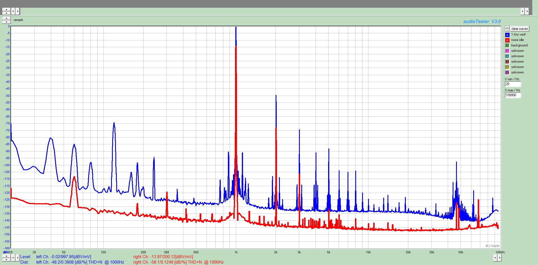

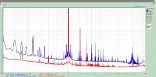

Thanks for the feedback, 45, Eli and Miles. Have a little time to play so worked on my measurement system and came up with the attached. 0.39% THD+Noise is a much more realistic number. IMD appears to be a bit high so need to look at OPT and Ht regulators. Blue is Output at 1 Watt into 8 ohm, the red is the driver signal into the 300B offset bu 14dB
The IMD surprises me. Curious to see if OPT or regulator is responsible Schematic soon.
The IMD doesn't surprise me at all. It's 120 Hz ripple mixed with your signal frequency (and its harmonics). If you aren't already using well-regulated DC supplies for the B+ and the 300B filament supply, I strongly suggest that you implement those.
I think that most of that IMD is caused by the 300B filament supply as it is nearly absent in the driving signal, in comparison.

I was assuming that your filament supply is already DC. If not you should do it, in my opinion.
On the other side it is also true that your driver is CCS loaded so, let's say, it is less demanding in terms of HT supply. Anyway IMD overall is not bad at all. The main peaks around 1KHz are at -90 dB! You could see how it looks at higher output. Sometimes people don't see it because they don't have enough resolution.

45, it is a regulated DC using tomchr's universal filament supply. and TheGimp you are right, the B+ madia did not have enough operating headroom. Problem corrected on this plot.
That makes more sense. Nice plot! I'm guessing the 1 kHz +/-180 Hz components originate from the signal source.

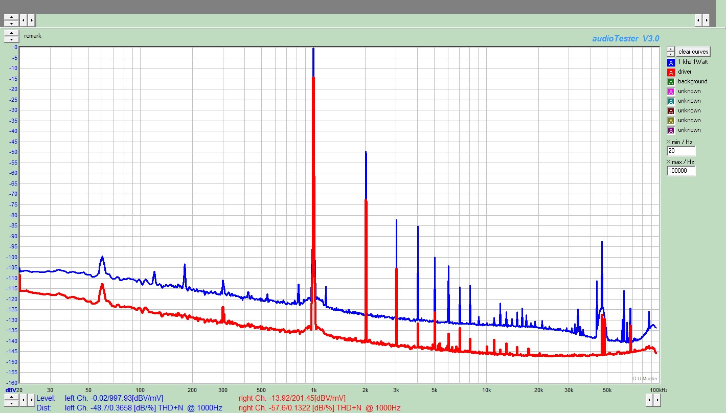

Red is the driver signal at the grid of the 300b. The small 60Hz seen from both is the 1616m sound card. The 180Hz seen at the output is unknown at this point. I still need to post a schematic.
FYI tested the tranny and it is spot on at 25:1. Redoing the bread board to clean up a few things. After having a little time to think about the results so far, I am now suspicious that the bias current I am measuring may have another load beside the 300b bias included. I don't see it looking at how it is wired but a good look is in order.
As it is wired now, the 120mA (assuming that it is really 120mA) doesn't even phase the tube.

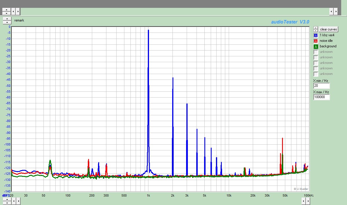

Purchased some JJ 300b's. Much Better!!!. Still some work but at least in the ball park now. Attached graph is 380V at 80mA bias. The 60Hz peak and harmonics is from measurement system, as I can see the same with power off.
Bias Current was spot on so no sneek circuits in the loop.

Careful with the high bias currents. With fixed biased, JJ's "spec" says 100 mA max. You can go to 160 mA with auto-bias. Still... Obey the 42 W max plate dissipation.

I thought 80mA bias was within its safe range? Thats 30 Watts on the plate.

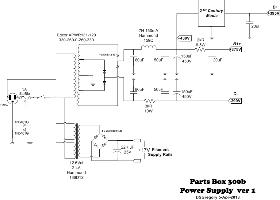

I am finally getting around to post able schematics. This is how the power supply is built currently. The 300b uses the Universal filament regulator and the 6c45 uses a LM317 in constant current mode. I have those on the amp schematic I am working on now but will probably add them to the PS schematic.

Max cathode current for the JJ 300B is 100 mA in fixed bias; 160 mA in cathode bias. So, yes, 80 mA is safe.
