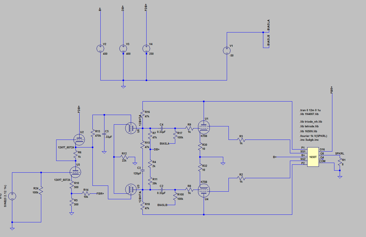

How should I work with partial feedback so my stage does not clip and distort more than when there is no partial feedback? In spice this happens. Also it happens in one of my amplifiers. It seems to be normal.
I am running the feedback off of the power tube plates through a resistor to the plates of the output tubes to the phase splitter anodes.

Adding R16 and R18 makes the phase splitter clip sooner (the lower the resistor value).

The problem with adding those feedback resistors is the increased loading of the driver. Think Miller Effect here: the effective value of the 47K feedback resistors is really:
47E3 / (1 + Av)
Given the 47K plate loads, you're cutting the effective plate load to much less than half. That's way too much, and I'm not surprised you have a premature clipping problem here. Given the lowish u-Factor of the LTP triodes, I'm surprised you're getting any gain at all.
This type of local NFB wasn't intended to do the whole job, but rather as a supplement to gNFB. That's how I applied local NFB where I needed it to tame the nasty harmonic signature of PP 807's. Holding it to 10% of the plate AC ( as recommended by O Schade ) reduced the loading effect to manageable proportions.
You already have lNFB with the Ultralinear connection. You don't need those feedback resistors, and certainly you don't need nearly 50% of plate feedback, especially when you have lNFB anyway.

The way I am computing the feedback is measuring the gain open loop and subtracting it from the closed loop gain. It comes out to be 18dB. Perhaps I am computing it wrong? In spice the numbers come out just fine without local feedback (assume 47k resistors are deleted).
To obtain the gain and distortion levels I want, I need 18dB of global feedback. With PPP quads, oscillation is more prone to occurring. With two tubes, it is usually fine. What is your thought of using that much global feedback?

In this design, the LTP is a 12BH7A with a u-Factor of: u= 16.5 (nominal). It doesn't provide very much gain, and as an LTP, you lose half of whatever gain you can get with passive plate loading. Assuming a reasonable 60% of u: Av= ~5 -- 6 V/V. That ain't much, even without any gNFB at all.
You're going to have to make it up in the pre, and since the 12AY7 has a u-Factor of 44 (nominal) it can be done, but will need either active plate loading with a solid state CCS. You could also use bootstrapping since you're already using a dual triode. Either way will give nearly u-Factor voltage gains that can make up for the low gain of the LTP, and allow for reasonable input sensitivity and gNFB levels.

The formula for finding the closed loop gain yields a closed loop gain of around 17.5 (25dB) I measure 106 for the open loop gain in spice (about 40 dB). Subtracting the two yields 15dB. I think I still am mixed up somewhere.
What GF Db gain number did you compute so I can find where I am mixed up? The spice project is attached

You have a number of problems.
You will have massive distortion because the 47K anode load resistors on the 12BH7 are anti-bootstrapped and will look nothing like 47K, probably more like 10K.
That is due to way too much "partial" feedback. You do not see all the effect of that feedback as it is divided down by the low rp of the 12BH7 triodes.

You need low current and high rp for the triodes in the phase splitter. 12BH7 is not the right choice. You need 12AX7 or even a pair of pentodes instead. Look for the Baby Huey Wiki that Bas has put together and see how to use shunt feedback from the output tube anodes.
