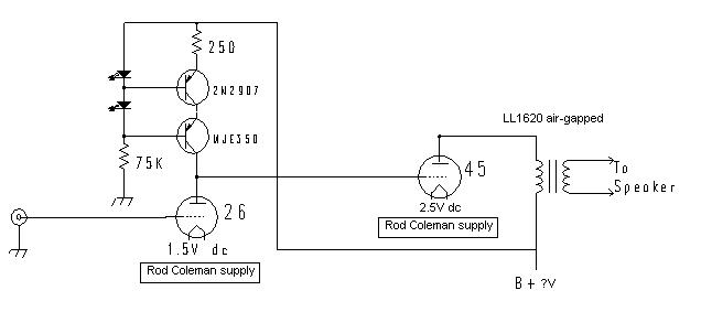

Ok, in how many ways would this be a disaster? It's just the CCS loaded driver stage from Gary Pimm's design, with the filament supplies replaced with Rod Coleman's design - stolen from the 26 preamp thread, and from various other posts. The output is simple single ended transformer, but could just as well use the parafeed output from Kurt Strain's design by swapping the air gapped transformer for a parafeed, and adding back in the choke and capacitor. I don't have TubeCAD or anything, I'm just trying to get an idea of whether this is total crap or might sound good...
Pimm forces the 45 to start slowly, delaying B+ application and thusly voltage to the driver tube. There isn't any whacky startup behavior in this manner, and from this standpoint the design has good functionality
When you pull the CCS off the cathode of the output tube, the 26 and the 45 may have uneven warmup times, potentially leading to arcing in the 45. (Also, that CCS would have pretty heavy LED bias with a 75K resistor on 45 plate voltage, I'd go with 150K)
