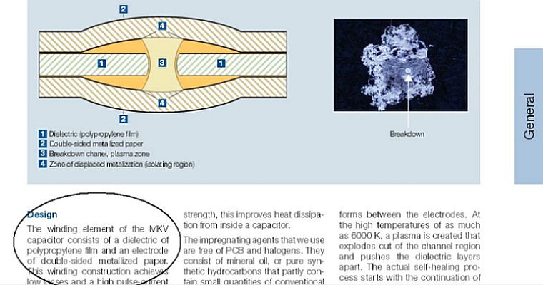

The famous Siemens MKV capaciter (later on S+M and after that Epcos) used a double side metalised paperfoil with a pp (polypropyleen) dielectricum. ITT and Icar used simular techniques (not always double sided alu paper foil)
I also have some Jensen with the text " mixed" dielectricum on it. Jensen say: "Electrodes of aluminium foil and mixed paper/polypropylene dielectric, mineral oil impregnated (non PCB)"

It could be a copy of the famous Siemens MKV capacitors.
MKV capacitor has a polypropylene dielectric and double sided metalised paper as electrode.
Save it. For me, Siemens MKV is best capacitor ever made.
