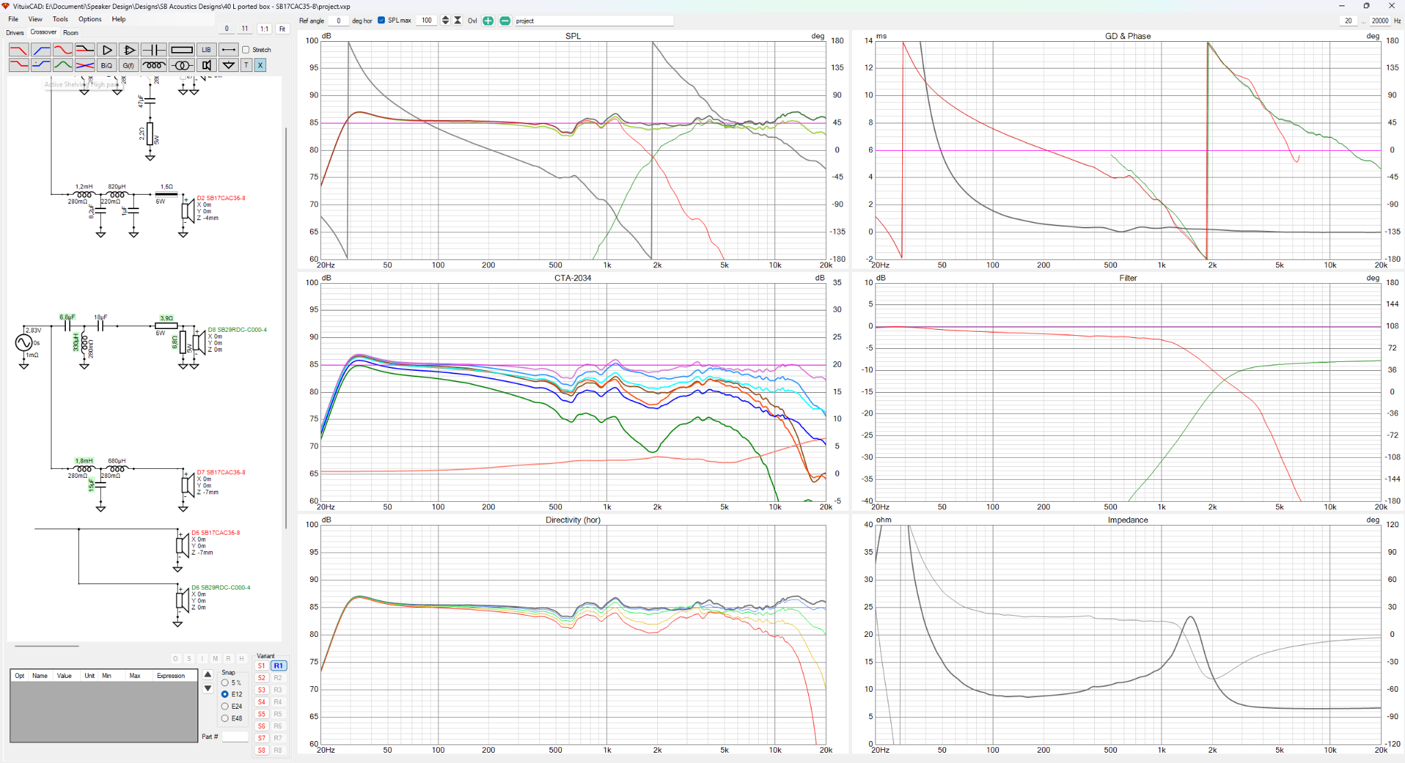

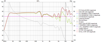

I've been designing a tower speaker lately with the chr-120 and the sb acoustics sb29rdc-c000-4. The main reason why I'm pairing a tweeter to a fullrange is because the off axis response of the chr120 alone is not the best and I wanted to make a tower that would sound nice in a good range of positions in my room.
The design is a 60 L ported box, the vent is 18,3 cm long and 9 cm ID, made it so that turbolence is not a problem even at the highest volume the speaker can play.
I started the design by tracing the responses from the manufactures datasheet and modelled this crossover in the image (i attached also a zip with all the files). Since I don't have the speakers in my hand yet and am not prepared to make measurements I was wondering how far off this design would be from reality, especially considering the phases are calculated from vituixcad and in the woofer i set a z offset to match the impulse response calculated by vituix as well.
Since I'm a student and don't have much money to spend experimenting, am I fine designing a speaker this way and getting all the parts, rather than buying parts and changing them later?
I'm open to any kind of advice!

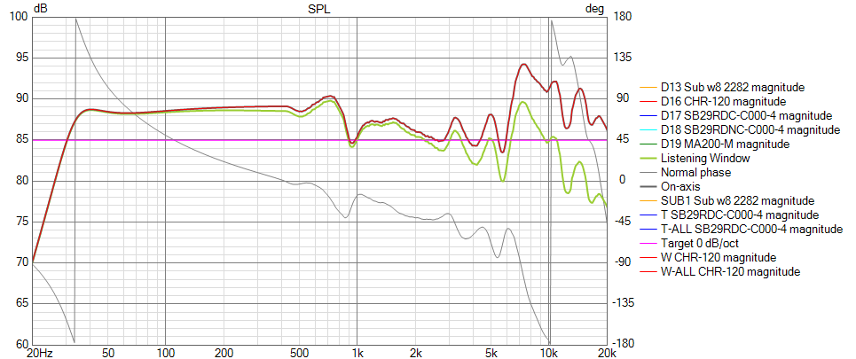

At first I wanted to see what the driver alone was capable of, but the problem was that the midrange was about 5 db recessed compared to the rest, reason why I opted for a tweeter. I know it's uncommon to use a fullrange as a woofer paired with a tweeter, but I liked how deep the bass could go with such a tiny driver and getting a +- 1,5 db on the full spectrum was very easy with the chr as a woofer. The distorsion is also very low with this model as far as I know. All considered, the chr 120 costs as much as any good midrange as well so I though why not?
I tried using other woofers as well, like the sb acoustics SB17CAC35-8, but somehow I couldn't get the phases to overlap in the xo region, maybe I could change tweeter or woofer if you have any suggestions

I have a dac and omni mic for measurements that sometimes I use with my current speakers for eq with rew and equalizer apo, but I've only done in room measurements so far and never tried measuring raw responses from driver trying to keep away the room interaction, and i guess i would need that to get good measurements to start from am I right?
Anyways I'd really like to use the chr 120 if I can, I've become quite obsessed with it and need to try it out now...
SBA_SLOB_GUY I'll further investigate the 2 inch FR as super tweeter and see what I can get out of it, any good reccomendation for such a driver? I know tang band made some small FR like that but never tried a design with them.
As for general guidelines, my question is if it's okay to design a speaker without having the drivers on hand, just by manufacturers datasheet and frequency responses, just to know if i need to buy 400 euro of stuff before realizing the speakers are not how the graphs told me...

Short answer is that using the FR graphs in the manufacturer's data sheet will not give you the accurate results for your crossover; for your speaker, you will need to take measurements on the baffle that you have designed.
If you really want to try the CHR-120, then my suggestion would be that try it out as a wide band / full-range first.

Wait, I did not mention that in the crossover I did take into consideration the diffraction calculated in vituixcad with both drivers, and also the delay of the woofer from the tweeter caused by the difference in offset of the acoustical centers. I also merged the woofer files to the the woofer response in enclosure, in order to get the closest approximation for the chr-120 response in the modeled box.

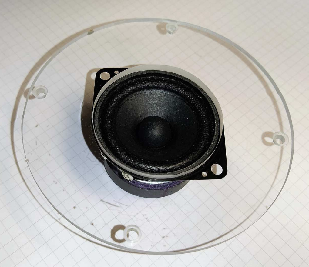

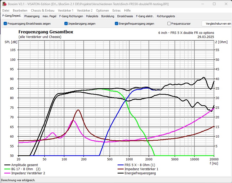

Hi there,
here in Germany K + T guy Thomas Schmidt is using since decades the Visaton 2 inch FR chassis as decent cone tweeter - here the data sheet
https://www.visaton.de/en/products/drivers/fullrange-systems/frs-5-x-8-ohm
there are also some ideas available for a decent mounting option like this here
Hope it helps, Stefano
P.S.: if you want to sort out before hand what you can get out of this without buying the chassis (in this case very cheap although) Visaton offer a simulation software where you can play around with the Visaton chassis
https://www.visaton.de/en/literature-software/software
Boxsim has a far easier learning curve as Vituix CAD (only my personal opinion, i am a little bit too old for Vituix CAD), but Visaton want you to use their chassis and not other stuff, but there are ways to import measurements from other chassis

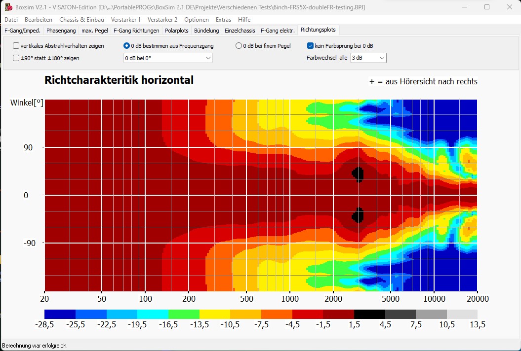

Hi there,
here the first quick and dirty simulation with Boxsim using a very old 17cm Visaton FR chassis as a bass, active crossover 800 Hz Linkwitz-Riley 4th order, no active EQ at all
The BG17 is more for guitar speaker and need a very large bass reflex enclosure with still no bass below 80 Hz, but it has the right size for comparison
The whole stuff takes me 15 minutes, 10 minutes to get the screenshots posted here

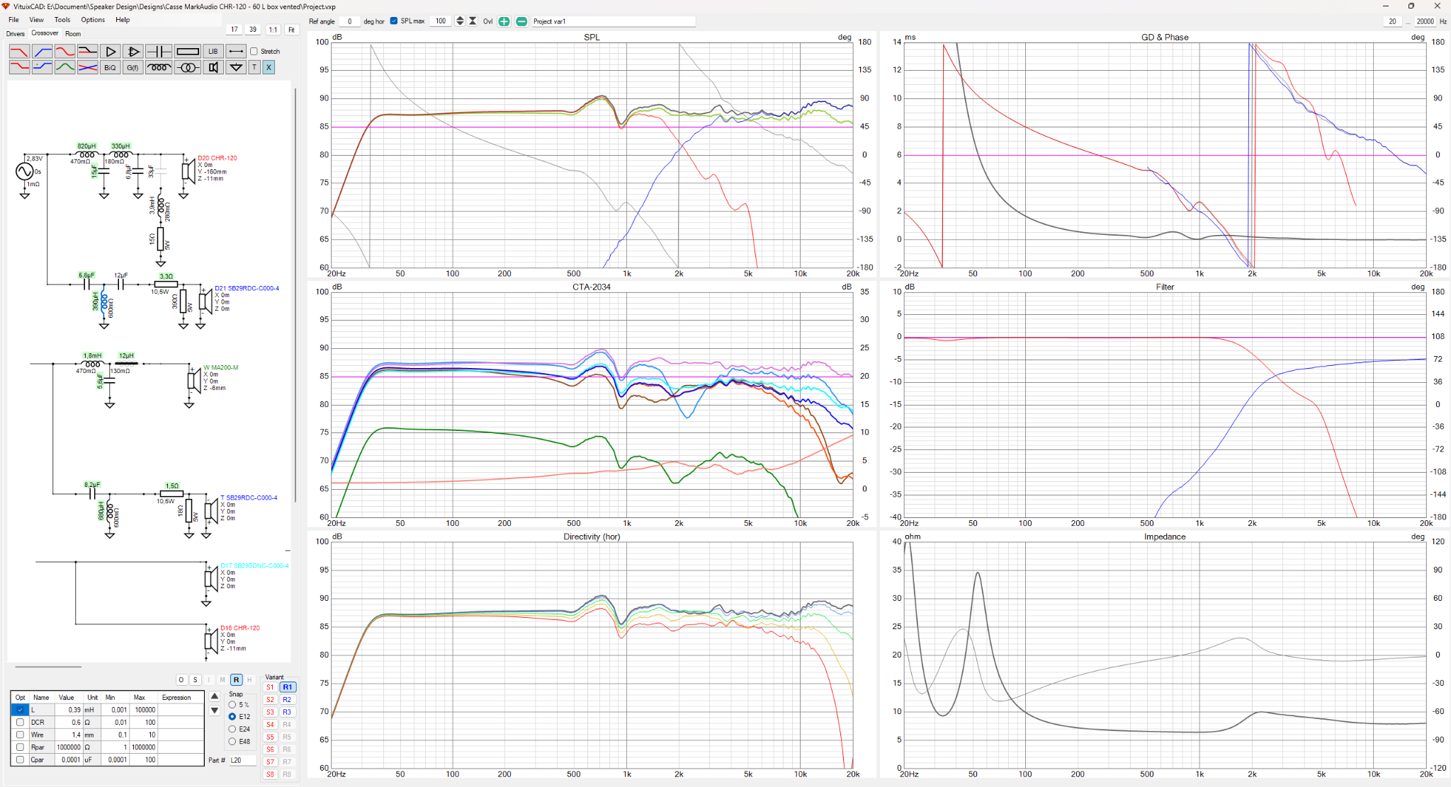

Hello everyone,
I tried tweaking the first crossover I posted here some more but found it hard to get a response without dips in the woofer side. The main issue I'm having is phase alignment, somehow whatever driver I'm using I really find it hard to get both a linear response and phase alignment of the two drivers. In the attached image I was trying to align the phases of the sb acoustics sb17cac35-8 and the tang band w2-800sl (a 2 inch full range that should be able to cross low). Somehow I can't make these fit together, but this happens with almost any tweeter or small fullrange I try to blend with this woofer, and also happens with other woofers as well, which makes me wonder if I'm doing something wrong...
Hope anybody can help me understand why it's so hard to get phase alignment and good response altogether, thanks!

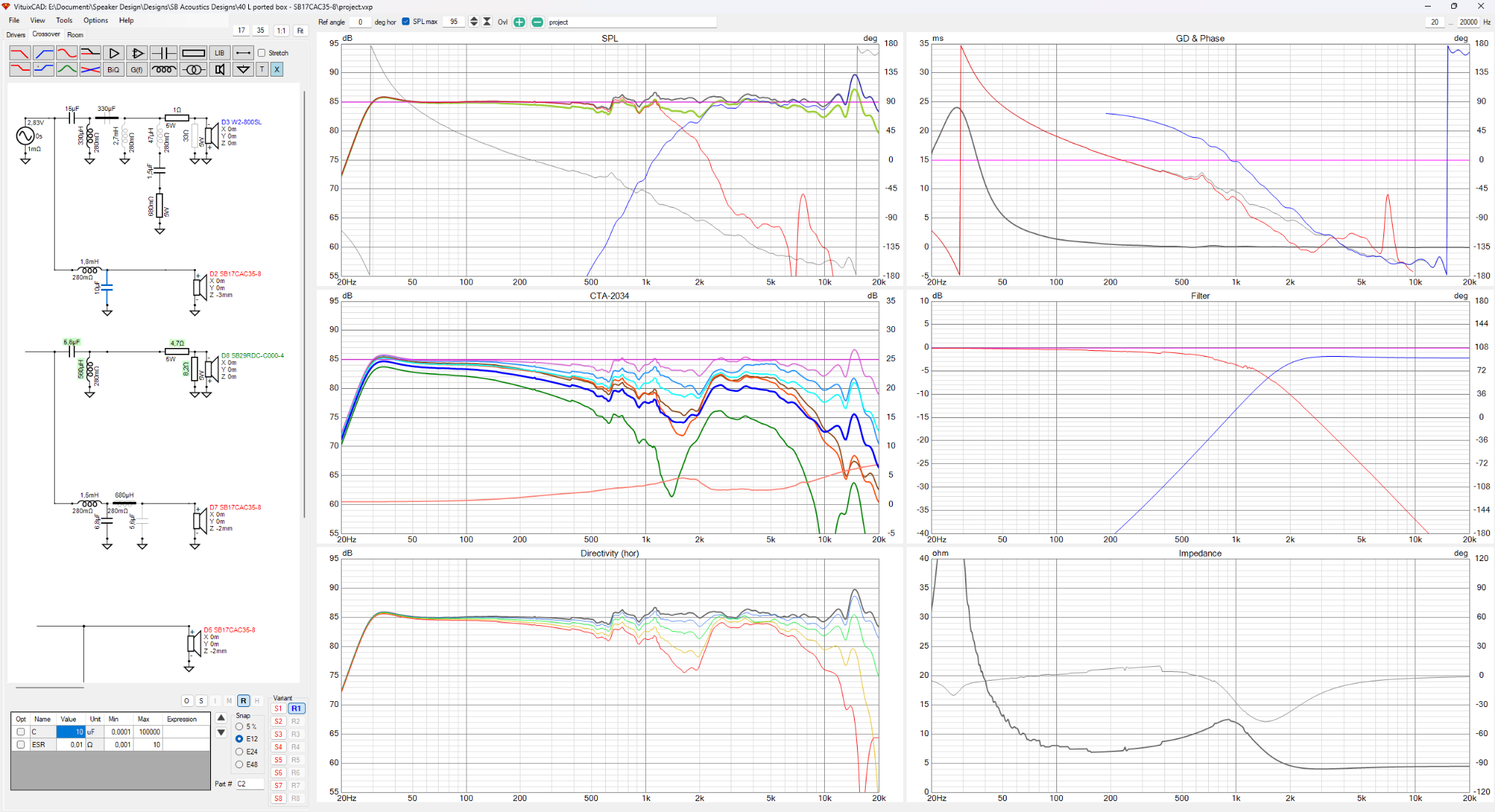

Eventually I understood that the sb29rdc blends generally more easily with a third order filter and the result is the first image attached. What bothers me is the hill happening from 500 to 900 hz followed by a 3 dp dip at 1000 hz. The rest, is linear enough for me and the phases overlap well in the xover region. Still I don't like the dip at 1khz, but that's chr fault.
I also modeled another tower, 40 L with the sb17cac35-8 and sb29rdc as well, the response look better to me and the phases overlap well too, so i might stick with this smaller design and try and see what happens. The main difference between the two designs is that the chr 120 can go louder than the sb17, 8 - 10 db louder in fact, but still the 95 db within the cone excursion of the sb17 would probably good for a small room like mine. Files are attached below if anyone's interested!

Thank you Stefano,
I used the vituixcad impulse response tool to see without any filter applied the two calculated impulse responses of the woofer and tweeter and then applied a z offset to the woofer until the highest peak of the two overlaps. Sure it's not a measurement of the impulse response but I guess it should be pretty accurate, when I get the speakers I can take some measurements and then fix the crossover with real data. I'll keep you updated!
