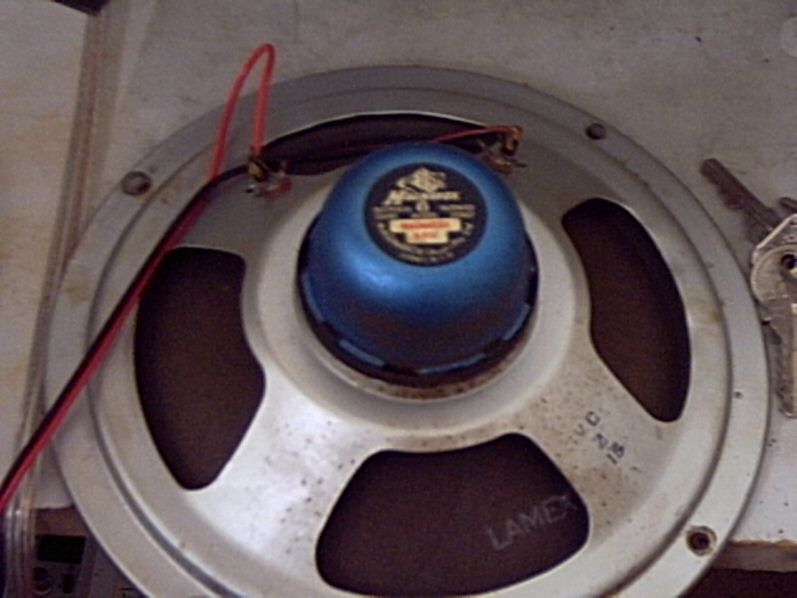

I was wondering what you Aussies have heared in terms of reputation about mainstream quality of speakers in the oldies still floating around in dumpsters as bewieldered ghosts of scott himself?
The speakers are Magnavox LAMEX Magnaflux, Model: 8 P1X
Patent no 234180-237457.

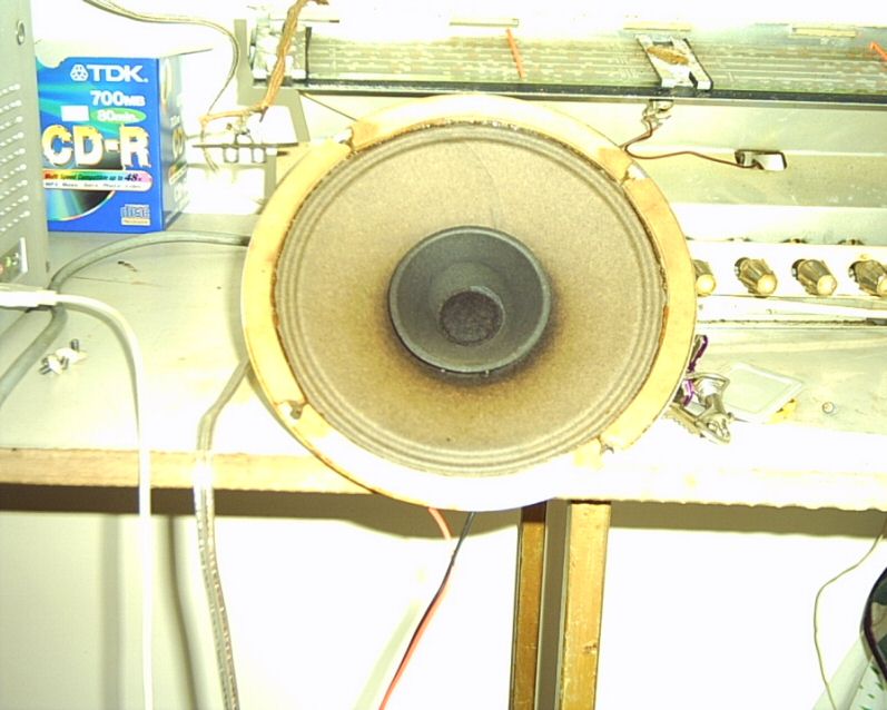

Layberinthius said:Anyway the cabinet gone, i'm left with the descision to make up a cabinet of my design (preferrably horn) and place these in use once more...possibly if I can get the cash with a pair of 'recommended' midrange and tweeters...I don't believe in bass.
They have tweeter cones and sound apsoloutley beautiful!
Cheers.😀
so why add Tweeter and Midrange units ????????
🙂 sreten.

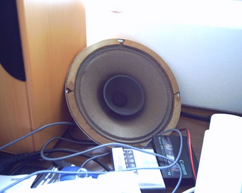

Sure
It won't be the best quality (picture), and you know what they do sound too good to add a tweeter 😛
I'll post one soon, gotta find the digicam first 😛
They might go good in a horn with a bass addition?

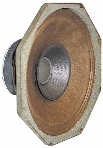

planet10 said:The cone looks very Philips-like...
From the size of the motor these look better suited for an open baffle (or a suitable QW design)... the Q might well be too high to do well in a horn.
dave
Yep, I have some similar, and they work nicely on a (cardboard) baffle.
Ahh very cool just what I need, something to hang up on the wall!
I'm now considering an open baffle with 'school' design 1x3 foot width, 3 foot tall 1 foot wide...
Upside down so I can get it on the wall and still manage to sit down while listening.
Would this be applicable with 'good' sounding speakers or would I need to make them larger?
They came from a 4watt amp so I'm not sure on the max for them.
And they're definatley nice sounding all the way from mid-bass all the way to high-mids without anything at all...
Cheers folks. Time to get ready on some nice wood and shellac.
