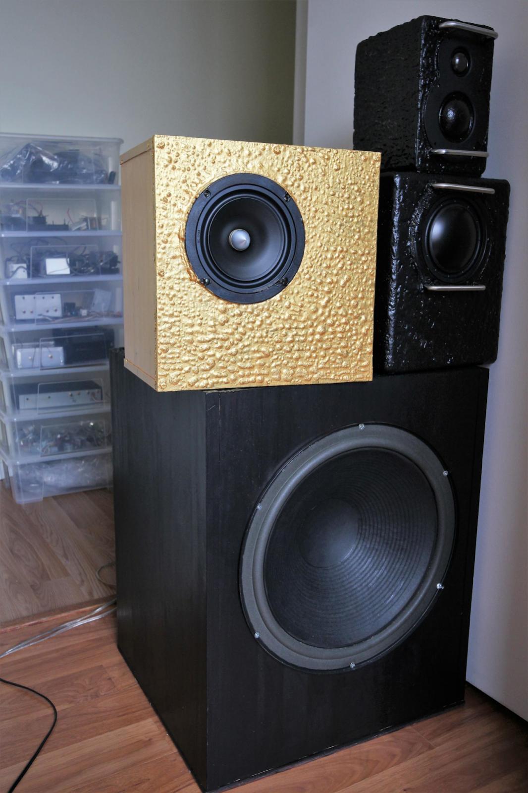

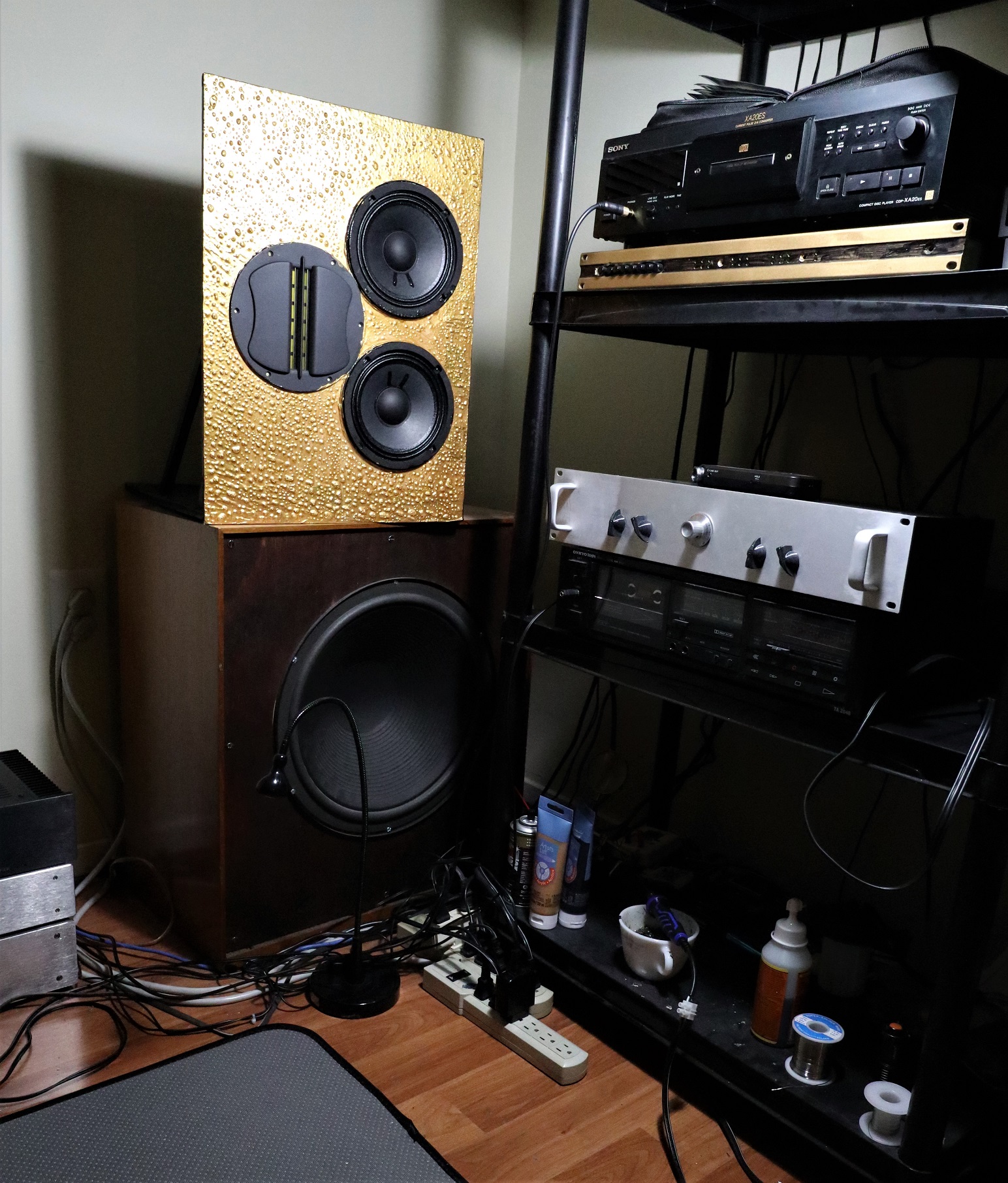

It's not the thickness that matters, but the weight. That amount of gold leaf should add about 0.01 grams, which is going to be insignificant for most cones.
p.s. looks pretty bad, imo
The worst part is that wooden frame on the computer screen
Imo the previous owner liked gold everywhere, look the tweeter cover is also gold painted

I have recently coated speaker with black paint 'wet look' from parts express. I measured response before and after. The coat is black and shiny, but ads very little weight. Therefore I could not see any difference in fr response.
I believe that person is right, it adds almost no weight to midbass, therefore no change in sound.
However it does not look much like gold. I use cheap gold paint on speaker boxes, just for fun.
