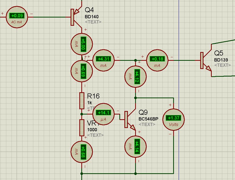

THE BIGGEST problem is the calculation of Q5 base current, here is pic from Proteus:
i dont have a clue how to calculate it. I understand how to get Vbe multipliers current, but i dont understand how to get that Q9 emmiter current (or Q5 base current).

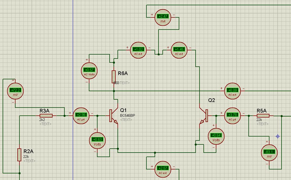

and one minor problem is in differential amp - in Q1 and Q2 base currents.
Q1 base current is smaller then Q2`s because base resistance of Q1 is bigger (24200 ohm, while Q2 resistance is 22k). This is all clear but i still dont have an idea to calculate it.

It is impossible to solve this circuit without using Shockley equation and some iterative methods for solving nonlinear equations.
thanks for answering
you mean shockley equation for a current source because it has a diode? i know its stupid but i look at that diode as resistor in DC analysis (i measured current and voltage and got 1600 ohms resistance). I know thats impossible (diode=resistor) but it eased things little bit, i will go back on it later when i calculate other things.
Well I was talking about this equation
Ic = Is*e^(Vbe/Vt) .
And you cannot replace a diode with a resistor. Because diode static resistance is not constant. It will change with the current. We have nonlinear device here.
But why you want to calculate all this currents with such a precision?
Normally we don't need to know the exact value of a current in the circuit.
It's almost impassible to know exact value. Because we don't know exact value of a Hfe, Vbe, Is... etc
In most of a time we do simplified DC analysis.
We start with Q3
IcQ3 = (Vled1 - VbeQ3)/R7
So if we assume Vled1 = 2V and Vbe = 0.65V we have
IcQ3 = (2V - 0.65V)/560R = 2.4mA
And
IcQ1 = IcQ2 = IcQ3/2 = 1.2mA.
Also we can easily find Q4 collector current
IcQ4 = (Vee - VbeQ6)/(R9 + R10) = (35V - 0.65V)/6.6K = 5.2mA
And Vbe multiplier voltage (between collector end emitter) is equal to
VceQ9 = VbeQ9*(1 + R16/VR1).

I wanna calculate precisely because it is a work for a college. I approximately calculated Hfe, Vbe, but no Is and Ut and so on.. So yeah, i will have to do it other way. Thanks for that!

The base current of Q5 is determined by the load on Q5.
Problem is that i cant resolve where is load on Q5
