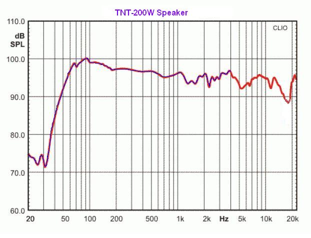

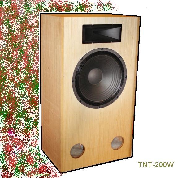

Hi guys!
This is bas speaker E-15 200S (https://www.loudspeakersplus.com/product/E15-200S/P-AUDIOE15-200S/) I have it available.
Combined with the tweeter PHT-404P ( http://www.paudiothailand.com/pdf/products/PHT-404P.pdf), of course with the appropriate crossover frequency default and I have this frequency response.
The sound is great!
Sensitivity 97dB!
Best Regards

You could improve your system if you follow PAudio recommending 8" or 10" woofer to match that tweeter. If you like 15" woofer, you should get a better tweeter to match the woofer.
Thank seanny at the suggestion
But such a combination is very nice and gives a powerful sound!

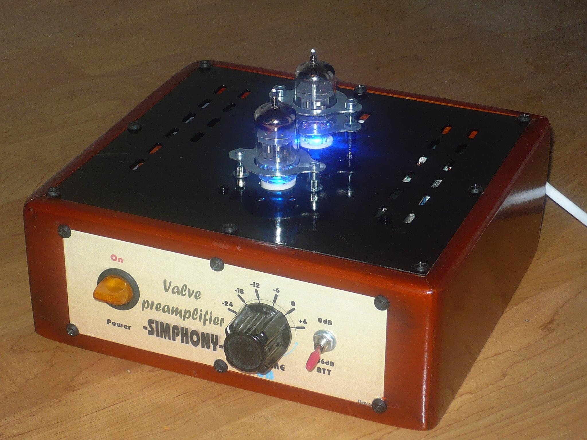

Of course, with the Audio amplifier M-100 (Don Petru)!
And with the tube pre-amp (tube preamp-SIMPHONY)😱
A killer sound!
