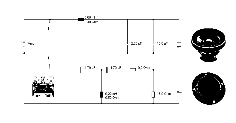

I am planing to overlap cross over frequencies. ie mid cutoff at 5Khz and tweeter at 4 Khz. I would be using first order BPF for midrange and second order HPF for Tweeter. My tweeter is fabric dome with ferrofluid. also I am adding L-Pad attenuator for tweeter. and all the drivers are in phase with each other.
I decided the above method after actually summing the response of drivers ( from graph), network and Lpad attenuator. The overall response is close to flat.
Now I request you all to suggest me if there is any hazel in doing this or any spl care is to be taken.
I imagine that when two crossover frequencies are overlapped there could possibly be addition of some distortion ( adding or cancelation due to phase differences ) because of different transient response of drivers, as well of filter used for each driver.
but this is just what I imagine pls correct me.
What you are saying does not make much sense.
After applying the c/o components each driver has an acoustic response
and it is this, not the crossover components, that determines the filters
(order, frequency and type) that are actually being used.
AFAIK no overlapping topology sums to a flat response, if it does
sum to flat, then it is not acoustically an overlapping topology.
/sreten.

Sreten - it is possible to do, it would just not be adviseable so its never done. The sum could be flat along one axis, and peak up either side of that. If the two drivers were in quadrature (90 dgrees from each other), for example. NO crossover configuration is flat everywhere!
Then you may actually have a filter with perfectly matching slopes, on the acoustic side
What you think it does on the component side is a different matter
And what you think is 1.order could easily result in 12db, but probably something different, like 8 or 10db, or maybe even 15db
But if mid driver rolls off naturally around there, it could also be 18 or even 24db, or something in between
And probably at a different frequency than you expect

Some options, which may be tested even in connection:
- Try padding tweeter down using an L-Pad
- Try even lower crossover frequency (2.3 Khz)
(might be worse due to distorsion of tweeter, but worth a try)
- Try higher crossover >6 Khz
- Try compensating fullrangers voice coil inductance before applying filters

ok well then any words on using second order filter for tweeter and first order for midrange. I used second order for tweeter to avoid it from damaging.
I have done that before - but my tweeter is a compression driver so that makes a little difference. There is no reason that this cannot work, there is nothing hard and fast about slopes, etc. But I have found the better choice to be 2nd order LP and 1st order HP, because the woofer usually needs 2nd order to ovoid its non-piston region. Many woofers, when they start to break-up, have really peaked responses that take steep slopes to surpress. But 1st order on a small tweeter can be a big problem with power handling, but for home use 1st order to a compression driver is no problem at all.
In a CD system, where the axial response falls at -6 dB/oct, a first order HP is ideal since it flattens the axial response. The HP filter is actually set to about 10 kHz. This yields (approximately) 2nd order acoustic HP to the driver resonance, then flat accoustic response to 10 kHz.
I see no issue with a little overlap in achieving the desired flat frequency response. I have done it many times with no serious consequences.
Speaker design is all about compromise, and the benefits often outweigh the drawbacks..
Also remember an MTM layout has overlap over the majority of the spectrum.

@ gedlee - I am using mid and tweeter as a part of satellite speaker. I have finished Subwoofer part. which is active subwoofer with 4order BPF Touch-wood although it took me 3 months to conclude. but its sound is great. had tough time then too. check my posts but here too i ll keep in mind. what u said. Well the reason for using second order filter for tweeter is to prevent it from damage at high volumes. and I decided to use first order BPF for midrange thinking its not so critical. but is worried of phase differences of two types of network.
@ Inductor - thanks for the suggestive diagram. I will get back to you after I execute the design. So can you pls enlighten me with thought process behind this design? how did you decide
Crossover frequency ?
Guys actually I used X-over from other friend of mine ( licences issue ) I am attaching its pdf. pls go through it , and comment.
