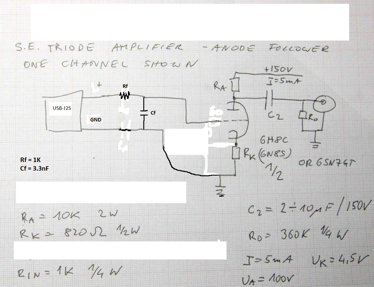

Can I use the attached tube 1578 output stage for "The best DAC is no DAC" DSD low pass filter (Rf & Cf)

[ra + (mu+1)Rk] || RAmerlin el mago said:Someone knows the output impedance?
eu-urh... first you solve thingy inbetween brackets (17K22), then add 10K => 27K22 and then parallel to 10K. So, 7K3
[10.000R + (20+1) x 820R ] // 10.000R = 72.312R
21 x 820R = 17.220R
(10.000R + 17.220R) // 10.000R = 72.312R
21 x 820R = 17.220R
merlin el mago said:[10.000R + (20+1) x 820R ] // 10.000R = 72.312R
Can you see the difference?DF96 said:[ra + (mu+1)Rk] || RA
|| not //
|| means parallel, so x||y = xy/(x+y)
|| not //
Yes thanks for help.
