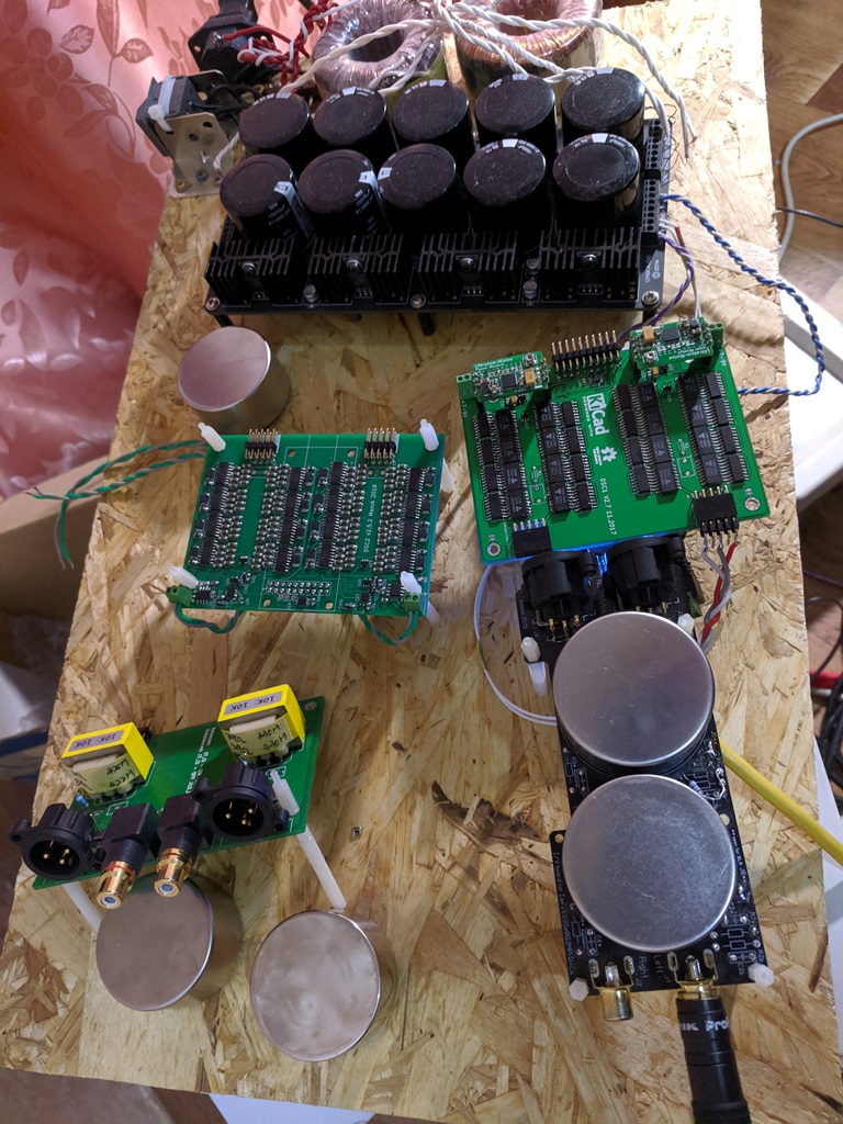

Thank you Mark and Randy for your inputs!
Meanwhile, I have just fifnished the chain of tries around different transformer types for better compatible with the DSCv2.5.2 (assembled by myself - thanks to Pavel Pogodin aka ppy!) and DSCv2.7 - as I understood - the ppy's board (do not understood exactly, but seems it is).
Great news Ivan !!
can you share your firsts thoughts judging by the tests ?
According to measurements the main thought that the DSC is limited by the output stage ONLY 🙂

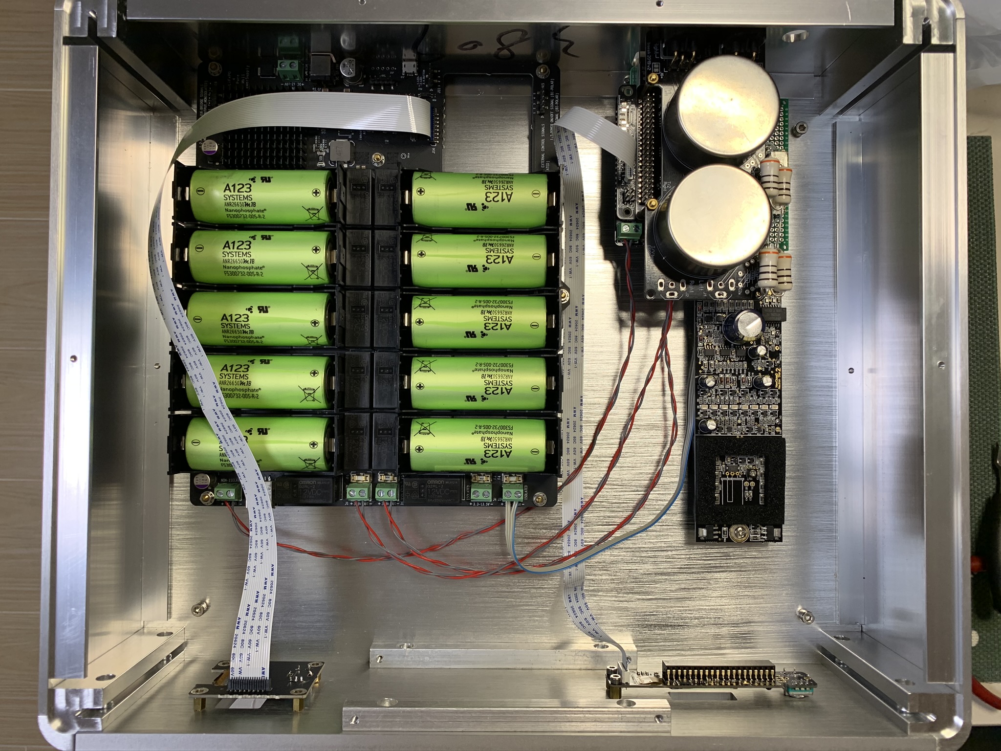

The other revelation was very low noise regulators on the DAC.
I use regulators from ACKO in Sydney.
I cannot recommend them highly enough.
Seconded. I use Acko's regs in my DSC2.5.2 build (top right in the picture);
