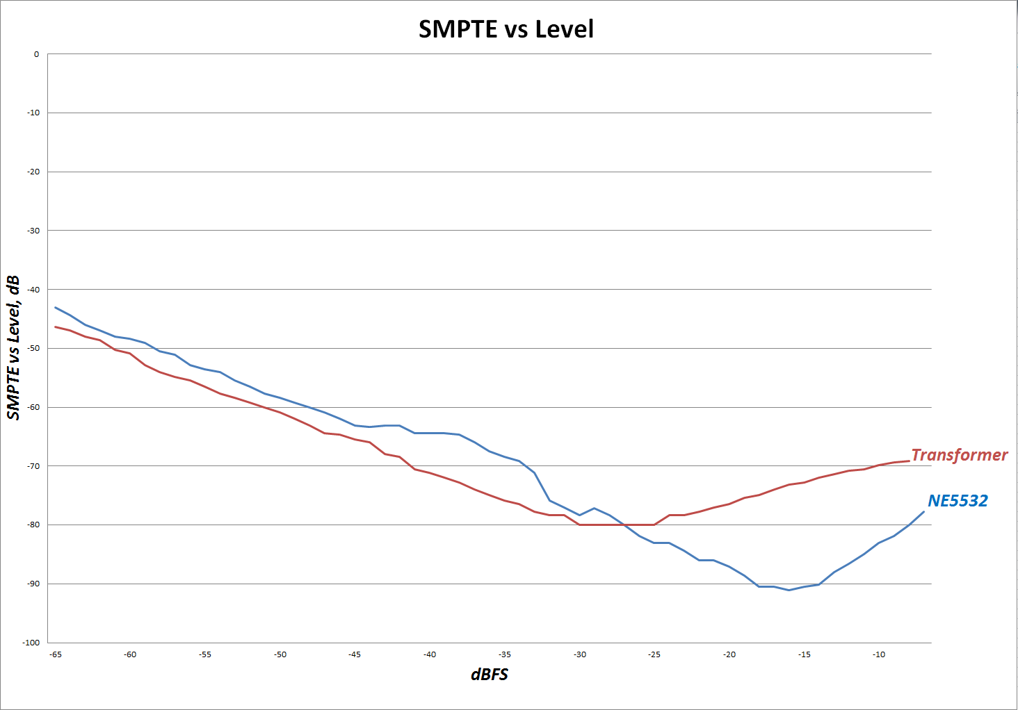

hi, there,
on #1 this thread you have es9038q2m out put from your transformers, can you pls do a ' imd vs level ' measurement on that setup.
thanks
Done. I have generated 60 SMPTE files in REW from 0 down to -60dB. After that I played them one by one in foobar player (wasapi) and have fixed every Imd value shown in Spectralab with fixing it in the Excel table. This was done for transformer output and for stock NE5532 OpaAmp output on the SMPCB ES9038Q2M board (SMPte on SMPcb - funny by ear 🙂 )
So, here are the measurements:
I do not sure that imd measurement in spectralab takes in to account the second signal (7kHz) during measurement...
No, not that ... I'm pretty sure SpectraLab does not take into account the second 7kHz signal when measuring the intermodulation distortion coefficient. That is, this is hardly the correct data. Is there somewhere IMDvsLEVEL measurement specifically for this Chinese SMPCB? Well ... To understand, does my curve for 5532 looks like it should look?
