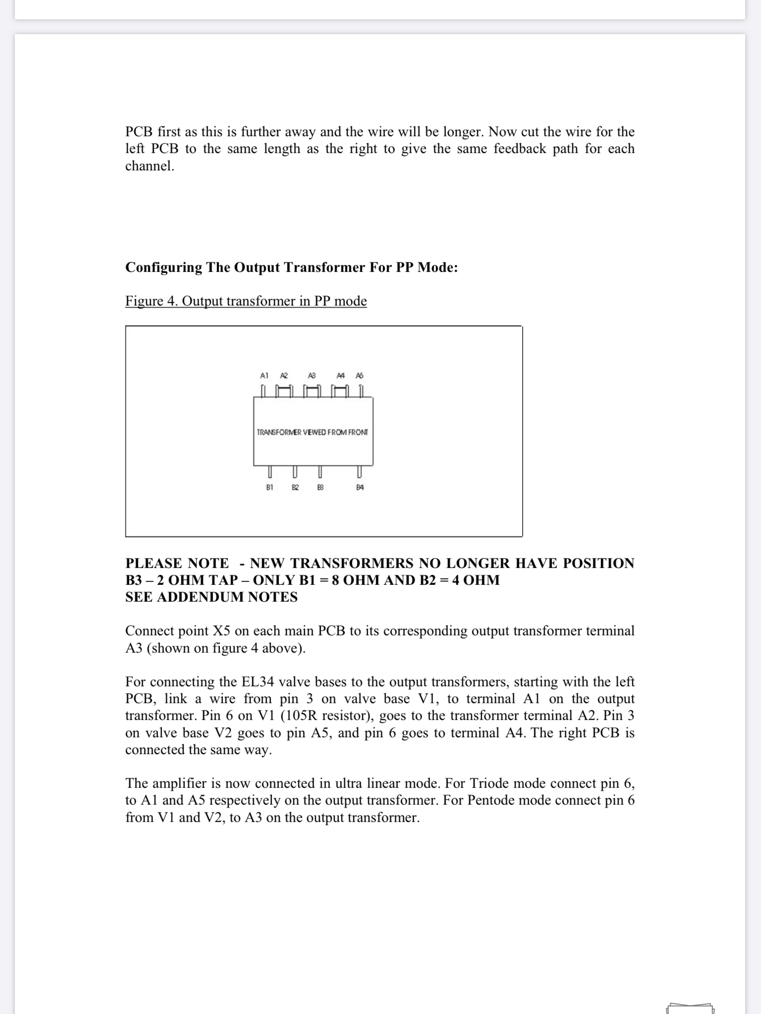

I have aquired an built edison 60 amp from audion wich is in need of a restauration.
I have downloaded the instruction manual. I have already seen that the uotput transformers are the older ones wich have the 2 ohm tap.
Here is my question. The manual is not entirely conclusive regarding the secondary taps. B1 to B4.
First they tell that B1 is the 0 tap with the ground connection and that B3 isthe 4 ohm tap and B4 the 8 ohm tap.
Further on in the manual they state that B1 is the 8 ohm tap and B2 is the four ohm tap. B3 the 2ohm tap will no longer be present in future teansformers.
This sounds like a mixed up connection. But what are the real connections? Is B1 the 0 tap or is B4 the 0 tap.
Hopefully somebody has the answer.
I have added the specific parts of the instruction manual.
Regards edwin

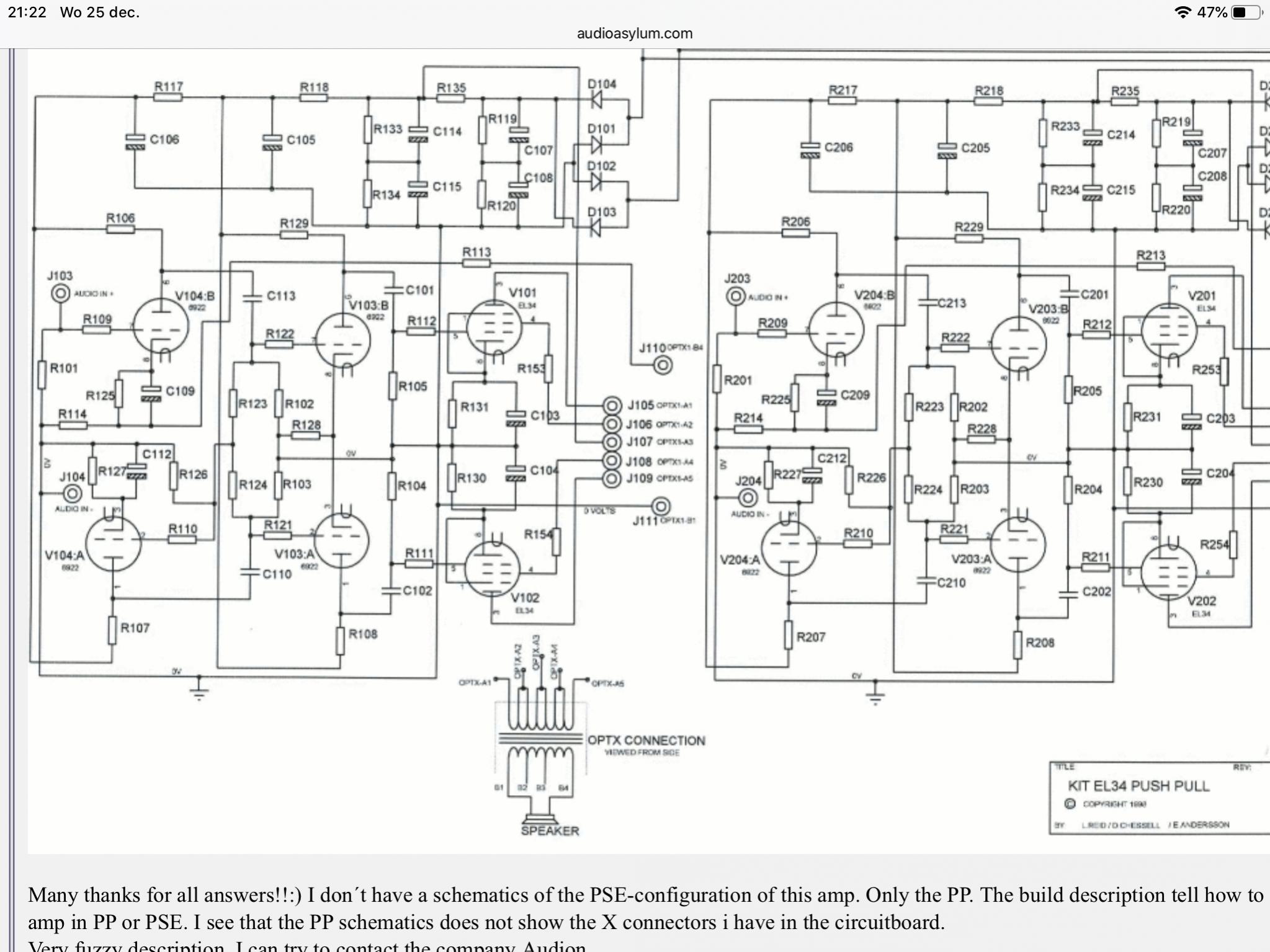

From your schematic, this amp doesn't have grounded speaker terminal nor global negative feedback. So you can connect B0 or B4 tap as speaker negative or 8 ohms positive. The out put phase will differ in both case.
If your PSE mean parallel the two channels into one with 2X power, yes you can do that. You can also bridge the two channel with this amp (no chassis ground on speaker terminal).

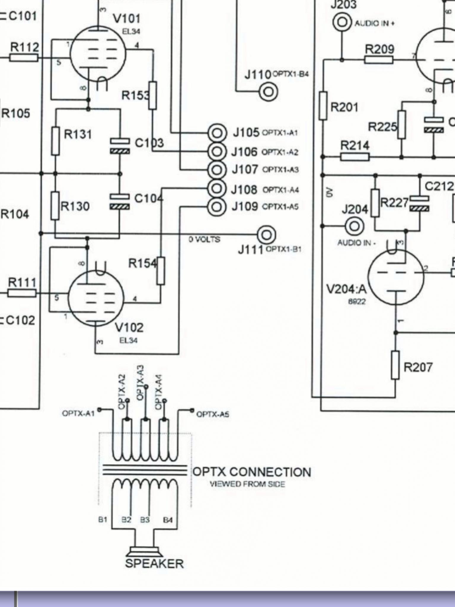

From your schematic, this amp doesn't have grounded speaker terminal nor global negative feedback. So you can connect B0 or B4 tap as speaker negative or 8 ohms positive. The out put phase will differ in both cases
Look again J110 which connects to B4 is feedback, J111 which connects to B1 is ground.

If you check audion.co.uk. Then you can see,and find the edison 60 ampkit. You can also find the complete instruction manual. If you read well, then you can see wich i already stated in the first post. That first they talk about B1 as the zeroohm tap and later they say that B4 is the zero ohm tap.
The zero ohm tap is grounded. So you have to take into account wich side is the zeroohm tap.
I think the schematic is not entirely right. In the schematic you see B4 on the side of A1 and B1 on the side of A5. But you can also see a picture of the output trannie, and in this picture you see B4 on 5he side of A5 and B1 on the side of A1
This is the connection wich i am going for.

From your schematic, this amp doesn't have grounded speaker terminal nor global negative feedback..
Not true, both on the schematic and in the the kit's manual it is actually required to connect the output B1 to the ground (please double check the schematic)...
See page 6:
http://www.audion.co.uk/Kits/Edison%2060%20Manual%20ver1.pdf
