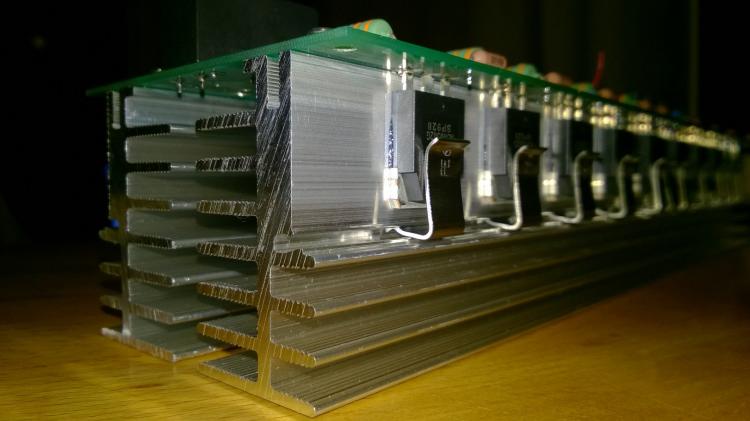

the pros:
- no insulator means better cooling. You can allow higher heatsink temperature, which means smaller heatsink. Mica washer can have 0.5K/W, which means 25degree higher juction temperature with 50W dissipation. You can save this 25degree
- using the heatsink as power supply rail means lower impedance on the rail, comparing to the PCB. And better safety in case of failure, because the copper from the pcb will no vaporize
Cons:
- complicated mechanical works, because of the isolation of the heatsink
- dangerous voltage inside the amp, which easily kill you, if You not careful enough

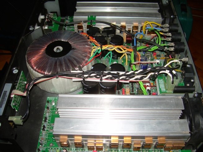

The amplifier on the attaached picture running +/-55/110V class H with live heatsink.

Conventional (common collector) amplifier means, that the rails are running on the heatsink.
QSC solution with the grounded heatsink looks very elegant, but sometime I feel, that they sacrifice too much from the sound quality to be able to do it.
Crest use live heatsink in the ProX200 series, but it's connected to the output, which is another possibility using common emitter output stage.

- output stage for direct contact with the heatsink without mica/silicon washer
