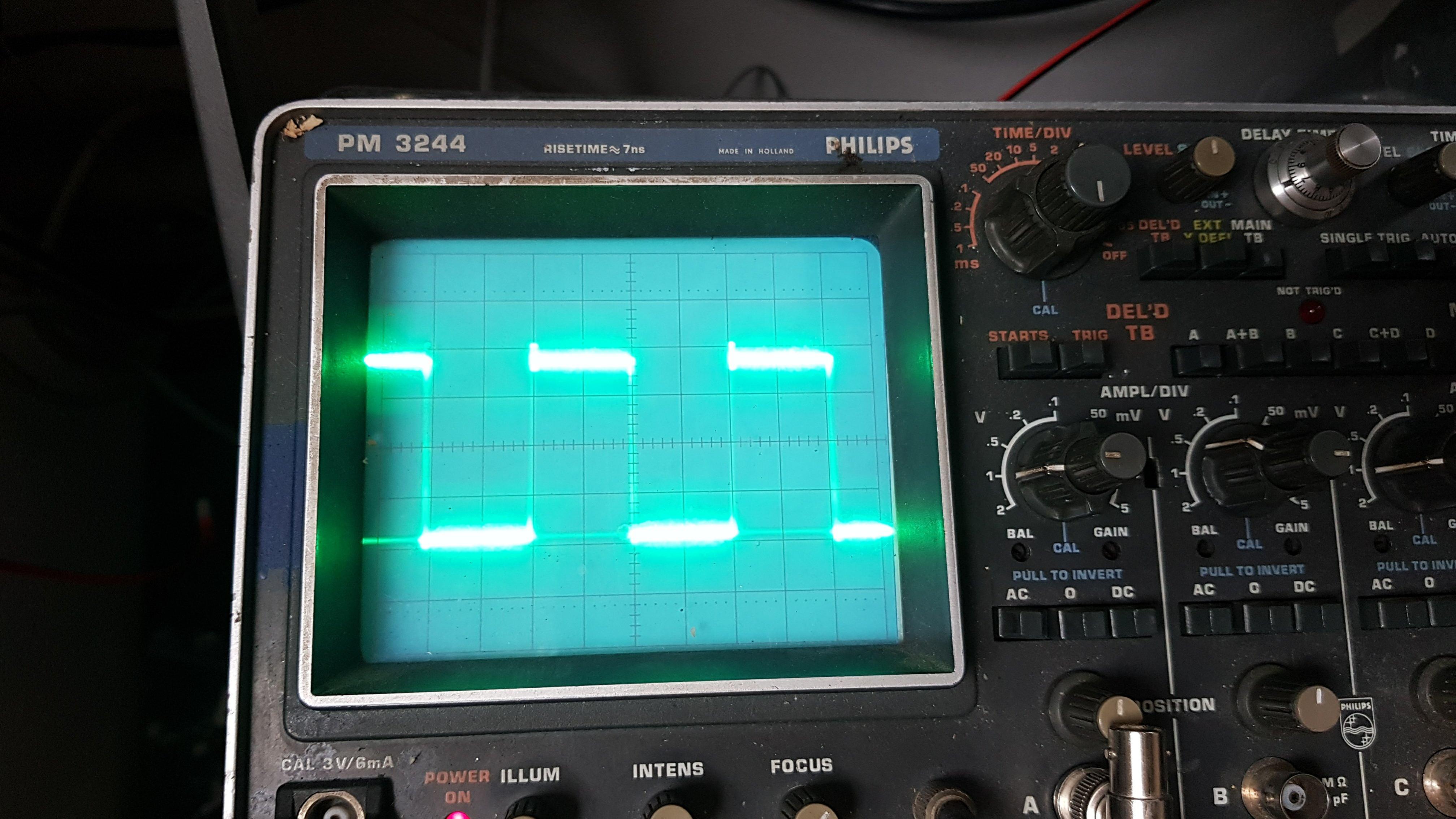

Original fets were FQP34N20
- 200V
- 31A
- 2370 input capacitance
- 75milliOhm RDS
I replaced them with IRFB31N20D.
- 200V
- 31A
- 2400 input capacitance
- 82milliOhm RDS
Gate resistors are 47ohm.
Attached is a photo of the switching wave of the output fets. There are 2 banks with 4 mosfets in each bank.
Right now I put one mosfet in each bank to test.
The fets heat up a little bit. The switching of the fets looks good? Or do I miss something here 😀

For me is ok, but, try connecting a 1uf 250V film cap between negative and positive rails as close as possible to the mosfets.
You should sort the little spike.

Is it a problem/normal for output fets to run a little bit hot on idle?
Especially when putting only one fet per bank?

Not supposed to get warm? Are you testing with no load?
Is this a switching amplifier (class-D)? Or is that wave form a square wave output? Voltage rails? What is switching frequency?
You will have switching losses, which is heat, but the driver should also get a little warm...

Post a photo of the amp board.
The outputs in some class D amps run hot, likely due to too little deadtime.

Amp runs fine. Installing all the output fets made the little spike dissapear.
Fets run cool and happy.
