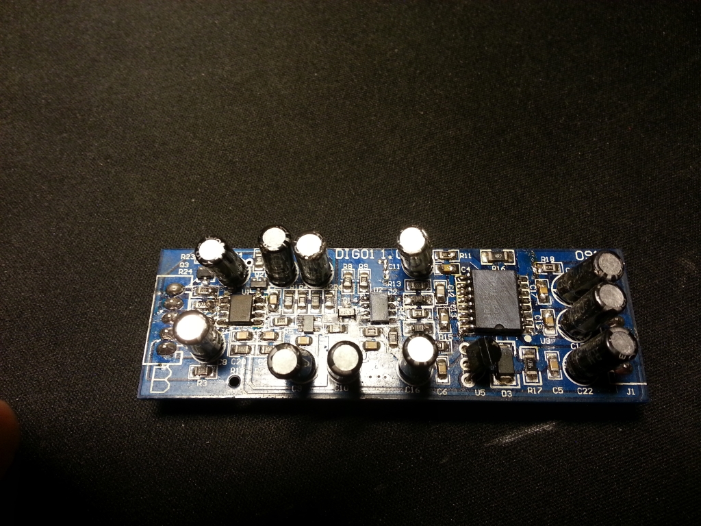

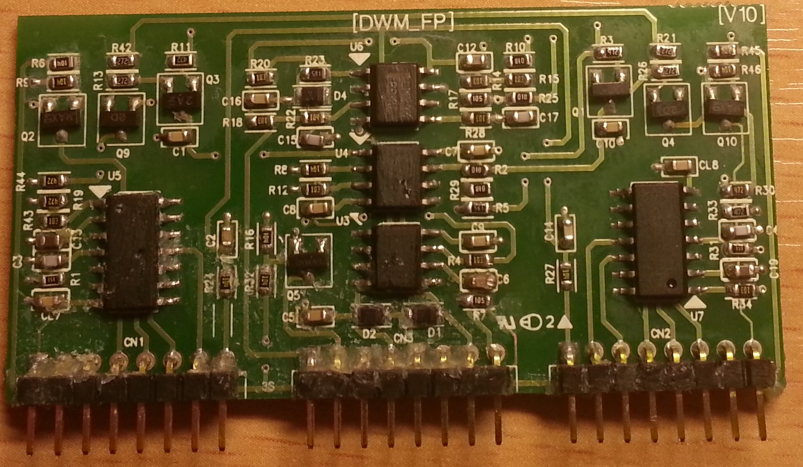

Does anyone know what IC is U2? Its scraped off, i tried to add thermal paste to see marking, but i only can see last numbers 041, not sure about 0, but end of it is 41 for sure. U1 is TL081C, U3 is IR2010. Used in output stage, there are two of them, high/low side. Marking is DIG01. 01.
Compare to the circuit on PDF page 28 of the following file.
http://www.bcae1.com/temp/infinity - REF1600A.pdf
Those are essentially right but the 311 could be a 211 (no real difference). The IR21844 is the DIP version. The IR21844S and the IRS21844S are the surface mount versions. This is only for clarification for others who will find this page.
