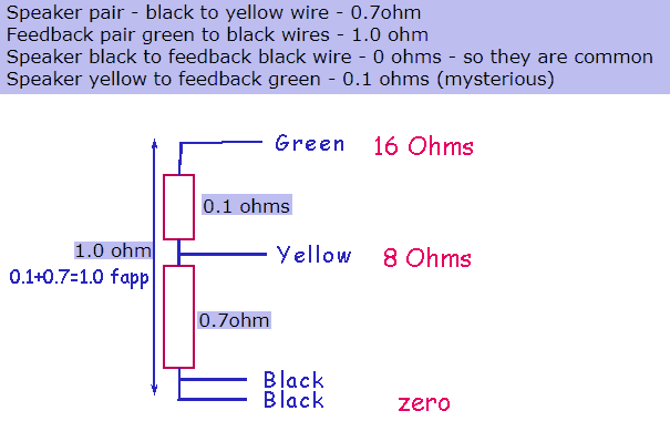

On stock (as I bought it 20 years ago)There are 4 output wires. One pair to speaker (yellow and black), other pair to feedback and ground (green and black)
Speaker pair - black to yellow wire - 0.7ohm
Feedback pair green to black wires - 1.0 ohm
Speaker black to feedback black wire - 0 ohms - so they are common
Speaker yellow to feedback green - 0.1 ohms (mysterious)

If we assume the secondary is 0/8/16 then your ohm-meter readings make perfect sense (within the sub-Ohm accuracy of most meters).

Thanks, folks. Yes, the NFB seems very forgiving.( Piazza got it right - same as what's pasted on the amp.) The previous owner put in a pot to vary over the 5k-10k feedback resistor range shown on the schematic. Can hear volume increase somewhat but the character of the tone at full volume remains pretty fat and rich. Vibrato as nice as my '59 Tremolux. Haven't looked on scope yet to see what's going on.
