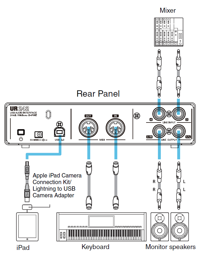

I’m just wondering if it’s possible to find an external “unit” or “device“ for use as oscilloscope and possible spectrum analyzer for audio equipment (up to 100 Khz. would be sufficient) using an iPAD or even an iPhone as display/processor. I know there are lots of apps using the iPad’s microphone for this, but that is not what I’m looking form. I want a direct electric measurement from a circuit, perhaps even with 2 channels instead of one.
Did anyone make it this way? Can we buy it? Where?
Any sugestions will be highly appreciated!
Regards, Gerrit

Any compatible soundcard with the Apple Lightning to USB 3 Camera Adapter should serve as an interface.
Well, what is "any compatible soundcard". Compatible with what? iPad? I have a Steinberg UR242, but will it work? My iPad has no Lightning interface, it has USB C. So how should I make a physical connection?
This may be too complicated to be reliable and accurate. I need something that will work directly, every time when I need it, without having frustrating configuration problems.
I this a true serious option?
Regards, Gerrit

Regarding your Steinberg UR242 see the manual on page22...
With Apple USB-C to USB Adapter it should work - UR242 is iOS supported.
