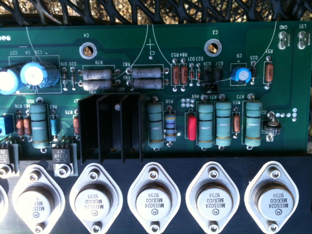

Ok - The unit has 5 ea MJ15024 (TO220) lined up on the left end of the sink and 5 ea MJ15025 on the right side. the leads extend thru the sink (1/4"thk) and on to the PCB. In the middle of the sink are three smaller transistors, a C168 on left, C158 middle and A958 on right. There are 2 small heat sink, 2"x2"x2', on left sitting on flatback transistors on the PCB. Also are 2 pair of transistors (T05) size. Electrolytics on the PCB are rated 100V. I have a photo of the unit, bu can't insert it. if i can find your email address, i'll send. Evidently, the PS capacitors were bolted in to the PCB, 4 each total , probably 3" in dia. The left end of the board has two plug on terminals labled LS1 and gnd , same on the other end. There is a 3 pin female connector on the component side of the board, and 2 on the back side, one 3 pin, one 4 pin.

This sounds fairly powerful. MJ15024 and 25 were TO3 steel case parts, according to recent datasheets. I thought Motorola TO247 (plastic, bigger than TO220) parts were prefixed MJL and MJW. Anyway, if the parts aren't counterfeit, you should be able to use +-75 to +-85v rails. If you are going to use that much, your speakers should be capable of half the rail voltage.
For 300 watts at 4 ohms you would need 8.7 amps at 34.7 volts. That would mean a power transformer of +-70 v rails. If your speakers are not that power capable, you can use lower power supply voltages.
The 2SA968 was in the Peavey PV-1.3k I just repaired, so the design time of this amp was about 1994.
For that much current you probably need at least 4700 uf @ 80v capacitors. The PV-1.3k has 10000 uf capacitors. I just bought some nice US assembled Panasonic 4700 uf 80 v ones from Newark.com rated 3000 hours life @ 85 deg c, ECO-S2AP472DA. You'll have to build a little board to strain releive the wires you solder to the snap in cap terminals. I use 1/16" or 1/8" thick LE laminate from mcmaster.com, which I can saw up with a sabre saw and drill with ordinary HS steel bits.
Whether your power transformer needs single 17 a winding or dual 8.6 a windings depends on whether this is a flying rail amp like the Peavey designs, or emitters and emitter resistors are connected to the speaker hot like more conventional designs. The conventional designs can use a single winding transformer.

my intent when i bought the two amps was to use them with subwoofers for the 32' stops on my organ. In a room environment, I doubt that i would need 300 watts, however, I read data on a pcb that adjusted output watts to provide a flat response at lower frequencies. probably not doing justice to the PCB, bu anyway.
What puzzles me is why 4 large caps. i can see two, one on the + supply supply and one on the - supply. looking closely at the traces, the two middle caps are connect together, outter to connected together.
If the caps are connected + to -, they could have saved money by buying lower voltage caps and stacked them to make the voltage rating. However if the speaker minus are connected to the middle point, then that is the middle of the voltage stack.
those transistors are TO3 package or metric variant, those output transistors could be genuine MJ15024-25.
If you want to save electricity dissipation in the heat sink, you could use a more conventional +-50 or 55 v supply.
Does the power feed connect to the tie point of the capacitors? Is the power feed 3 wires, (+,signal ground, -) or is the power feed two wires (+,-)? Some old designs use a single voltage supply, but that was rare by the days of the 2SA968. What value are the on-board capacitors? Some amps need a second pair of capacitors for the lower voltage for the input transistors.
If the heat sink under those transistors is 1" thick, it is just barely adequate for a 400 w amp with a big fan, IMHO. At +-50 volts or so you can use less fan for less no-sound noise.

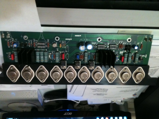

new data,
I found writing on the PCB which says; Acoustic Research, P/N 18110550, Rev.B
Also found printed text; NC-1, 5192, 94V-0
The two transistor pairs are A1370 and C3467
There is one round silver IC can asymbol square with a filled in right arrow in it, AD, 711BH, 9229 delta symbol
The 2sa1370 and 2sa3467 transistors are internal to the amp, they won't determine the power rating. Same with the Analog devices part, probably on op amp. You would only have to look those up on datasheetcatalog.com to repair the amp.
If the printed text 94 and 0 are next to the input power supply pins, then that is your supply voltage. If not, I don't know. You can get 94 and 0 out of a +-45 or +-50 v transformer, the higher voltage gives higher current flow on 94 v. You have to tie not use the center tap and bridge rectify the two ends of the transformer secondary into the main storage capacitors. Requires a higher main capacitor voltage than 80 v, however.

The two holes where the capacitor would fit show marks of a screw terminal. the other two are clean. The small electrolytics on the board are all rated 100v.
1994 also appears with the p/n .
Since the board is not well annotated, the LS1 lugs must be the speaker connection points. There are 2 sets, one on each end of the board, and they are connected together.
since there are 3 connectors, it is hard to say which is for inputs.
I suggest if google cannot find a schematic diagram for you, that you draw one. Google found the schematic for one of my amps here, the other on eserviceinfo.com. If your amp is part of a receiver or a powered speaker, you have to download the whole thing and just look at the pages for the power amp.
You really need to know how the speaker and power supplies are connected to buy a power transformer and main caps. If the speaker hot is connected to the emitters of the output transistors through a small coil, and the speaker negative to the middle of the two power capacitors, then it is a conventional post 1975 split supply amp. If the speaker negative is connected to the most minus power supply, and the the speaker hot goes through the coil to a big capacitor before going to the OT emitters, it is a single supply amp.
The input hot will be connected through a 2.2 to 10 uf cap to the base of a small transistor. The speaker hot is usually connected through a high value resistor to the base of another small transistor near the first one. (feedback).
Screw terminal capacitors are very expensive. I use radial lead snap in caps in the large sizes. You have to drill a board for a strain relief on the wires, because they don't grip the snap in terminals naturally. The snap in terminals go through the board, too. I mount radial lead caps to the metal case using glue- silicon caulk from Family Dollar store is what I am using now, although it is a pretty good copy of GE white kitchen silicon seal. The kind of silicon seal rated for 400 deg F, which is 100% rubber and no filler. Wall board adhesive also works, although you have to drive to the home store to buy it and a partial tube hardens faster than silicon caulk. Silicon, you can dig a hard plug out of the applicator with a small screwdriver.
Your output transistors are showing a date in the fall of 1992 - 9234.
