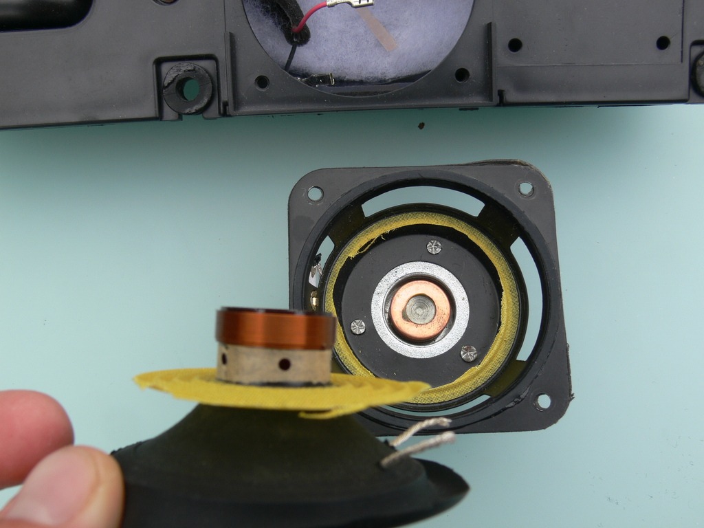

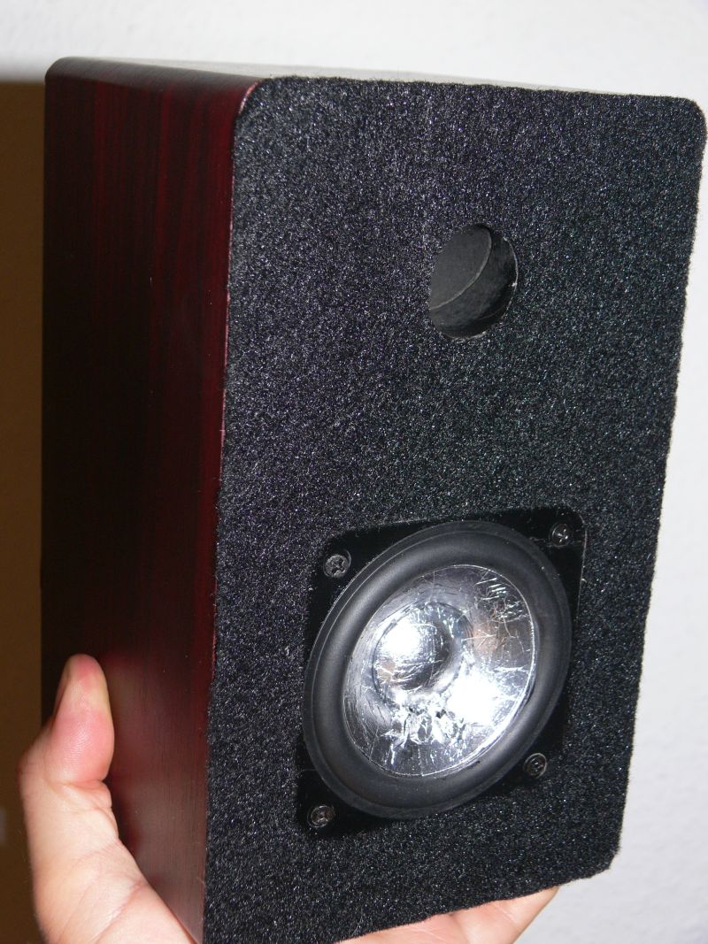

in my eyes a 8cm driver can be perfect if placed close to two boundaries like back wall and table or corner in the room. Then the voices have enough body.
