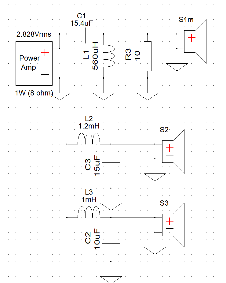

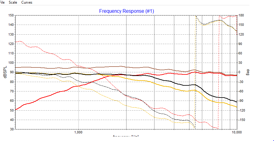

I got my speakers built today. I just need to figure out the crossovers. I'm attempting a 2.5 way (as I understand it) since it is a MTM. I'm still not 100% on any of it really but what phase should look like on a graph is what I'm least sure of. Phase is represented by the thin line. I'm confident that its not perfect but it's not bad either
