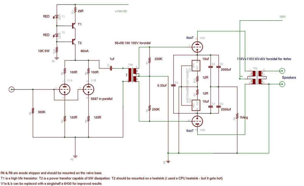

Heres the thread discussing the headphone amp;
http://www.diyaudio.com/forums/showthread.php?s=&threadid=108745&highlight=
I will post the DC7 schematic when I get home (not presentable enough for a sexy picture).
Shoog
Shoog

Yes the transformers are in the case. I think their about 30VA.
Heres the DC7. Since this schematic the parafeed cap is now 4uf and the interstage has been converted to a center tap choke - this brought a significant improvement to the top end.
Shoog
Shoog
