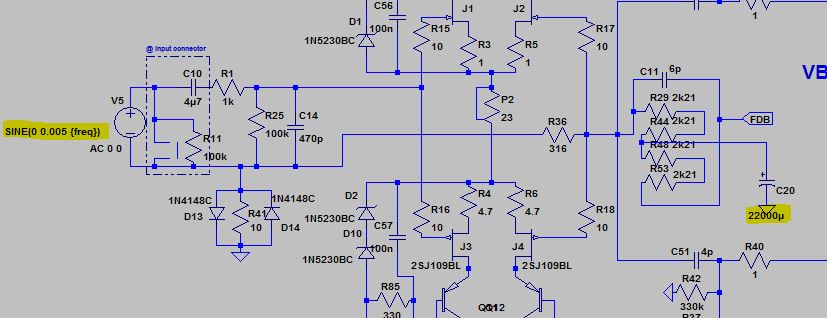

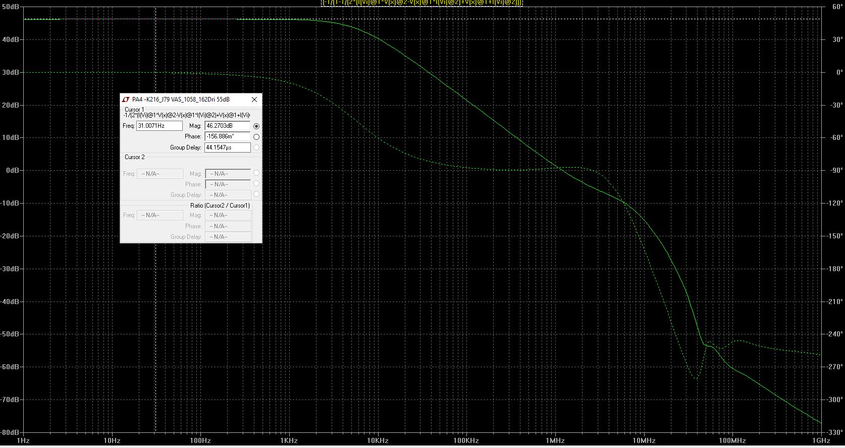

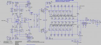

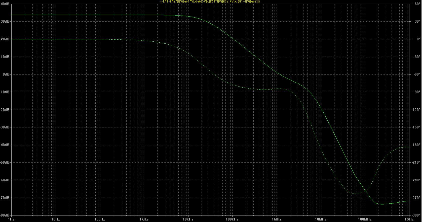

Hi John and Fotios,
I'm have some difficulties trying to understand the difference I have between OLG results when
1/ simulating OLG using Tian probe and using and
2/ simulating the practical options to measure OLG ==> split feedback resistor and big capacitor to ground.
Picture 1: bode plot with OLG using Tian probe

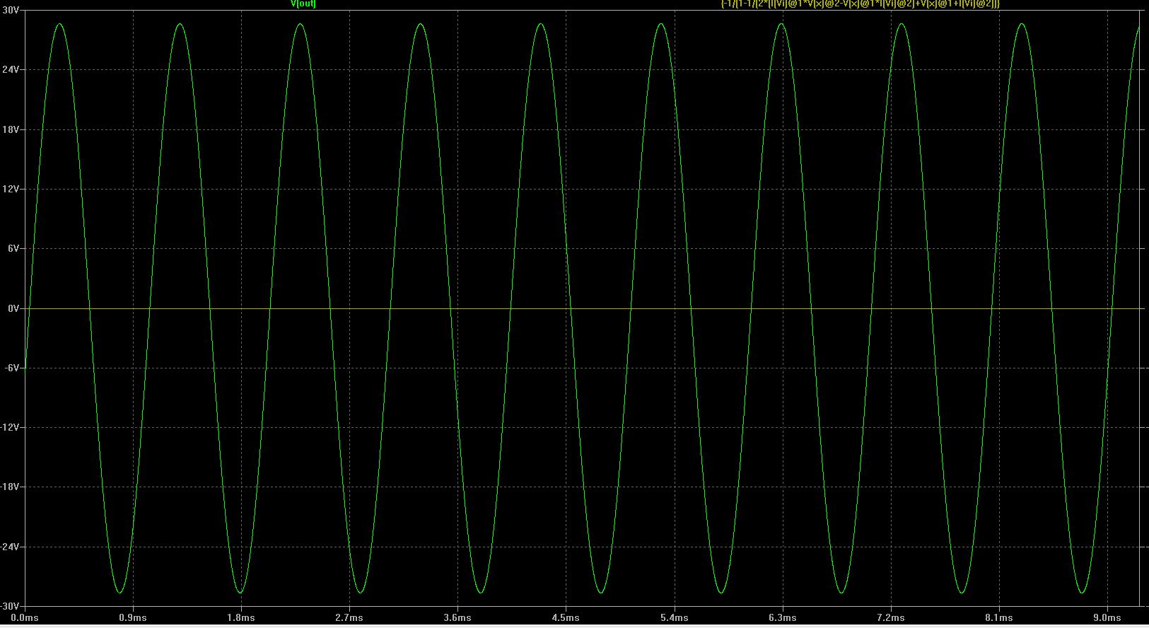

Picture 2: implemented split feedback resistor and cap to ground and input signal of 1kHz 5mv peak
Picture 3: Output signal using the split feedback resistor
Result in OLG with split feedback resistor = gain (28.65/0.005) = x5730 = 75dB. Using tian probe gives 46dB.
?? now that I'm writing this is see a difference of 29dB which is equal to the CLG?!
Can it be that the Tian probe does not gives me the OLG?
BTW: calculating the gain using the output signal and error signal in the input stage gives exactly the same as the split feedback resistor measurement.

Open Loop Gain (as measured by the split feedback resistor) is not the same with the Loop Gain (as measured by the Tian probe method).
LG=1+OLG*T
where LG is the loop Gain, OLG is the Open Loop Gain and T is the feedback factor. These quantities are frequency dependent (or complex, if you prefer), so it is not straightforward to relate them.
In your case, at low frequencies, T could be approximated as R36/(R29+R44+R48+R53) or about -29dB. It follows that your Loop Gain~75dB-29dB=46dB which is exactly what the Tian method gives for the Loop Gain. Both your measured and calculated results seem correct, however you need the frequency dependency of the Loop Gain to estimate the stability which, as I already mentioned, is far from trivial. For large Open Loop Gains, extracting the Loop Gain this way is doomed to fail.

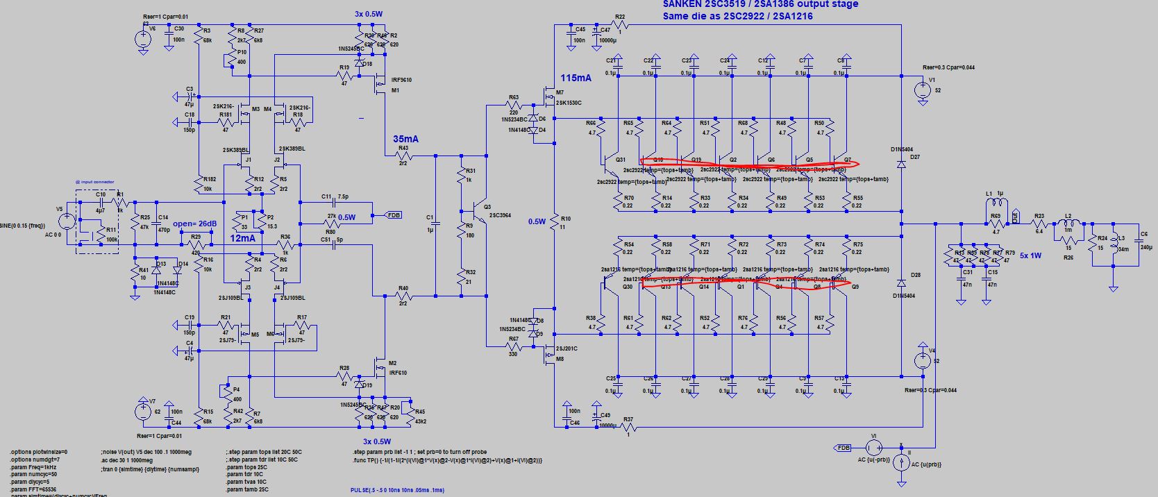

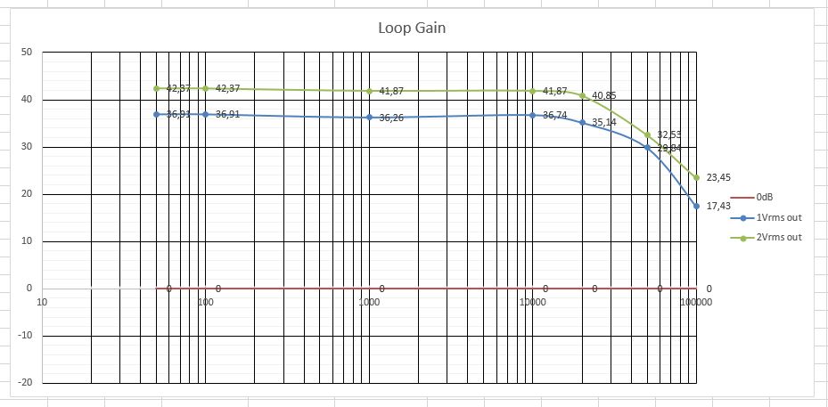

I've tried to make some Loop gain measurements from the circuit below.
What have I done:
1. freq generator at input with LP + HP input filter connected
2. Set the output voltage at different rms voltages: 1V and 2V
3. Measured the voltages over de + and - input of the diff stage. This has
been done with a fluke 8808A in relative measurement modus.
Results are as per graph below and seems not right
1. Loopgain at 2Vrms out is higher than 1Vrms out? Loopgain is not output
voltage dependant if I'm not mistaking?
2. Graph is not what I expected. Don't know how accurate spice is for gain
measurements, but I have about 20dB difference between spice and
measurements. Remarkt the dB's in the graph are the measured ones,
minus the 29dB feedback.
Any ideas or advise what I'm doing wrong?

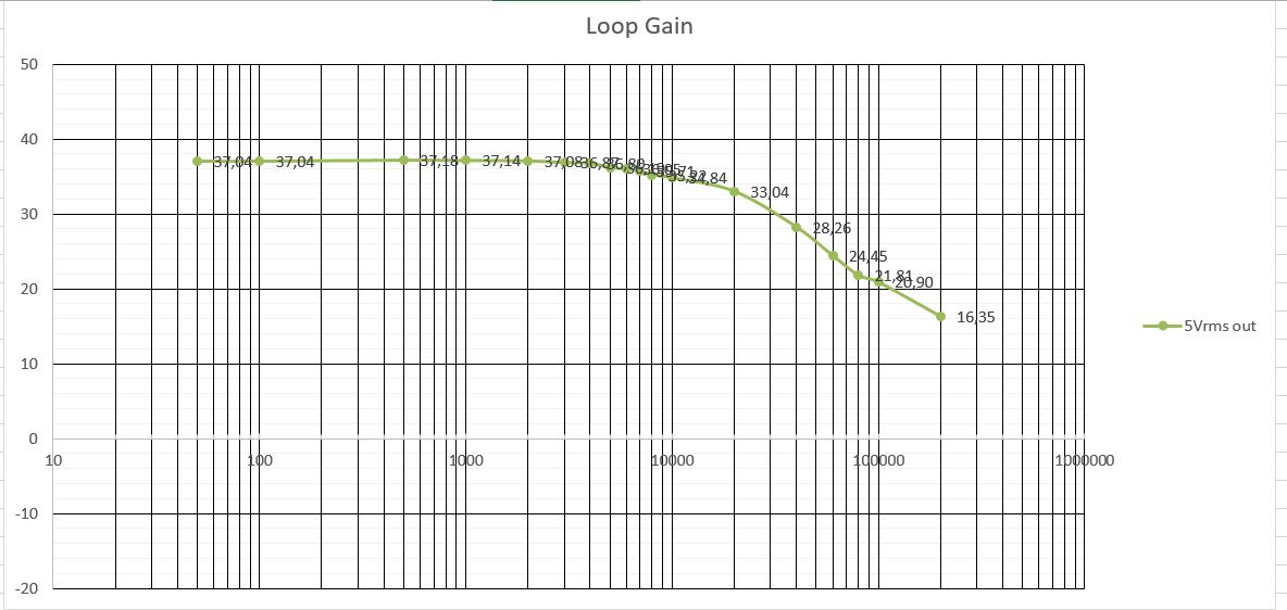

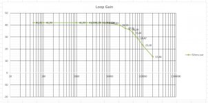

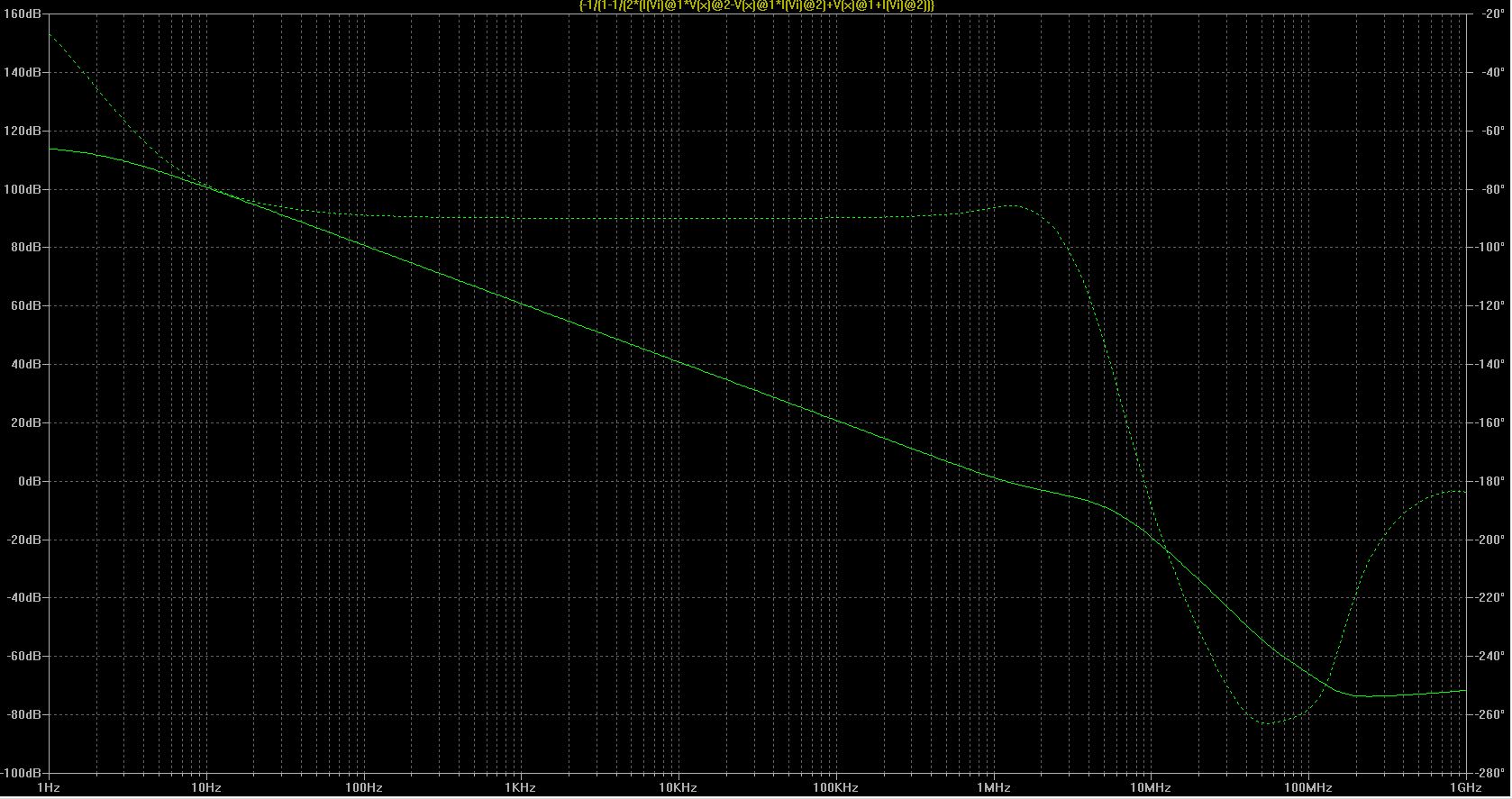

I've done a new loop gain measurement.
Values are consistent with previous measurement.
Output rms voltage is 5V.
Measured up to a frequency of 200KHz.
Notice that gain is dropping with more than 20dB/decade.
Could it be that the input impedance of the fluke 8808A can have an impact on OLG? Input impedance is 1M shunted with 100pF, according spice, this should have as good as no impact.
Why is it that measured LG is that low compared with spice? 40dB VS 60dB at 1Khz?
Shematic: https://www.diyaudio.com/forums/sol...in-measurement-fotios-help-3.html#post5542972
Your input measurement may be noise-limited. Trying to measure loop gain directly is tricky business.
I suggest you configure the amp for very high AC gain (unity at DC) - maybe something like 100 kOhm / 1 ohm + 10000µF-ish electrolytic (the cap probably best being paralleled by another 1000µ plus 100µ). Then calculate back to remove any remaining deviation - solve the OLG --> CLG formula for OLG. (To eliminate the effect of the capacitor, replace R_g by R_g + Z_cap for a frequency-variable noise gain term.)
A variable 0/20/40/60 dB attenuator on the input side is likely to prove handy. Also make sure you use an FFT or other way of filtering out just the desired frequency so you don't get in trouble with noise again.
One point to bear in mind is that if you use large capacitors to decouple the NFB to measure OLG, the frequency response may be limited if the capacitor is not large enough - it has to be comparable to the grounding resistor impedance divided by the (expected) OLG -in other words very large. If this is what you are using, try simulating the OLG using AC simulation and see whether it reaches a plateau somewhere around 100Hz-1kHz: if not, it probably is not large enough decoupling.
For real OLG measurements you will need significant attenuation of the input - I use typically 1 or 10 ohms fed through 10k (10000:1 or 1000:1) reduction.
If the purpose of your LG measurements is to determine the phase margin you will need to measure the performance up to the unity loop gain frequency as Wally pointed out, which is much more difficult without the right kit. Analog Devices show how to use a transformer to inject a signal into the feedback path. You may be able to get an idea of the phase from an oscilloscope if you can compare the injected signal phase with the output.
My main concern with a Class AB output stage is that simulation using AC only works for the DC conditions calculated, not over the full range of operating currents/voltages that the amplifier could see in the AB stages, so even simulation with AC signals might not reveal instabilities.
My goal of these measurements is finding out where approx the -3dB point is, also known as open loop bandwitdh. For determening phase margin, this is out of my league due to limited tools.

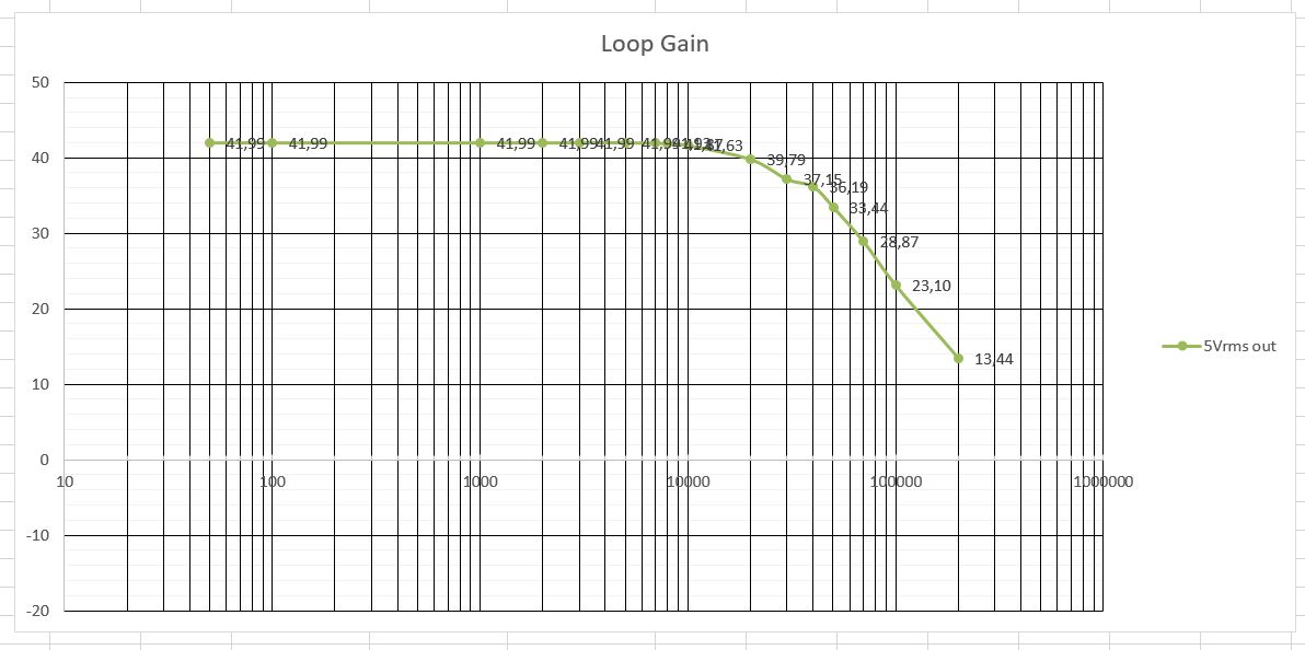

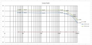

In the mean time, I have performed loop gain measurements according you suggested method: https://www.diyaudio.com/forums/sol...gain-measurement-fotios-help.html#post1476652
Result, compared to simulated loop gain: above 20kHz as good as same. :)
At lower frequencies the difference/error is the biggest.
When using local feedback around the VAS (100K from Drain to Gate) to lower the open loop gain, I can simulate approx the same as measured value.
Again I have tested with different output voltages and again quite some difference in loop gain.
- 2.5Vrms out @1KHz => 34dB Loop gain
- 12.5Vrms out @ 1 KHz ==> 40dB Loop gain
Are there "standard" values for some parameters which need to be fixed to standardize Loop Gain measurements?
Next method will be the split feedback resistor method. Where a big cap, 22000µF is connected to ground. And attenuate the input voltage by a factor of Thousand.
sgrossklass, could be right, my measurements could be noise limited. However, it seems that with lower frequencies the error is the biggest, this seems not logical, not?
With the methods used sofar, the smallest measured value was approx 1mV.

The split feedback resistor should work. To measure OL BW you should see a flat plateau between the HF roll-off and LF roll-off (but this should not occur as you have no coupling/decoupling capacitors so the plateau should be flat to DC).
I suspect you should be able to measure the -3dB point but the voltage dependency suggests maybe some sort of biasing problem in the OP stage. Have you checked the quiescent current in the OP devices - the cct suggests you have adjusted the bias resistors- have you optimised this in your actual circuit?
