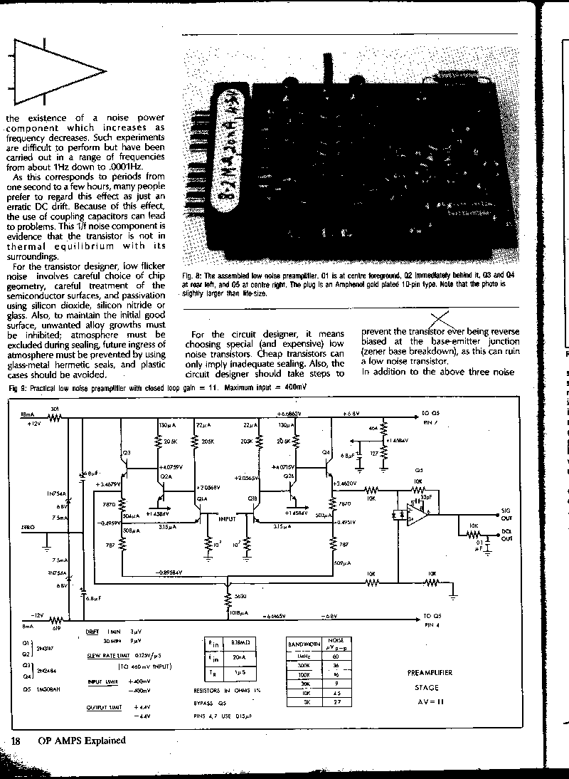

I have got an old article about noise in high gain devices. The article says that by nature opamps are noisier than low gain amps. Is this really true or was it true when the article was written?
