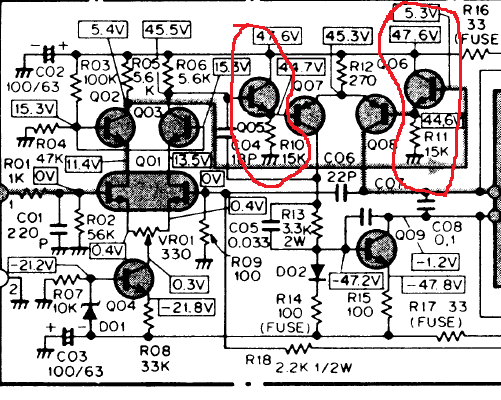

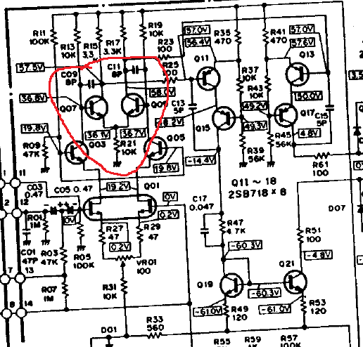

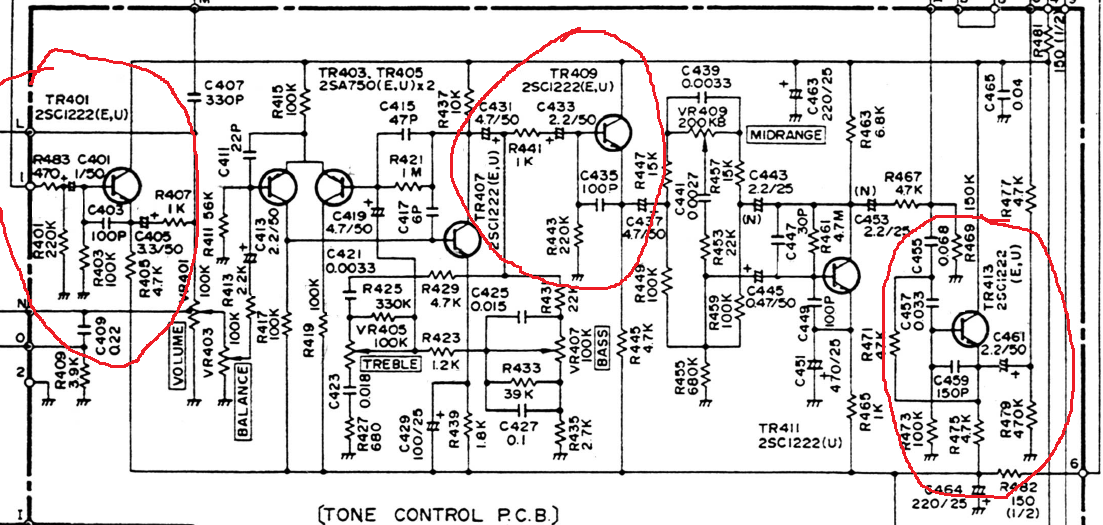

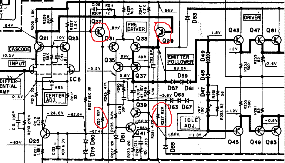

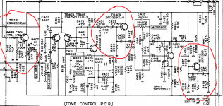

All these are very high quality audio components...The last one is a full discrete 3 band eq.I have it in realistic STA2250 and there's no audible noise with it.
The second picture is Fisher BA-6000 and it's using a "unity gain" common emitter .Take notes on the compensation needed for higher linearity.
None of these are standalone emitter followers though, #2 even is another LTP.
I think I saw one in some '70s Braun amp, will have to look when I'm back home. Mid-late '70s is probably the best period to find some. And you'd definitely be looking at the preamp section, not the power amp. With +/-24 V supplies as not uncommon then, even a plain follower with just a resistor can be quite linear. Using high supplies was a common trick in the days when transistors still were expensive.
