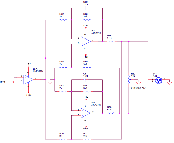

Another option is to use the circuit I used in my preamp (below).
To adjust the symmetry, drive the input of the circuit with a function generator, connect the (+) output (pin 2 of the XLR) to channel 1 of an oscilloscope, and connect the (-) output (pin 3 of the XLR) to channel 2 of the scope. On the o'scope select INVERT on channel 2 and perform CH1+CH2 (most scopes - even ancient ones - are able to do this). Adjust the SYMMETRY ADJ for minimum waveform amplitude on the o'scope.
The first two op-amps form a differential in to differential out circuit. By grounding one input, you'd get a differential voltage out that is proportional to the input voltage.
