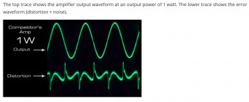

You need a distortion analyzer that outputs the residual (the output with the fundamental filtered completely out). Yes, its routinely visualized when using such testgear as the nature of the residual says a lot about the distortion mechanism(s) responsible.
Thank you, Mark. I found two DA screenshots of a power amplifier output. The crossover had to be blown up 60db to see it clearly . In order to see a modern opamp crossover, would the equipment need to be high end, or would the information the analyzer provides need to be interpreted?

There are two basic approaches to coaxing an amplifier into showing easily visible amounts of distortion:
1. Demand insanely high noise gain from the circuit to the point where feedback is much reduced and ultimately it essentially runs open loop. If needed, annoy the output stage with low-impedance loading on top of that. Samuel Groner's opamp measurements are a typical example (60 dB noise gain, separate 600 ohm load test), and even the datasheet specs of modern opamps are often obtained by extrapolating like that. The advantage to this approach is that, well, basically anyone can do it, even without necessarily having to use particularly high-end equipment. The downside is that these are not exactly realistic operating conditions.
2. Use a distortion magnifier circuit of some sort to cancel out the stimulus signal. Published examples exist since about the early '80s, they have also been discussed elsewhere on this very forum. If the signal generator used is extremely clean, a pure notch filter for the fundamental may do. This allows researching amplifier performance in its natural habitat, if at the cost of dedicated circuitry being required (and a an increased risk of contracting ground loops).
I suggest researching both.
Wrap-up: modern opamps are so good, you need to go through extraordinary measures to make the distortion stand out.
Seeing it on a scope? Forget it.

Of course a spectrum analyzer is another matter - that's why spectrum analysis is routinely used to assess audio circuits now that cheap quality ADCs with high dynamic range are available.
Here is an opamp (LM358) connected as an inverting amplifier with gain of -1.00. The input signal in yellow is a 5 kHz sine wave. The output signal is in blue, with crossover distortion clearly visible.
Studying the LM358 circuit schematic, you can see there is a "deadband" in the output stage which is (3 x VBE) wide, leading to relatively severe crossover distortion.
