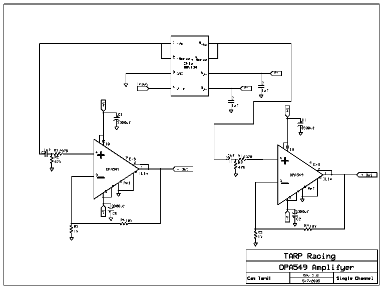

I'm just learning about making amplifyers. Here is what I have come up with using information from the datasheets, and bigmike216. The input power will be about 18V. The of each channel will first go thru the DRV134, and also a preamp that has not been decided yet. What all changes will need to be made?
first off, the voltage will be + and - 18v, before rectification.. 😉

if you must use a decoupling capacitor, use it before the DRV because any difference in capacitance will result in different low frequency response on the 2 sides of the bridge. then you will get asymetric output at those frequencies affected
Why would the capacitance be any different? If you're referring to the tolerance of the capacitors, it will be a very minor effect on frequency response.neutron7 said:if you must use a decoupling capacitor, use it before the DRV because any difference in capacitance will result in different low frequency response on the 2 sides of the bridge. then you will get asymetric output at those frequencies affected
But there should be a capacitor, and resistor to ground, before the DRV134.

A cap and resistor has been added before the 134...thanks. Other than that, does anyone see anything else majorly wrong with it?
the capacitor and resistor need to be on the input.

bigmike216 said:the capacitor and resistor need to be on the input.

i know... they are on the input in version 1.2
Not sure about the power supply right now, still looking for a transformer.
