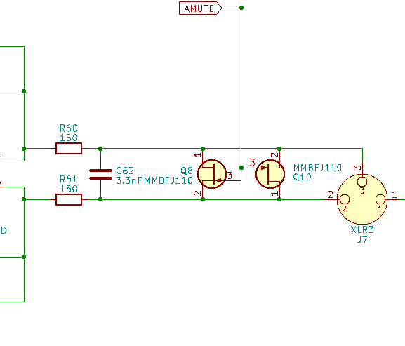

In differential applications at least I've found that series resistors and jfets across the output does a good job of muting in 1632. (The idea is not original.)
There are other jfets with lower RDS which might work better than the ones I used (which I could get at the time) J112? IIRC

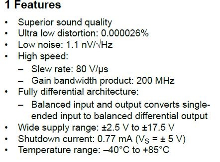

@bohrok2610 - I wasn't aware of the 1633, I will check it out!
Edit: the OPA1633 seems to be unavailable at the usual suspects ...

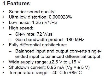

You wonder why they would bother to create a new device...maybe just increased the operating currents of the input pair a bit? Or perhaps the fakes (the OPA1632 from China) are in such mass abundance they can't sell the originals?
