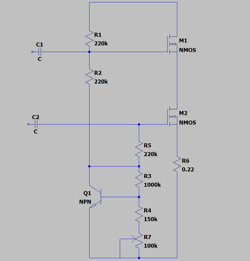

OP stage biasing
What's the simplest way to add reliable biasing to this OP stage?
(The VDC will probably be double, ~36-40V)

Lateral mosfets are of different construction than the IRF types. If it doesn’t mention anything about “lateral” on the data sheet, it isn’t.
Lateral mosfets are GSD and vertical mosfets are GDS.
The Hitachi lateral mosfet datasheet uses a 1K pot to bias the laterals.
For bipolar or vertical mosfets a Vbe multiplier is best.
Temp Co of enhancements aren't that bad actually
less than BJT.
VBE multiplier could work , numerous circuits to help them
not overtrack. Since temp co of BJT is different.
For such a simple circuit actually diodes would work.
People usually freak out over diode thermal tracking.
This case would help not to over track.
Far as the output topology shown doesn't look too impressive.
But to use all N channel devices you need Quasi design.
Maybe find something different if you require more power.
Far as the one and only Nelson Pass.
Should check out his mosfet version
of the Citation 12

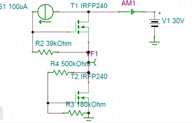

Firstly, thanx for the pointer to the Spirito instability problem! Very interesting. Perhaps DIY audio needs a list of MOSFETs to avoid?
Now about the crude amplifier from http://www.hawestv.com/amp_projects/amp_solid_tube/compl_output1.htm
These amps use RC coupling so the upper FET should be biased with a VCC/2 voltage (+4V vto), ie no pot required. The lower FET should probably have a source resistor. A typical bjt current source might be fine because it has a negative temp co. Or a VBE multiplier with a build out resistor to avoid shorting the gate drive. The amplifier needs a better VAS which would help choose how to drive the lower N channel FET. The typical quasi MOSFET output wastes about 4 Volts for the gate threshold, so this RC circuit is hardly worse. Today, P-channel MOSFETs are not difficult to obtain, so quasi designs are perhaps a waste of time. It is important to bootstrap both sides of the output to avoid wasting output swing on the gate threshold bias. I think Miles has some simple MOSFET amps posted here in DIYA.
