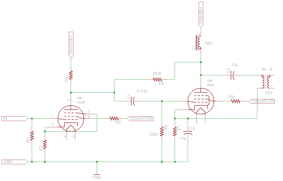

Yeah, I was referring to cap coupled. I lashed together a schematic. I know 100k is about normal for the feedback resistor. I guess what I'm looking for is help determining R2, R4 and the driver plate supply and the screen supply. I have looked through the datasheet, and could just used the recommended 250v pk 125v scrn 100 ohm R2, but I don't know what to use for R4.

Hi Chris,

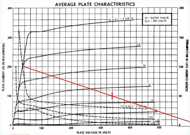

Here's how I go about op point selection for this topology. Starting with the output tube, I look for a B+ and OPT impedance that I like. Knowing it's going to be Schade feedback, I'm expecting a very low effective plate resistance so let's say 3000 ohms Zpri. I like the looks of 340V and 100mA which will give me about 15W Po at the plate for 34W dissipation. It could be run more conservatively of course...
That gives me a plate swing of 300V peak, and grid swing of about 14V positive and 20V negative (Schade feedback will take care of the asymmetric grid swing). That give me approximately 320V peak swing across the Rfb. For a 100K Rfb value, that's about 3.2mA peak current swing at the driver anode.

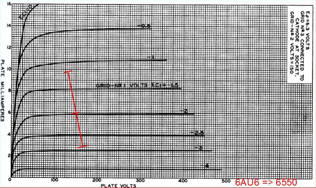

Next I plot the load line of the driver. Looking at the 6AU6 chart I could get a pretty linear current swing around 6-8 mA idle and 150V plate-cathode and 150V g2. Plotting the load line for 6mA idle and 3.2mA peak, with 15-20V peak driver plate swing give an approximate load line shown below. The real load line will curve smoothly over to accomodate increased swing in the negative direction. The driver will also tend to swing more current in the negative direction, which results in a little f2 distortion cancellation or conversion.
Next I look at the input sensitivity and grid bias. If we use self bias the cathode resistor would need to be about 330 ohms. If unbypassed (ideal situation) the input signal peak-peak sensitivity will be about 1.8V of 6AU6 grid swing plus (6.4mA*330R) 2V cathode swing for a total of 3.8V Pk-Pk or about 1.35V RMS input for full output. This is nice, so I would use 330R unbypassed for the R2 in your circuit.
Now I figure the plate resistor or CCS setting. Current through Rfb will be about (340V-152V) /100K or 1.88 mA (neglecting OPT DCR for the minute). We need an additional 4.1mA or so through a CCS or driver plate resistor. I'd use a 47K 2W to B+ for R4 and be done with it. Actually personally I would use a CCS set for about 4 mA but a resistor should be fine. It will steepen the load line of the driver a little bit so at this point I'd go back and re-plot it but that's basically the deal.
Does this work for you?

Absolutely, thanks for the awesome explanation. A CCS would be no problem for me, and I have seen the benefits with triodes, but I thought that CCSs and pentodes did not mix. does the Schade feedback change that. I have some boards made for a pimm self bias ccs so I will try one of those set to 4ma.
The current mode Schade feedback provides an AC load for the pentode, and the feedback resistor provides a DC path to define the idle voltage.
One issue with the CCS may be that the driver plate voltage drifts a little but the DC connected feedback resistor should stabilize it to some extent. I'd set the CCS for 150V on the driver plate and check the voltage periodically to get a feel for the DC stability.
