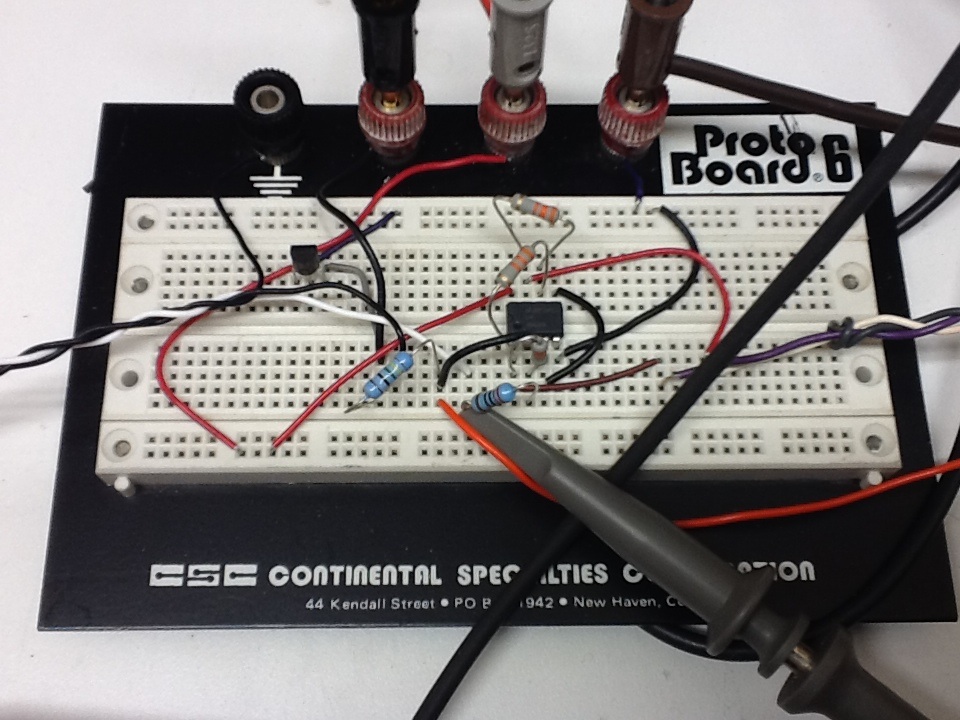

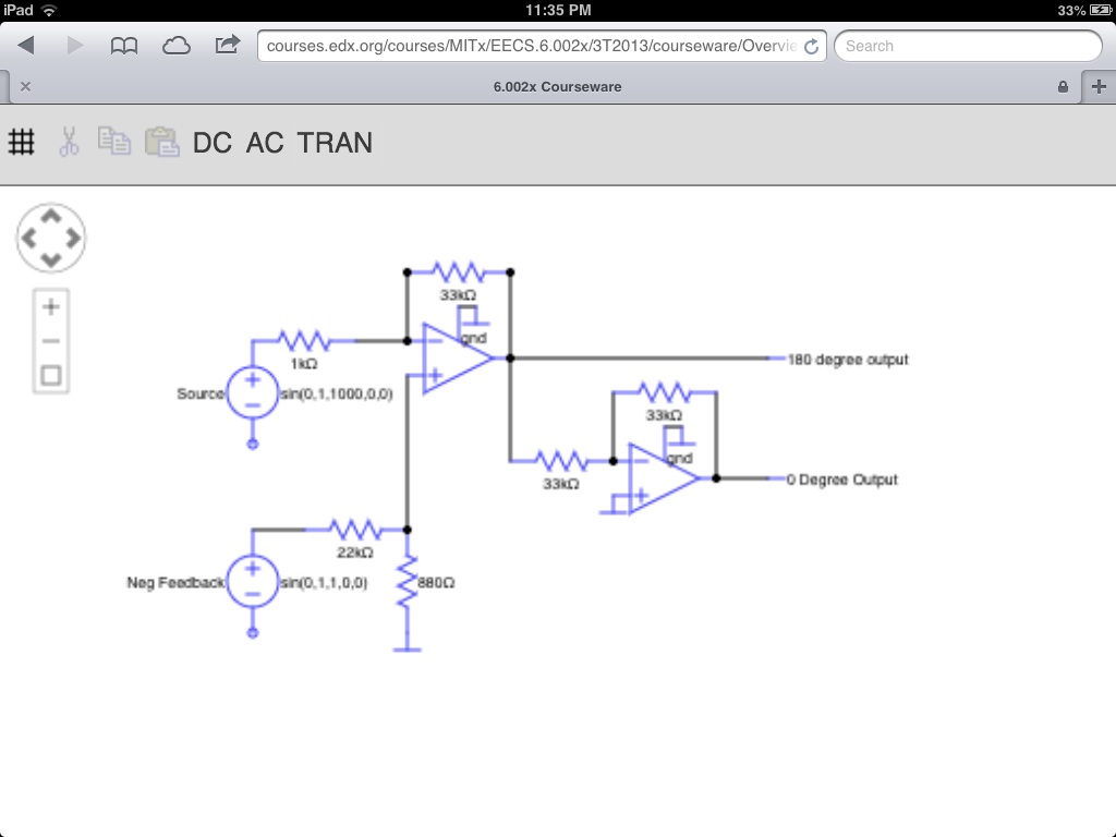

Here is the circuit I used.
I was very satisfied with it. I used it with a push pull pair of 6L6GC with a 360v, 62ma, -16.5 bias and 270 g2. That required a little more than 25volt pp drive and the TI LM4562 did quite well. I was stunned by the absolute silence with no source signal. The most quiet amp I've ever built. Interesting exercise.

a paraphase invertor made out of IC's?
Not really but I get the comparison. The first op amp inverts and amplifies. I ended up with a 33k and a 2.2K resistor around that op amp. The ratio is the gain- about 15. That is enough to allow a 1v rms signal (2.8 pp) to drive the output to saturation with a 38 volt differential power supply. An adjustment in gain is just a resistor away. The second op amp just inverts that signal without gain if the resistors are closely matched.
The other source represents the feedback. I'm summing in negative feedback at the first op amp so it appears equally in both outputs.
One chip contains two op amps so it happens with just one device as you can see in the photo. The other device is a rail splitter for the power supply.
There are plenty of other ways to do this but this one seemed simple and foolproof.
Thanks! I like it. I'll try it on a 6Y6 PP, soon, I hope
If you do, I recommend you start with a 2K2 and a 33K resistor on the first op amp. As drawn its too just much gain.
