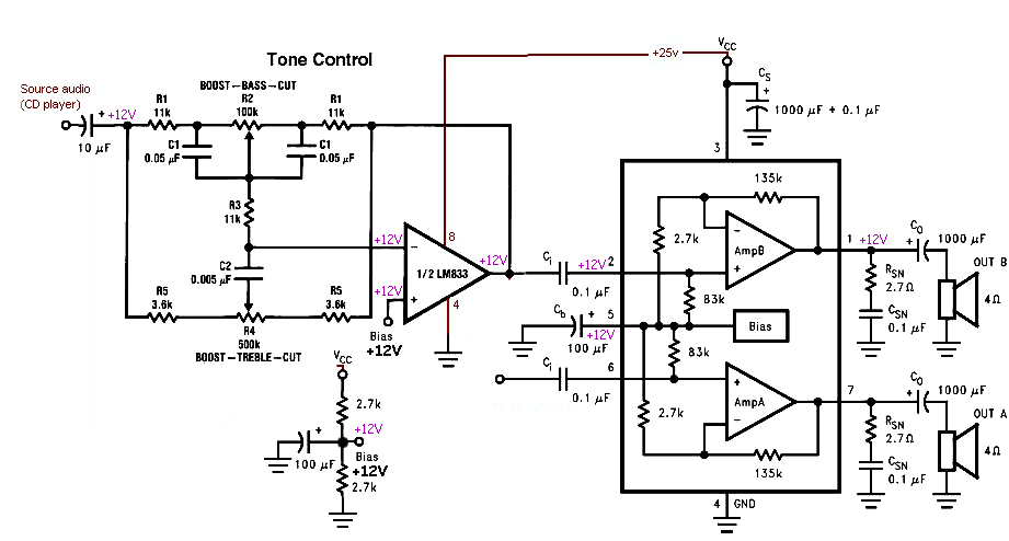

Hey guys, I'm new here and I'd consider myself a noob to DIY audio stuff as well since I've only been working with it about a year. Anyway, I'm almost done with an amazing (if I say so myself 😛) portable amplifier system however, I would love for it to incorporate some sort of tone control A graphic equalizer would be ideal but I'll settle for treble and base. So I bought a highly regarded (from what I can tell) audio op amp-- the LM833. However, I've correctly constructed a bunch of applications for the circuit with all unsuccessfull results. My knowledge of op amps is very limited and I find all this inverting non-inverting and negative supply rail stuff a little confusing. I would love it if someone could help me out with this, I'm really stuck in a dead end.
Here's how the system works so far: it uses a LM4752 22W amp that runs of a 25v li ion battery pack. I'm also adding optional kareoke inputs and an FM automatic scan radio. The radio and LM4752 stuff is all entirely finished an functioning beautifully, like I said I just want some sort of tone control and a small mic amp maybe. I would like to construct the Tone Control, Graphic Equalizer, and Balanced Mic PreAmp applications from the LM833 datasheet here:http://cache.national.com/ds/LM/LM833.pdf
but I've been having some problems doing this. So here are my questions:
-It says the op amp requires a -15v and +15v input. Can't I simply connect the negative and positive ends of a battery for this? Or do I need 2 power supplies?
-Is the input signal on the op amp supposed to come directly from the audio source? and the output can be fed right to the inputs of the LM4752, right? That's what I'm trying to do anyway...
-Also, I'm not getting any sound when connecting a speaker to ground and the output (with the audio inputs grouned as well). But when I connect a speaker to the output and the positive supply rail I get some highly distorted sound...is this simply because the output is inverted?
Sorry for such a long post about this but I desperately need some help from someone with these op amps. I'm willing to spend whatever it takes on parts to get this working, I just need someone to help guide me through it. Thanks.

You cannot just simply connect the opamp supplies to the 25V; I mean you can but need to do a bit extra to run the opamp single-supply. You connect the + supply to the +25 and the -supply to ground. Then you bias the opamp inputs to about mid supply. Then you connect up the signal through DC blocking caps.
Assuming you use the circuit on page 12 of the data sheet: Make a +12.5 V point by using two resistors of say 10K between +25 and ground, and connect the +input to the midpoint. Decouple it with an electrolytic of a few uF to ground to get rid of hum and noise.
Then use a series cap of say a few uF on the Vi point to connect up the input signal. The output from the opamp (Vo) to the power amp should likewise be AC coupled with a series cap, but that may already be present. Use non-polar caps for 50V or more for the signal, like polyester film or, if you want to go overboard any of the designer caps. The value depends on the circuit details, but you can first try it (I have the impression you are the experimenting type, great!). If they are too small you will notice a lack of low bass.

Pretty much any OP-amp application requires a split power supply, and that includes power amplifiers as well.
For the tone control circuit you'll be able to get away with a simple voltage divider with capacitor decoupling. For the power output you'll need a large capacitor in series with the loudspeaker.
Look up single supply operation in the data sheets.

The LM4752 can be used two ways. Because it is a low-cost part, they show it with a Single Supply and an Output Capacitor. But you can also use it with Dual Supply and no Output Capacitor. (The later is also how most op-amp plans are drawn.) Which way are you doing it?

PRR--the LM4752 works perfectly...I was referring to the opamps not outputting properly. Don't mock me.
As for the Op Amp power...I forgot to mention that I was giving it 15v from the same battery (drawing it from another cell within the battery). I just don't understand why these opamps aren't working for me...in the LM4752 datasheet it says only the non inverting inputs are available and I think most of the op amp applications I'm doing have an inverting output...but I'm not sure how to make them non-inverted and how to calculate the gain and all.
Do I need to do anything to the source audio before I input it to the op amp? And I've been tested the op amp by connected a speaker to the output pin and ground...is this an improper method? I just don't want to drive it into the LM4752 unless I know it's perfect.

Please be clear, are you trying to hang a speaker on the opamp ('833) output?? That won't work! If it did, you wouldn't need the power amp.😉
Do I read you right: the power amp part works, but the (pre) opamp part not? What exactly ARE you trying to do? Didnt you say you wanted to use the tone control schematic? Please draw a schematic and we all can move forward.
If you have 25V single ended, that will be fine for the opamp. If you limit the opamp to 15V and the power amp to 25V you will not get full output (the opamp will limit it). Please re-read my previous post.
Jan Didden
> configure the LM833
Essentially the same as that power-amp, except the PA chip handles some dull details that you have to DIY with the universal op-amp.
You have +25V and Gnd. (I'm going to call it +24V for math simplicity.) An audio amp has to handle both polarities of audio. However, the audio signal reference does not have to be the DC ground. It could be almost any voltage between the +24V and Gnd supply pins. Half-way is often best: +12V.
We don't have a +12V supply. Neither does the 4752, so it makes its own with that box called "bias". If you probe pin 5, it sits at half the supply voltage. And if you probe the output pins, you will find them near half the supply voltage (because the feedback gain-set networks reference the Bias voltage). The output pins swing from +12V to +22V to +2V and back. Co is charged to 12V at start-up, and after that will cancel 12V, making the voltage at the speaker 0V, +10V and -10V. Swings both ways, even though the chip only does positive voltages.
Do the same with the op-amp. You "could" even use the same Bias supply, tapped at pin 5. In general, I hate to try small fine work while hitched to a hard-working Power stage. I'd probably use two resistors and a cap, as shown in the attachment, to make a Bias supply for (all) the opamp(s). The two resistors split the voltage; the capacitor makes it clean for audio reference.
Opamp power is still +24V and Gnd. But the DC reference for the inputs must be changed to the +12V Bias source. For this inverting tone control, not connected to anything else, if you set the "NonInverting" input to +12VDC, the output will also lay at +12VDC. So will the input to the tone network, so you can not connect it to a source directly. You need an input cap.
My volt-notes in purple are (roughly) the voltages you should observe. Not critical: it "should be" +12.5V for 25V battry, but +/-10% deviation for resistors makes no difference. Measuring some of those points with a typical voltmeter will load-down the bias a tenth-volt or so.

Hey, thank you SO much for all the help. You even put in the schematic for me =) I tried everything you said and tested all the voltage places. I got all the correct volt readouts on everything with the op amp and the LM4752 is functioning perfectly. However, the output (when going through the opamp) is very very soft and you can barely hear it. The bass knob is working perfectly but the treble only sounds right when it's at full or off. In between it gets very fuzzy and sometimes intercepts the radio..heh. The only thing I changed from your schem was I used 3k resistors instead of 2.7k on the bias input. I don't think this makes any diff though,
Maybe my op amp is messed up though from previous testing. I'm going to try another one tomorrow and see what happens!

Incidentally, I know you have the amp working properly, but I thought I would point out that you could achieve 12.5-0-12.5 voltage for this system by choosing your ground from halfway through the battery pack. Then the negative end of the battery pack would be your negative rail, and the positive end of the battery would you be your positive rail.
Not that it makes much of a difference, adding the voltage divider and some AC coupling at this stage of the game seems like the way to go.

Sega: I am suggesting you abandon your attempt at single supply operation for now.Try using two 9 volt batteries as a bipolar supply, tie one + terminal of the battery to the negative of the other battery and ground this.Now just connect the + battery terminal to pin 8 of the chip and the - battery terminal to pin 4.

You're still feeding the op-amp 25V? I thought you were going to build a voltage divider and AC couple the two amps?
That op-amp will not work in single rail mode. Although, if that's how you're using it, it describes your symptoms well -- effectively you're only swinging around the + and chopping the waveform in half.

wes-ninja, you really confused me. In the schematic you showed 25v connected directly to the op amp and you also said "Opamp power is still +24V and Gnd." That's why I connected it to the full power supply. So are you saying to just do a 12v input to the bias and a 12v input to pin 8? That definitely makes more sense.
As for the 25v li-ion pack, I'm using 6 li-ion cells in series. I'm charging it by using a swithc to split the + and - terminals of the pack and input 12v. After half the pack is charged you just switch it back and it charges the other half. The whole thing charges in 2 hours which I'm fine with. I could build a 25v li-ion charger but I rather keep it as a 12v for my other li-ion packs.
So for the opamp, 12v input on pin 8 instead of 25v and keep everything the same from the previous schematic? Should I use the same + and - as the bias inputs or draw the positive 25v line and ground from the middle to keep it at 12v?

Hey, SSF!
I didn't post that schematic, PRR did, and he's definately smarter than me. 🙂
***** I am not an expert -- so the thinking below could very well be wrong *****
Okay. What the posted schematic does is bias the op-amp at 12+ in your 0-25V system. This should effectively make the 0-point 12V as far as your op-amp is concerned, giving it the same effect as if you had a 0-12-25V system.
But, remember, voltage is merely electrical potential difference. That's another way of saying "it's all relative" -- so as far as the op-amp is concerned, biasing it up at 12V is the same as running a -12-0-12V system. You're lucky that op-amp has a bias pin, many (LM324, TL072, etc) don't and use an internal voltage divider to figure out the where the zero point is.
Have you created a voltage divider to give you your 12V bias? That would be two resistors of equal value from rail-to-rail, with the mid point yielding you your 12V. Lower valued resistors will give you higher current (and put more load on your PS), but you shouldn't need any real current for the bias pin of an amplifier. So I'd use matched resistors of at least 10K ohms as this is a battery-powered circuit.
-- OH, I just re-read PRR comments, you should be able to get the 12V bias from the 4752, eliminating the need for the voltage divider.
So let's see, you should be connecting pin 5 of the 4752 to the bias pin of your op-amp. Next, pin 8 of the op-amp goes to 25V, pin 4 goes to ground. Measure the purple voltages that PRR outlined for you, and see how it goes.
Are you able to put your circuit on a 'scope with a signal generator? Seeing the waveform with a bias reference (dual trace 'scope) would be extremely enlightening, I'm sure.
Are you *also* using the 2.7k-resistor voltage divider circuit shown in the schematic? I would think that you could one or the other, but not both.
Do you measure 12V on the "ground" of your audio input? I think that you should.
Me? I find audio circuits confusing enough to think about without trying to monkey with raising the bias. I would run +/- rails. But that's just me. This should work, too, since it's really the same thing if you connect the black lead of your meter to the bias pin..
Oh, one final thing. Is it possible that you have too much gain on the op-amp and are over-driving the inputs to your amplifier? Have you tried testing the op-amp circuit separately (i.e. on a breadboard) with a pair of amplified PC speakers? Have you measured the output voltage swings of the op-amp with a 'scope? Are you driving the input with something other than a line-in?
Good luck. If I had this circuit in front of me with appropriate diagnostic tools, I could probably fix it -- unfortunately, my theoretical knowledge in this area is quite lacking, so I can only take stabs in the dark without seeing the waveforms and following them through the circuit.

Well, I don't have a scope unfortunately. You said I DO connect 25v to pin 8? But I shouldn't also connect the voltage divider (12v) to the bias input? That's what I've been doing...and it's easier to draw 12v from the battery. Like I said I've been using 3k resistors instead of 2.7k though.
