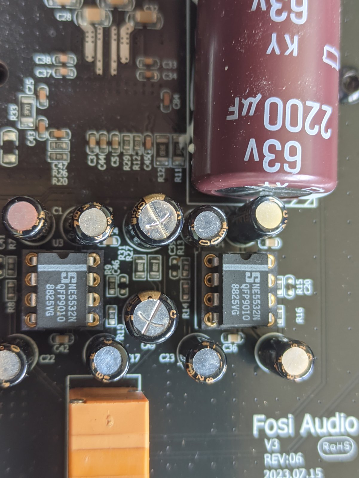

Curious about your opamp configuration as I’ve experienced some scratchyness ( is that even a word, haha) in sound quality. IIRC you used the same adapter (Sparkfun) for an soic opamp. I couldn’t find an lm6171 in a dip package at the time. Of course it’s available now so I thought I’d give it a go except that does mean de soldering the sockets from the dac board which I’m a bit leary about. To easy to mess that pcb up. I’ll just have to cut the existing sockets out and just de solder the pins. Then I’m held to opamps in dip package only, hmmm
Any suggestions?
Hope you’re doing ok

Hey sir, sorry for my late reply. I moved last month into a century home that's been vacant for a few years so lots of home renovation work to be done.@asilker can you share the link of the exact TL071 that you used? I can see that there are so many versions now, but i want to try the one you used. Thanks in advance!
Have to apologize, offhand I do not recall the suffix. If I understand correctly, the different suffixes for the opa's usually pertain to specs like operating temperature and voltage offsets (or in other words you'd probably be fine with any suffix)
hope that helps
