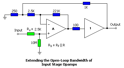

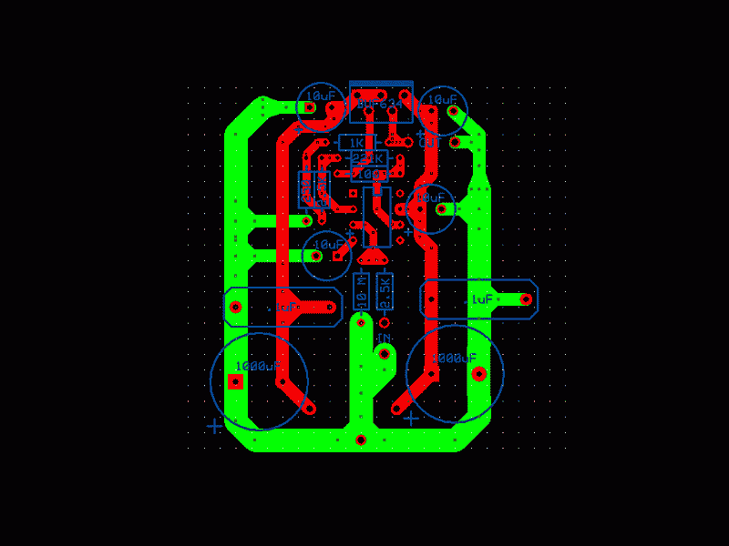

Never built it Adam. Not yet anyway. This is what is referred to as a Jung multiloop configuration. I just decided to lay out the board one day. It keeps me sane.🙄 If you would like I can send you the schematic and the board file(ExpressPCB) and you can look it over. I think that the layout is sound. I have one with two channels on one "miniboard" that is layed out to use Caddock MK132 resistors. Bu t think you could get away with others. Let me know and I'll send the stuff.
G
