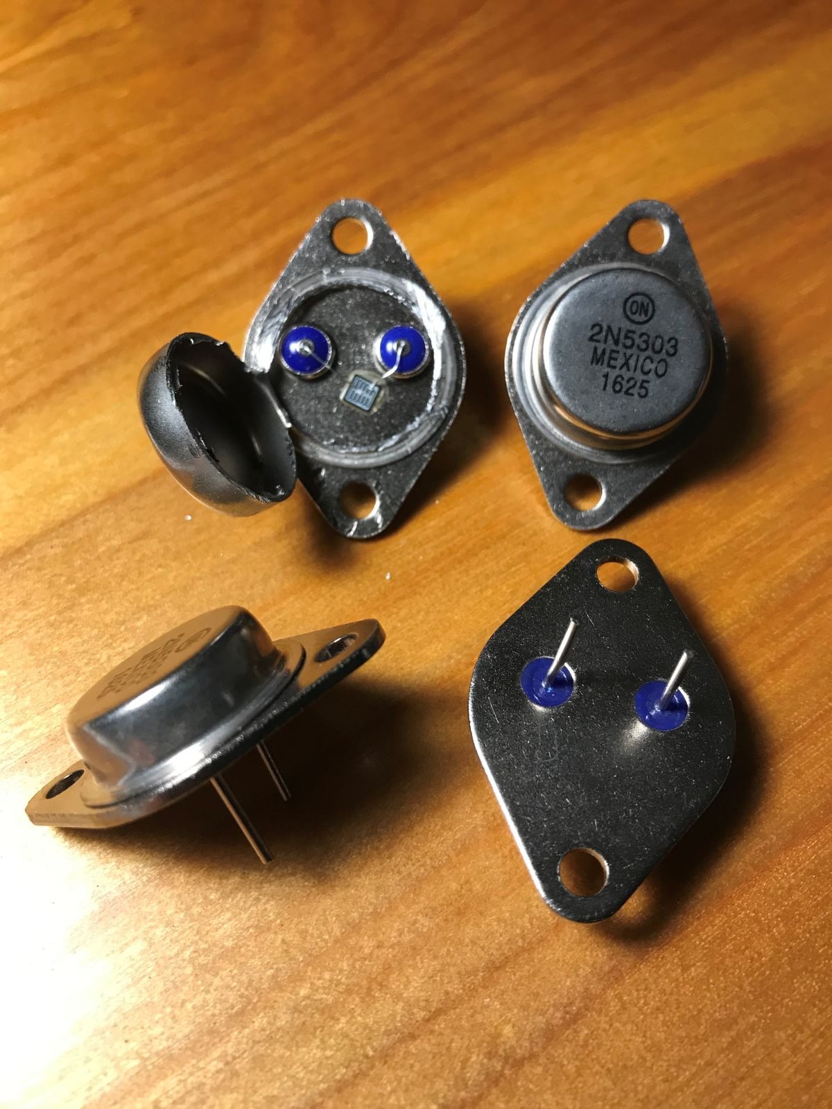

I bought these recently from you know where, and testing them with the PEAK Atlas DCA55, I got the following readings....
hFE: "23"... "58"... "103"... "108"........... so I decided to open the "23"....

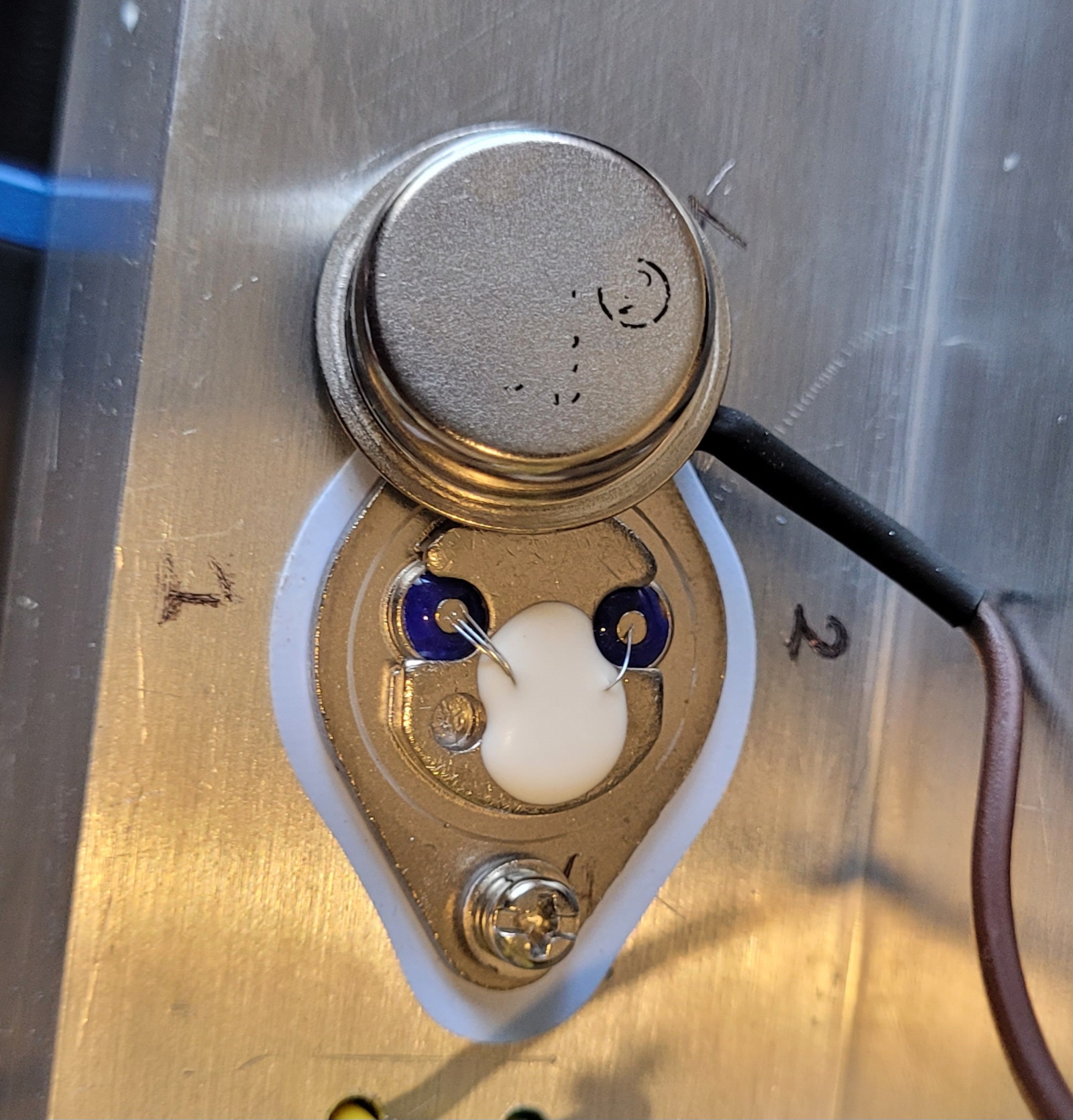

Fake, but they probably work to a degree. It’s missing the heat spreader coin, the die is about 150 W, but the emitter bond wire is only good for maybe 10A. 3503 is supposed to be good for 30A. But not much voltage, and pretty miserable second breakdown ratings. They would do better than most fakes.
seller's response........I haven't mentioned that I hacked one of them up, but he'll know soon enough.

People may have actually used them, with no issues. Depending on how hard they run them. They will hold up better than the ones with the 2mm dies and white goop.

Listen to the treble of the fake ones... It will sound harsh. The treble of the originals is softer. I've tested a lot and the output transistors have a big impact on the treble. Input and driver transistors are important for stage and bass.
Plus, the originals say MEX. Mexico does not write. The order is as follows: 1. ON 2. Week and month code 3. and last MEX FYI.

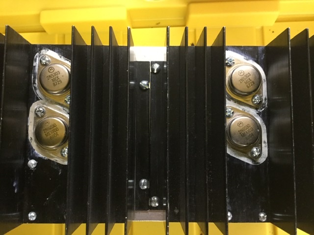

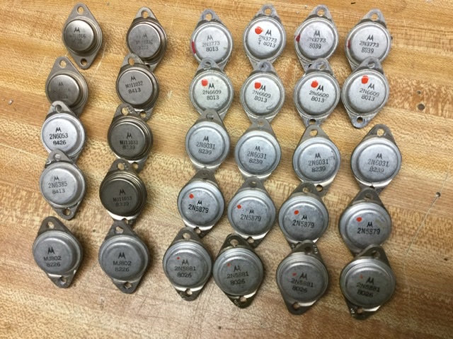

Yeah, the 6030’s were purchased new, that long ago. I therefore had a known reference for the aluminum 6031’s which came from Tanners (anyone from the DFW area would remember them). They measure the same, and neither have ever failed. The 5303’s were a gamble from BG Micro. They had a whole bunch of low voltage epi-base stuff, various numbers, various makes, all TO-3’s, nothing with any current commercial demand. And about 10 different TV horizontal output types, all come in around the same time. I got one of each of 5 types, checked them, then loaded up on the next order. I passed on all the HOT’s though. No use for them, and neither does anywhere else. My guess is that stuff was sitting in a warehouse for more than 20 years.
I have yet to see any fakes marked with 30 year old date codes, or any in the old aluminum case. I don’t even buy and try obsolete parts with recent date codes.

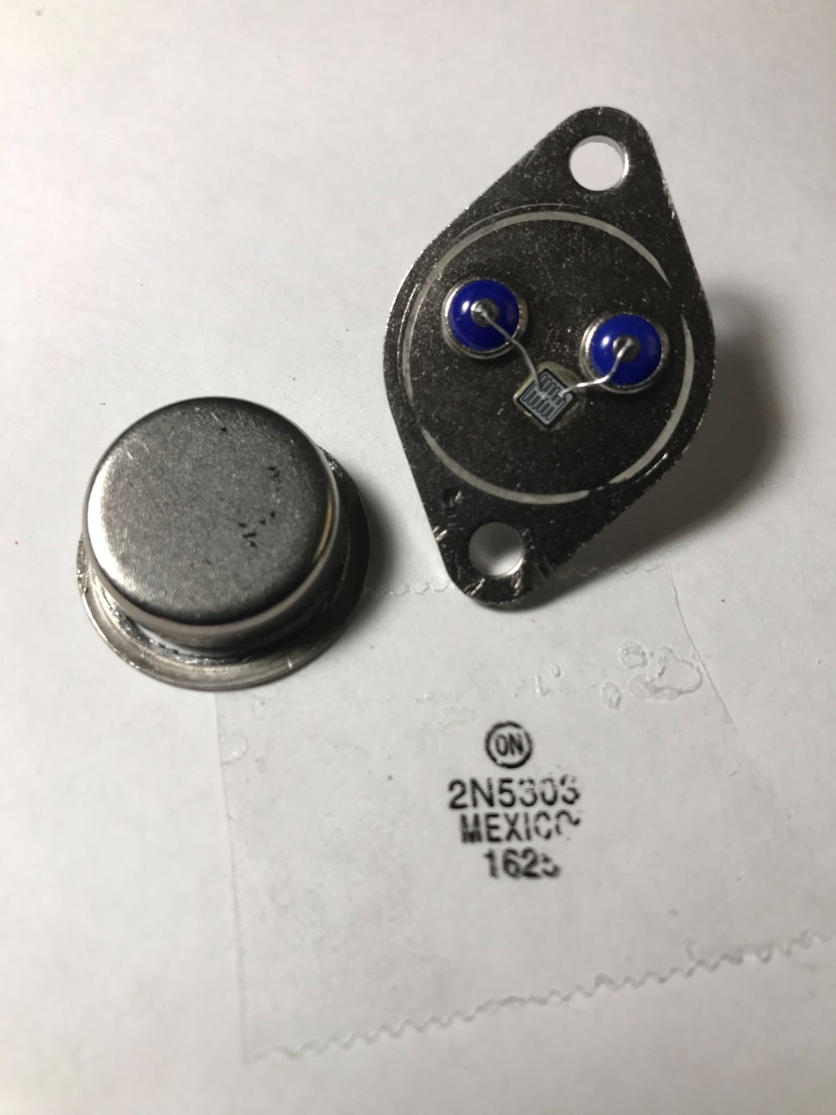

Two more clues....
After cutting the top off with a hacksaw, I realized that it could have been simply pried off with a screwdriver.
Also, when packing to return them, the lettering came off with the clear packing tape...
I was wondering about that lid. Actual fake parts just pop right off. Re-marked generics might actually be hermetically sealed, with a “good” transistor inside. Just not the one you supposedly ordered…..
I completely agree. The lids of the fake ones open easily. This is the fake one I came across. I paid $12 each.

That one’s actually got the heat spreader coin. Any chance of peeling up the goop on one and having a look-see? Could get a guesstimate of its actual power handling (at least in the thermally limited part of the curve).
