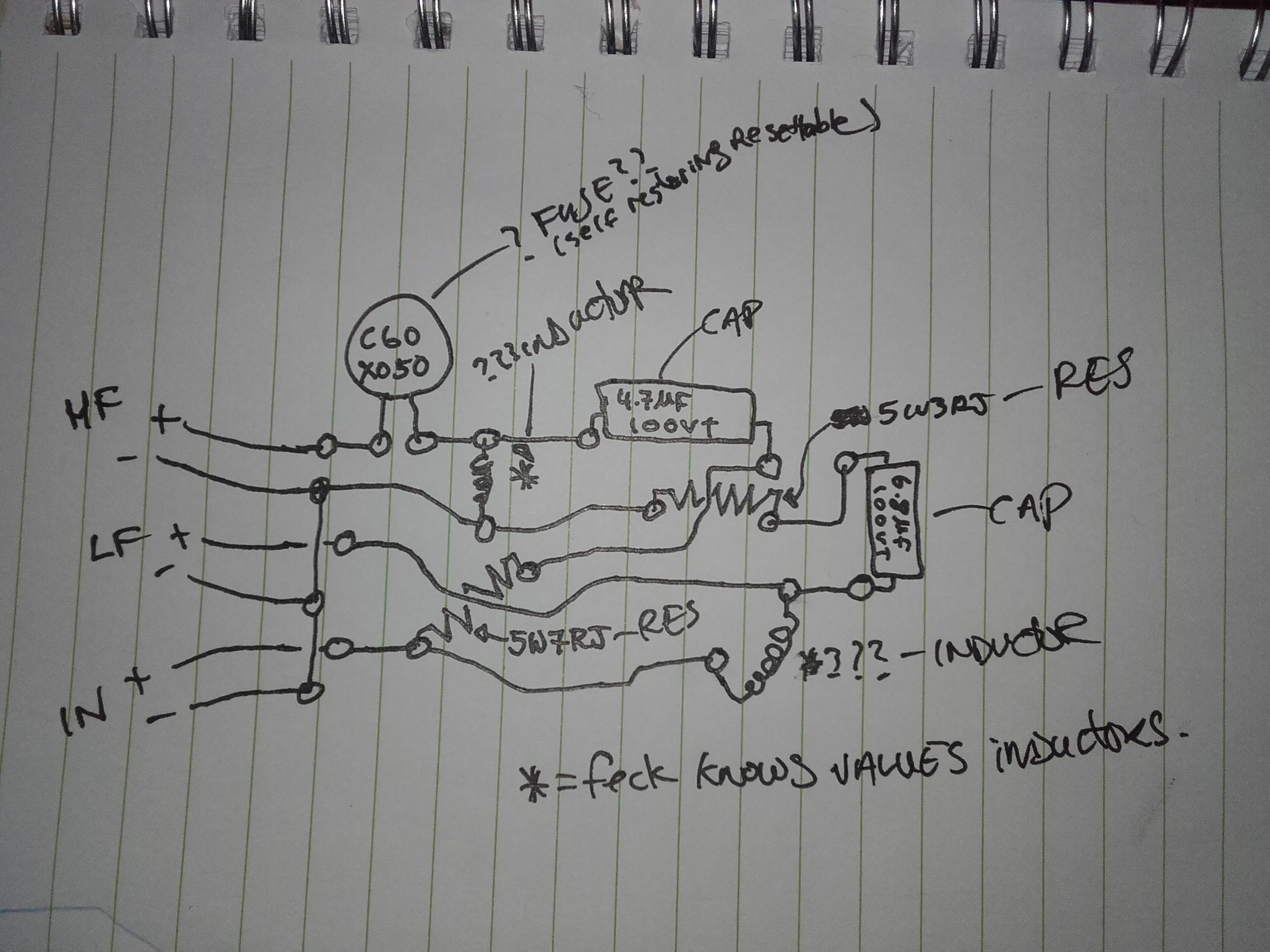

Hello useful people. I've been trying to work out what a pair of crossovers I have actually are. It's not really important, just for curiosity and knowledge because:

Are there any that work in reverse? No luck googling so far. I can read (I think) the values on all the components, trace the signal path, all that mess, but I'd quite like to know what they actually are.
So, short version: Any sites out there were a body can enter the components and signal path of an already existing crossover and be told what it is?

I'm not aware of any 'reverse' calculators.I've been trying to work out what a pair of crossovers I have actually are.
The first thing to do is to look at the physical crossover and try to establish what 'order' it is (1st order, 2nd order, 3rd order or 4th order).
Before taking this any further, allow me to check if you are aware of what order the crossover in your photo is. Do you know?
search the WEB FRD Consortium find fantastic calculators that I have been using for years, and which I have also had the opportunity to check with the values published by the sector magazines
I had similat task before. Its easy. You keep entering frequency till the calculator spits out cap and coil values present in your crossover.
But first you need to know the order, as Galu said.
And you need to know the speaker resistance. Then its easy.
So get drawing. We can help.

Two inductors and two caps with six connectors.
I think it is a fairly good bet that it is a 2way second order job.

The idea is to find out the values of those two inductors, Tim.
Using a simple second order, two way crossover calculator like this one ERSE - Crossover Calculator - Second Order 2 Way will throw up the values of the inductors - provided the correct individual impedances of the bass and treble drivers are entered (and after you've jiggled about with the crossover frequency of course).
I think the capacitors on the board are 6.8uF and 4.7uF. If I enter a high pass impedance of 6 ohm, a low pass impedance of 4 ohm and a crossover frequency of 4000Hz into the above calculator, I get calculated capacitor value close to those standard values - and, crucially, the two inductor values.

If you're going to guess the frequency, you can use the formula f = 1/sqrt(2*pi*L*C) to find the missing value on a 2nd order directly. But it's only as accurate as the guess...

Trace the circuit. It's no more complicated than a subway map.
Car-sound is usually 4 Ohms. Do you know any reason this might be wrong?
With the plan "any idiot" can plot the nominal response on resistor load.
Or heck: connect it between a power amp and a couple 4 Ohm resistors, sine-sweep, measure level at both outputs.

Even though the guess is likely 2nd order electrical two way, it could also be two way with 1st order electrical on the woofer and third order electrical on the tweeter 😉
