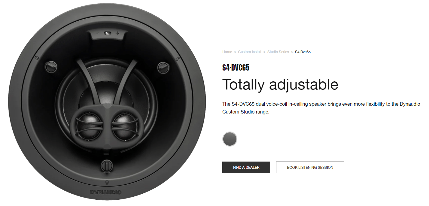

If all depends on your definition of good "stereo sound overall." Is it optimal for all possible scenarios? No, but neither is anything else.
Dynaudio is pushing way into the midrange with one of their dual voice coil designs, so it may be worth trying. As usual, I suggest prototyping quick and cheap to see what things do together.
I think most people are talking theoretically and optimally. I doubt many have actually tried going far into the midrange with a dual voice coil speaker. I haven't.
https://dynaudio.com/custom-install/studio-series/s4-dvc65
Tweeter 2x 28 mm soft dome
Midrange/Woofer 16.5 cm MSP DVC
