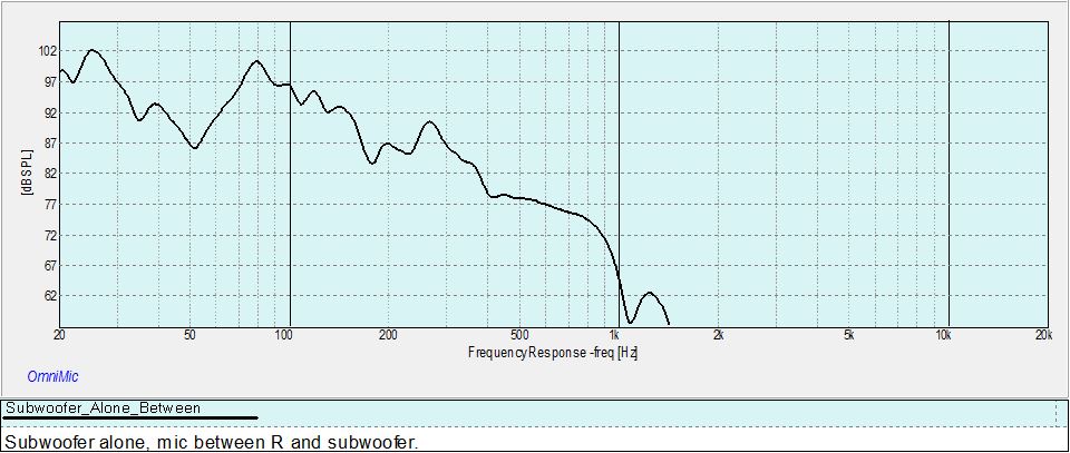

First, the subwoofer in room response. This includes the effects of the two GLK Soffit Traps directly behind the subwoofer. The in-room response without them is MUCH worse. I would call the Soffit / Bass traps the enablerers. By removing the otherwise massive nulls and valleys equalization becomes much easier, if not possible. I could probably now push up the dip at 50 Hz if I really wanted to. Without the bass traps there would be nulls here I could simply not EQ my way out of, and the mild cuts in the EQ would not be nearly good enough.

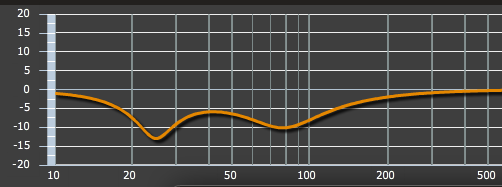

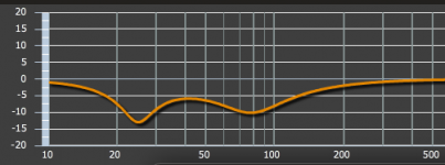

Then the parametric compensation added:
As you can tell, this is a much more light handed approach than could be done. I could have exported an inverted FR and created a curve to match it, to get "perfectly flat" response. I'm completely avoiding that approach based on experience of that sounding not very good. I'm taking the gravy with the lumps, as it were. It's oddly counter-intuitive that to get good deep bass you must subtract. I subtract with the bass traps and I subtract with the miniDSP equalizer, and yet I feel I've gained twice the subwoofer. I think it's this going backwards to go forwards that prevents so many audiophiles and DIY'ers from investing in this approach.

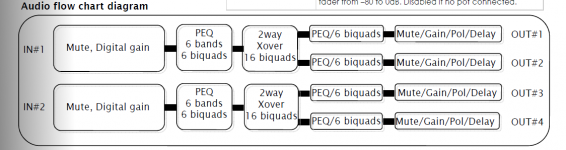

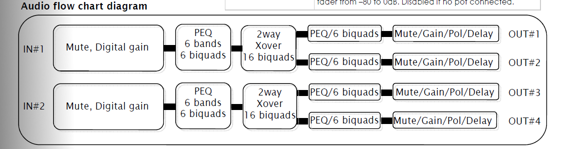

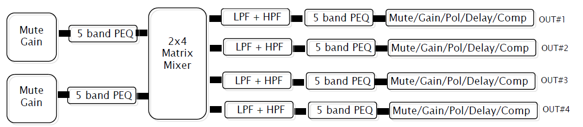

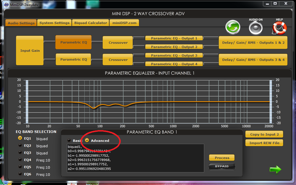

The issue with miniDSP is the plugins. You must use the "advanced" plugins to have the option to load biquads. Whether or not you can load biquads directly (Advanced) and whether or not you can cross signals across input/output groups (Matrix Mixer) is what distinguishes all the plugins. It's hard to tell until you look at the block diagram in the tech sheets.
The 2 Way Advanced has biquads, but not the mixer.
The 2x4 Advanced has biquads AND the mixer:
Still, I think I did this the slow way, using each filter, selecting advanced, it let's me upload just one bi-quad at a time. To do this I selected each EQ button separately, and selected the "Advanced" setting, as below:
