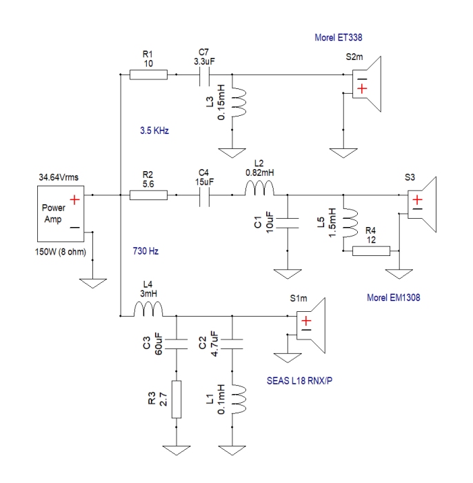

Now I've finished experimenting with my current speakers, I decided it was time to renew caps and resistors. As this speaker is better than anything else I've made and will remain unchanged in its current configuration, I wanted to use the best components I could afford.

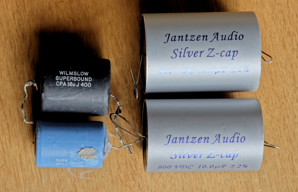

There was a bit of a shock when the caps arrived. I'm going to have to be really creative to fit the ones on the right in the space vacated by the ones on the left...
Oh crikey.

Bass and treble are fine, it's the mid that's the problem. The board it fits on is 10cm x 13cm and these two beauties nearly fill that. Along with two 'normal' sized 15mm x 70mm inductors and two M-Resist resistors this is more than tight.
Each section is attached to the back panel. There are four uneven sized panels - the fourth is taken up by the input connectors.
I thought about stacking - maybe put the 0.82mH on its back with the 15μF on top; the 10μF next to that with the 1.5mH on its end next to that with the 12Ω on top of the 10μF. Still very tight.
Dunno. I suppose I'll find a way when I take everything to bits...

Might as well mount the whole package externally. Since there are large resistors in series with the tweeter and midrange in your XO, you can use #21 gauge wire to connect them and #16 gauge lamp-cord for the woofer from across the room.
Then with the connections external, you can get a Behringer electronic XO (DSP or analog) for something comparable to what you paid for the silver caps and dispatch the whole crude passive crossover. If you replaced all the caps in both L and R, I would guess the Behringer would save you quite a bundle depending on how many spare amps you have in the house.
Given the irregularities of impedance and double-that for speaker output to your ears, hardly pays to fuss over passive crossovers since the results at your ears are unpredictable.... pending measurements in your room. At THAT point, you can twiddle the knobs on the Behringer and get exactly what sounds best to you in your room.

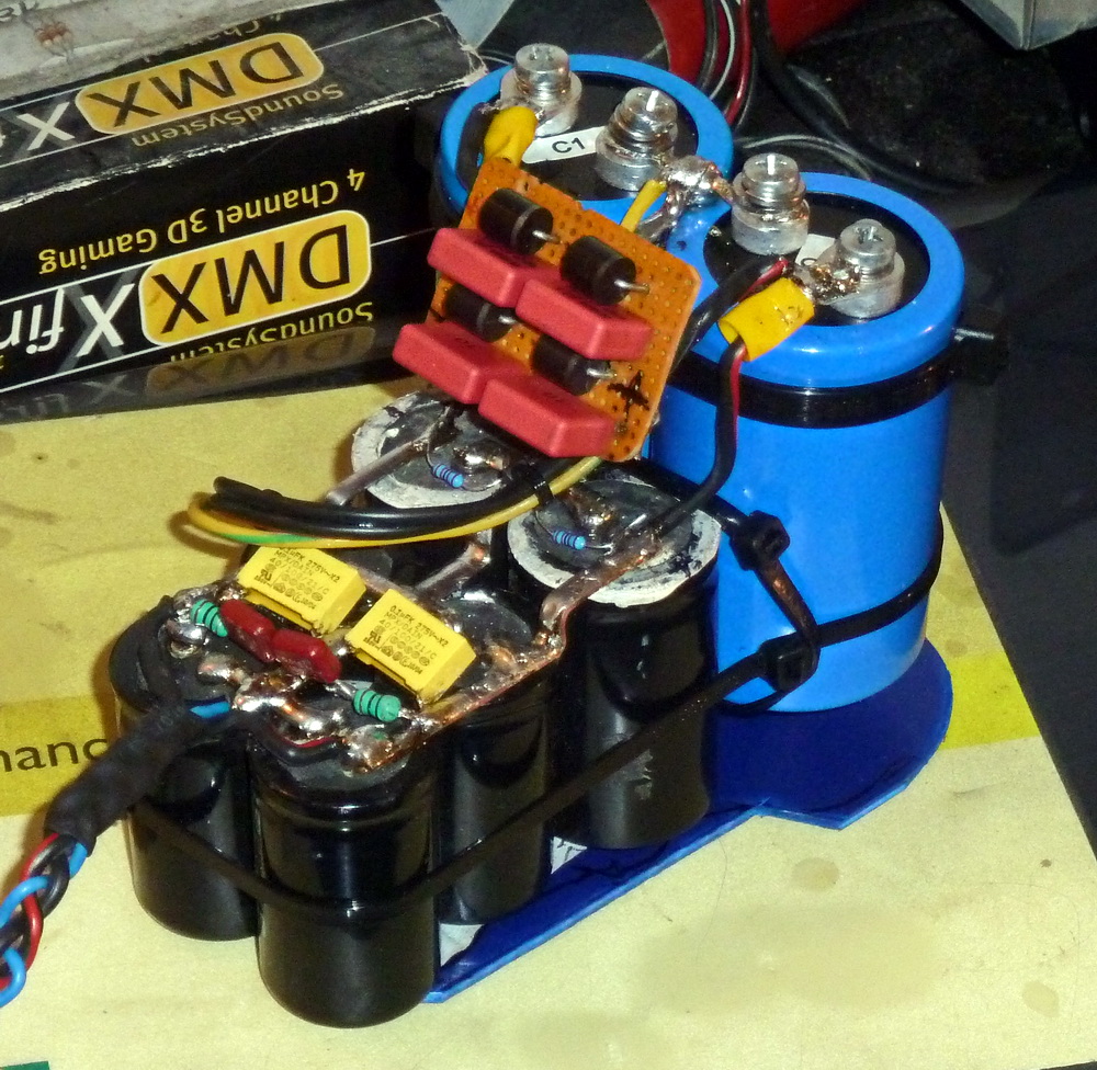

In relation to electronics I thought the same about the caps which are part of the current delivery for my Sub. I'm a latin man, but the 1st words coming out of my mouth as I saw those big blue buckets were: "Sacre bleu!" (the black ones are 10000µF/63V)
By the way, this website is great for capacitor reviews:
Humble Homemade Hifi - Cap Test
And indeed the silver one has excellent performance/price ratio!
If you'd go not for 800V but lower voltage, ie 630V or 250V, Audio quality is slightly lower, but space much lower.

Ben, there's something here that you need to understand.
Yes, active crossovers have advantages. Direct connection between the amp and speaker, easy to adjust, precise slopes, etc etc. You know the rest.
However, there's one really huge disadvantage to them, and it's this: non-audio people can't use the stereo.
My previous system involved a passive preamp, a DSP-based crossover and a bunch of amplifiers. It sounded really good.
... Except that only I could operate the thing. If someone else wanted music on, they'd play it through their phone's built-in speaker, or ask me to set up the stereo for them.
Today, I have a Cambridge Audio CXA80 driving a pair of speakers with (get this!) passive crossovers. Shock, horror.
You know what? I listen to more music now than I ever did with my DSP system. It's. So. Damn. Easy.
I put the work into the passive crossover to make it sound good. It took a 3rd order asymmetrical crossover, 2x notch filters, a Zobel on the woofer and an L-pad on the compression driver. It's not a trivial design, but it works. It sounds clean and neutral and if you turn it up, you can have a party.
In short, passive crossovers still have their place. Those of us that choose passive crossovers have our reasons to do so - it's the compromise we choose.
