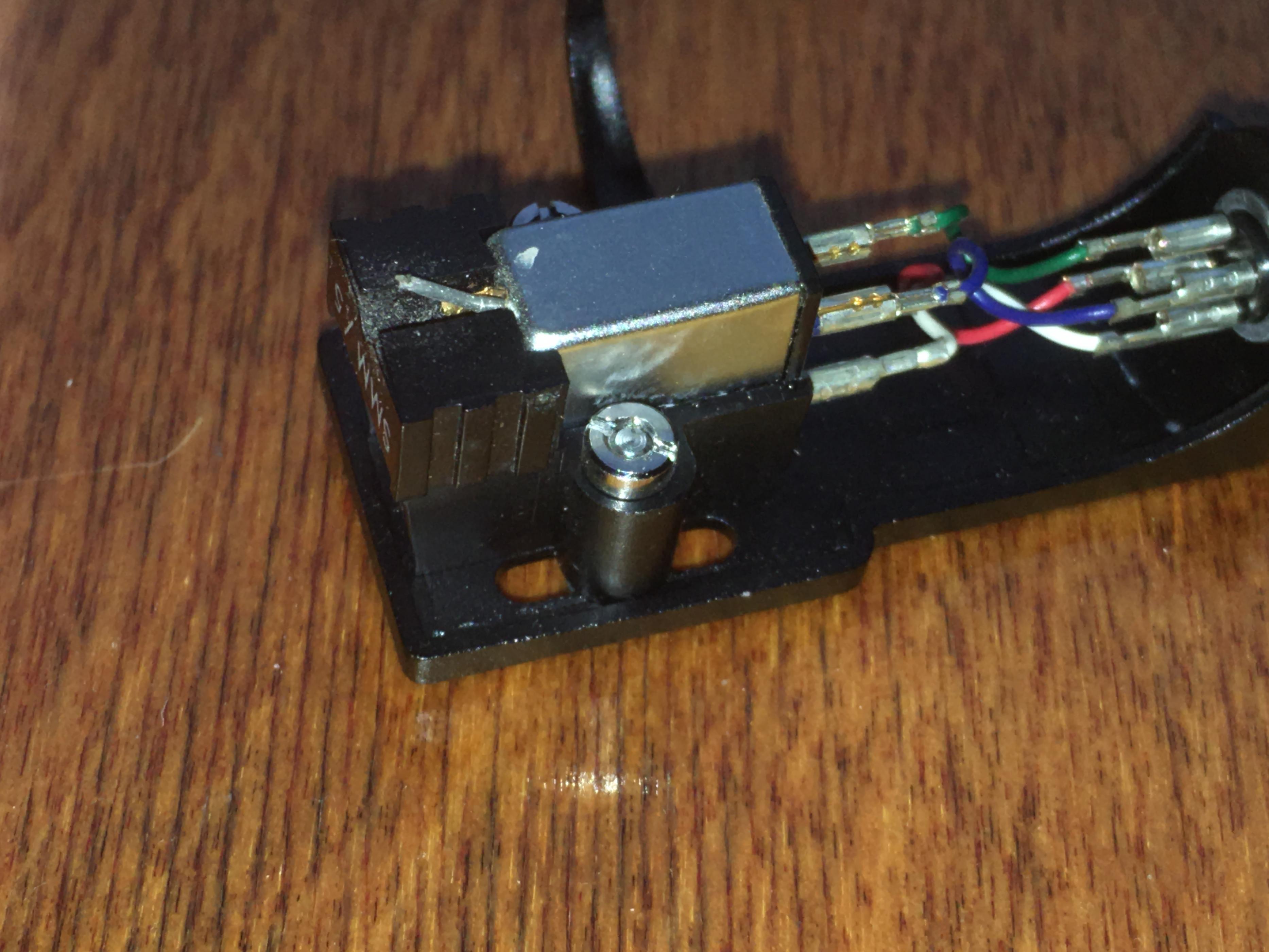

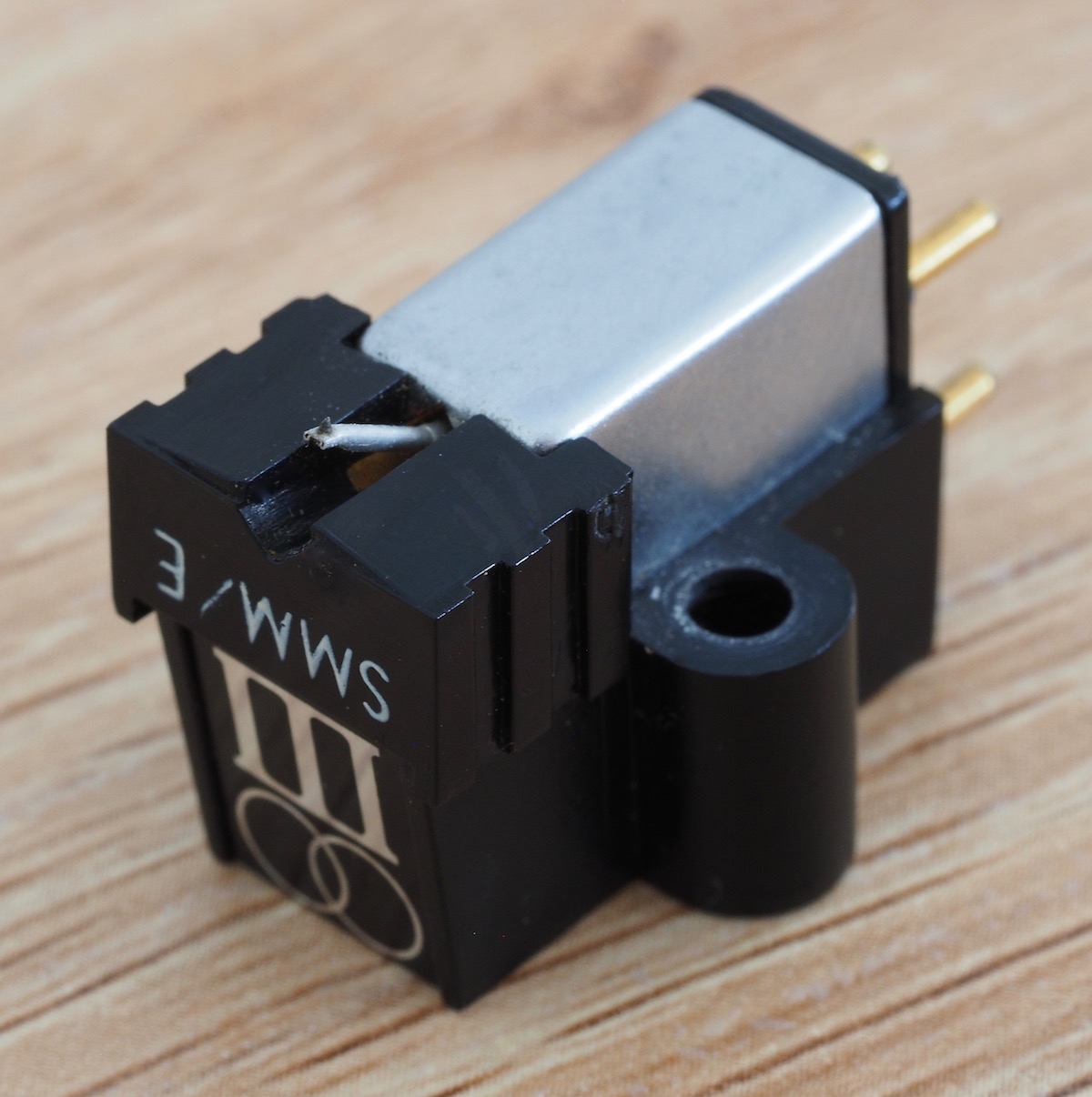

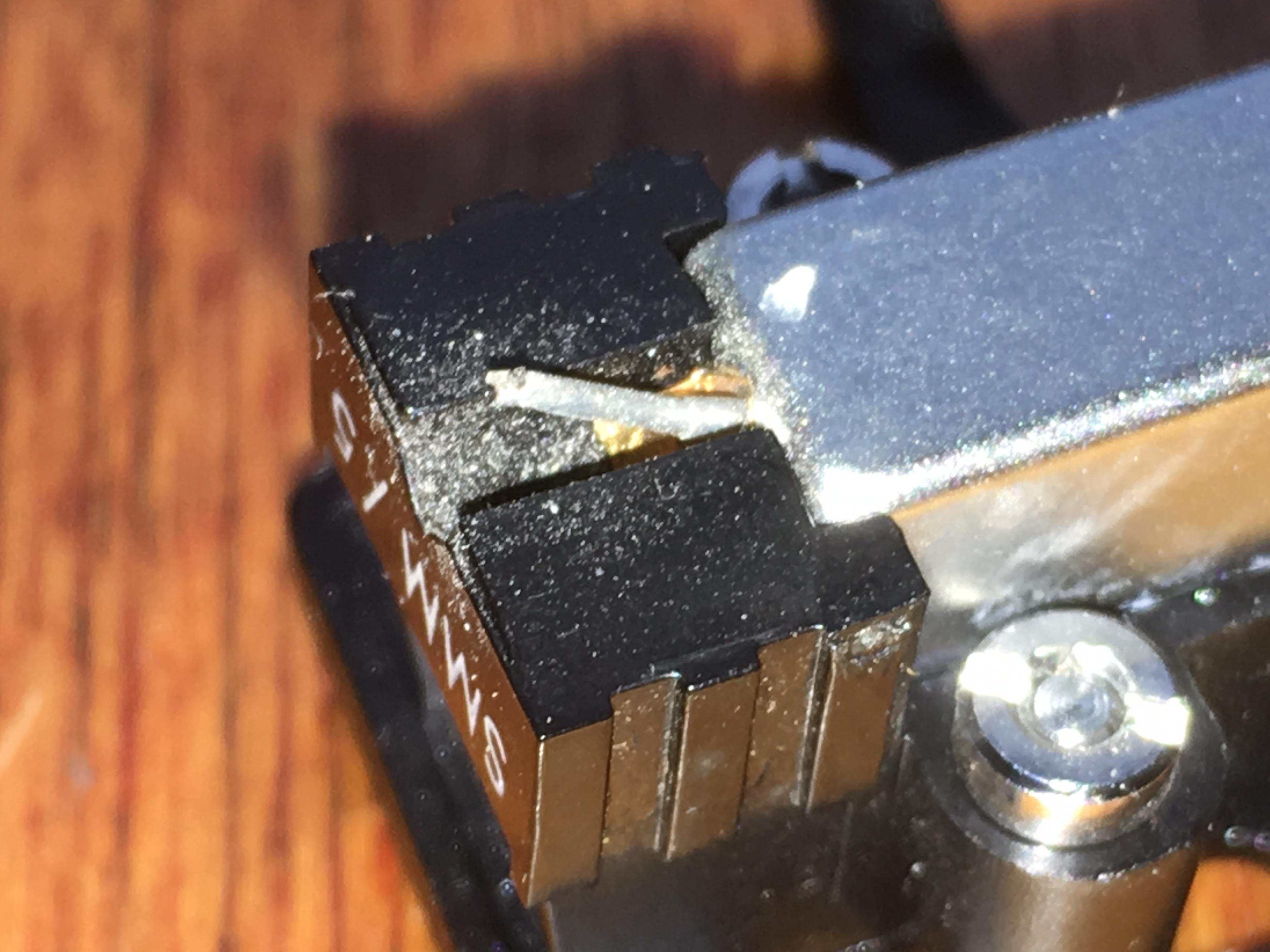

Hi I have bought an old Rega t/table with R200 tonearm and Supex SM100 Mk 3 Moving magnet cartridge. As I was setting it up I realised the metal part of the cartridge has come unglued? from its plastic body.
My initial thoughts are just to key both surfaces and use a superglue to reglue the metal part into its housing.
Does this sound like a good fix or are there any alternatives? It hasn't been used in years so I am assuming the glue has just dried up - I am also assuming it was glued in the first place and not just sat snuggly? Does anyone know these cartridges?

In post #2, I suggested you post a photograph of the separated parts - that might help.
However, you said in post #5, "At the moment the metal part is quite firmly lodged in it's plastic housing so has no discernible movement when in use.", and I think you should be reassured by that.

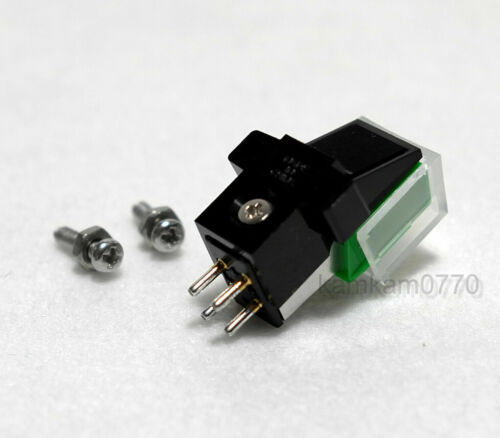

The metal body on the AT95E is attached to the plastic mounting bracket by a screw (visible on the top on the attached image).
Your Supex may simply have a snap-on arrangement, but I can't find any information which confirms that.
That white residue must be the old glue. Go ahead and glue it back in!🙂

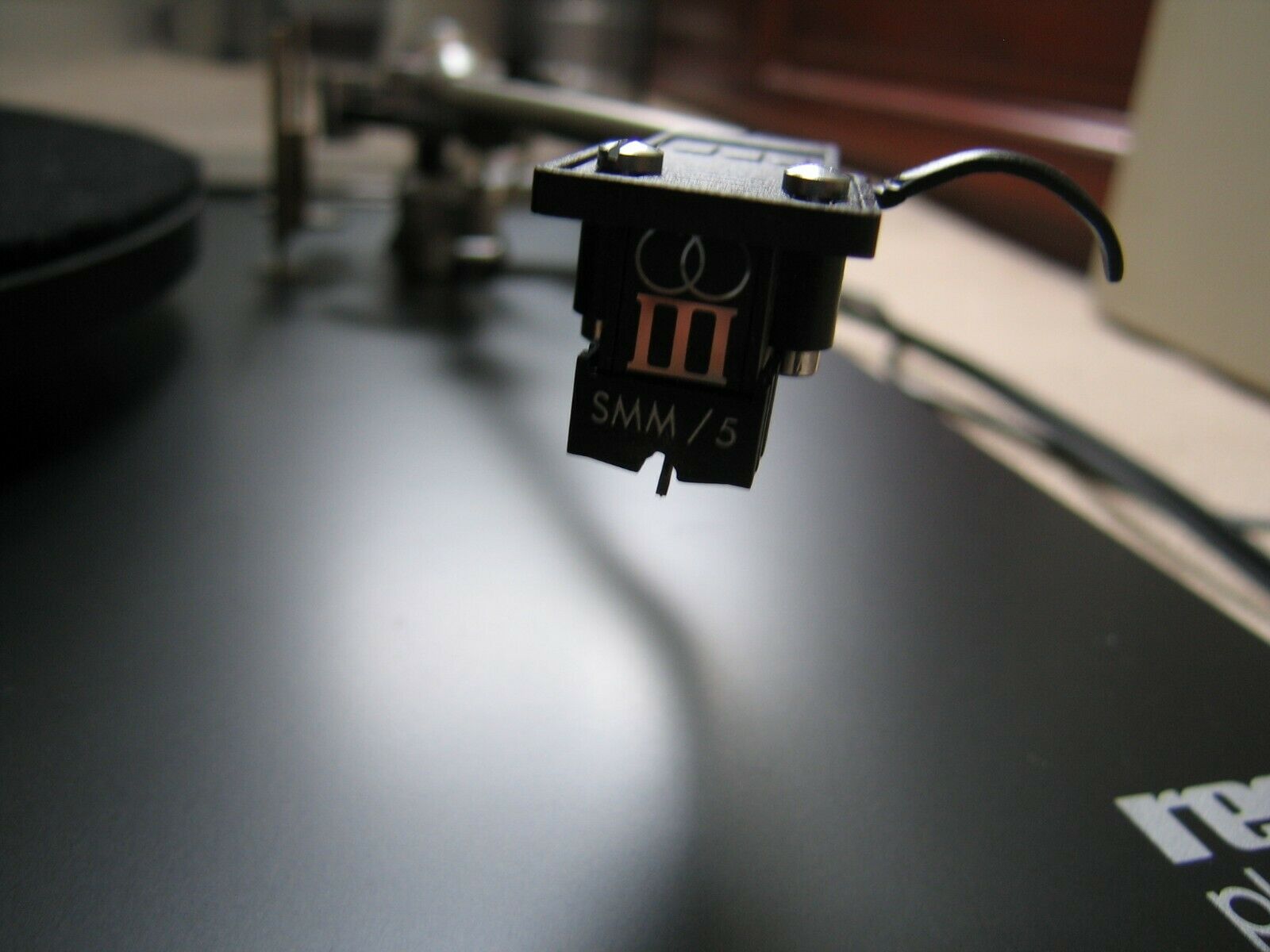

An SMM/5 stylus is available here:
Supex SMM/5, replacement stylus | My Needle Store
Considering the price, I think a spanking new replacement cartridge would be the more sensible and cost effective option!

Hello everyone, this is my first post.
So I had a bit of a win today. My best and most favourite cartridge is the Supex SM100 MkIII, and for a long time I've been scouring the interwebs trying to find a replacement stylus that is within my budget. Today I discovered that the generic stylus I ordered for my Shure M75e type 2 cartridge (N75ed or N75b) fits my Supex and I am just as happy with the sound as I was with the Supex smm/5 stylus I previously ordered online for 45 euro plus postage, as opposed to about $25Au delivered. I hope this helps anyone else who has a Supex tucked away in a cupboard because they couldn't afford to buy the original stylus.
Happy listening.
