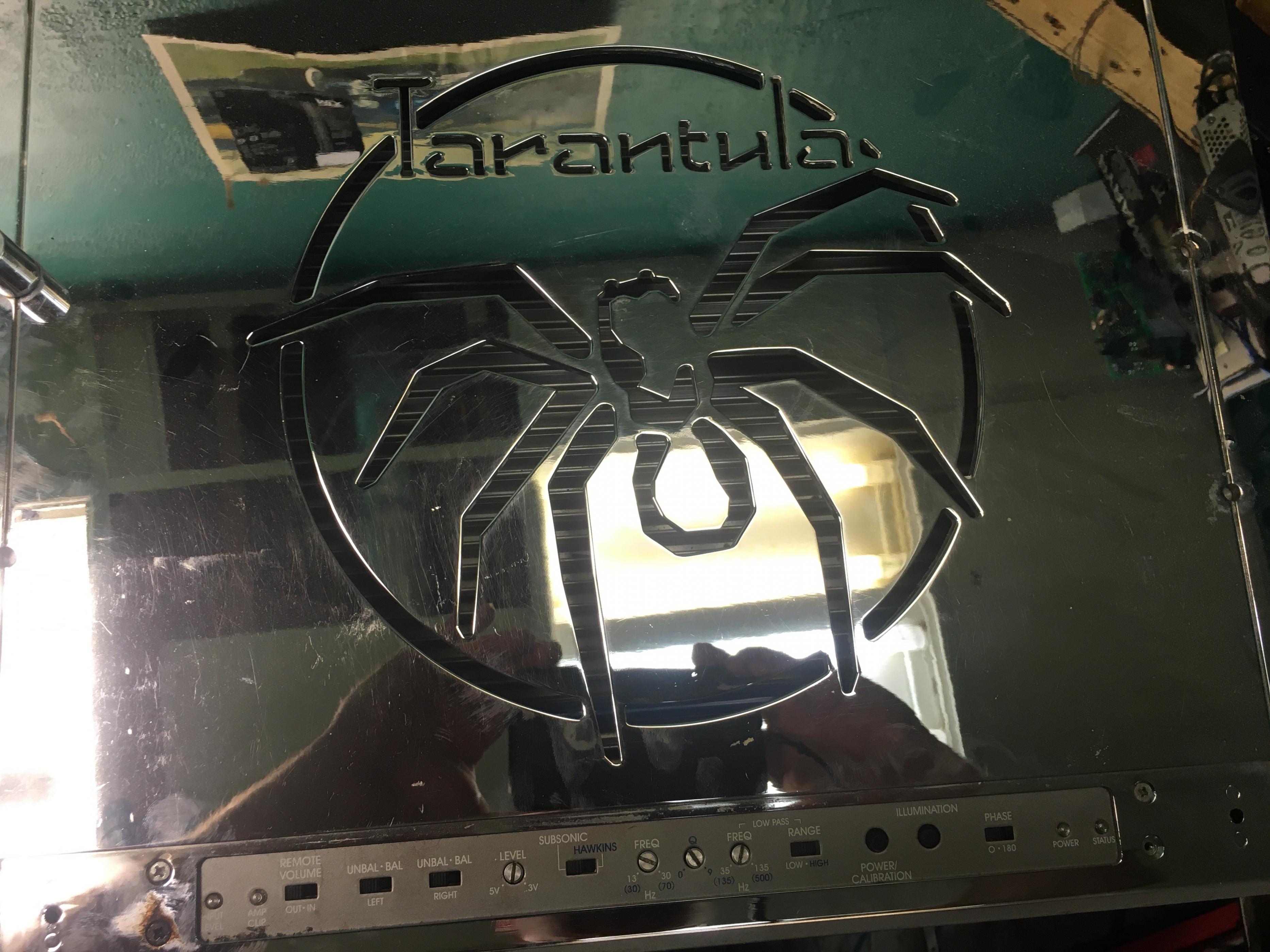

I got this amp in for repair and when I try to increase the input voltage
(Turn the volume up on head unit ) the amp will protect on me and as soon as I lower the volume on head unit it will power back up .
Does this sound like a problem in the preamp section ?
Or wondering where I should start checking

I found an LM34DZ which appears to be a temperature sensor
Leg 1 is the +5 volts
Leg 2 is the output
Leg 3 is the ground
According to the data sheet I found
Here are the measurements I get
Leg 1 to Leg 2: 30.0 ohms
Leg 1 to leg 3: 16.1 ohms
Leg 2 to leg 3: 16.4 ohms
Does this appear to be defective or is it suppose to measure like this ?

Heating or cooling it makes no change at all .
I will go through the rest of the amp and see if I find anything else bad .
After going through the amp I will order a new one and take readings off it .
I think the amp is stuck in protection now since it’s not producing rail or regulated voltages
