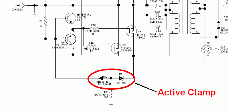

Good day guys, this power supply uses K1420 with 47ohms gate resistors, I can’t get those in my area to replace the bad ones. What other mosfet is suitable with this arrangement that I could just drop in, need for a more superior mosfet is also endorsed.
It’s exactly how you said it Sir Babin, I had a clear memory of that arrangement as I was on that specific area extensively while repairing the amp, infact my FETs on the thermal sensor side was becoming heated gradually too fast, when I checked, the zener diodes (39v) was leaking on both side of amp, I’ve replaced them then all FETs was cooled.
