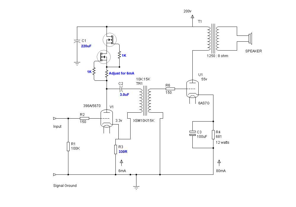

Here is a starting point. The plate voltage is 135v@80mA.
I want to add the fact that dsavitsk had a hand in that schematic I posted for you. It is untried but I'm comfortable with the operating point on the 6AS7. You should get about 2 watts out with those operating points without stressing the tube very much. The interstage is a Edcor as are the output transformers. Please post your impressions if you end up building a SE 6as7 amp.
Can either of you take a guess at a plate resistance at that O.P.?
I've seen 280 ohms, but at what O.P. I don't know. If that doesn't vary much, I admit I don't know that.

For two in parallel, mu stays the same and Rp is cut in half.
Yes, and transconductance(gm) doubles.
OK, and is rp is function of operating point or the tube itself, pretty constant?
I ask because I don't know in what context the 280 ohm rp number I found relates the the operating point of the example circuit recommended.

multi-volti said:OK, and is rp is function of operating point or the tube itself, pretty constant?
In general, Gm decreases (and thus rp increases) as current decreases. A quick look at the datasheets shows the 280 ohms to be at 120mA, so at 80mA rp will be higher. How much might be estimated from the plate curves, but I haven't seen this information published anywhere.
