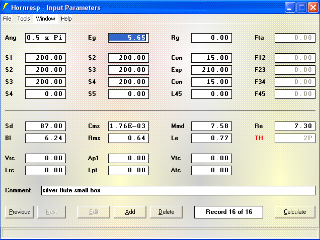

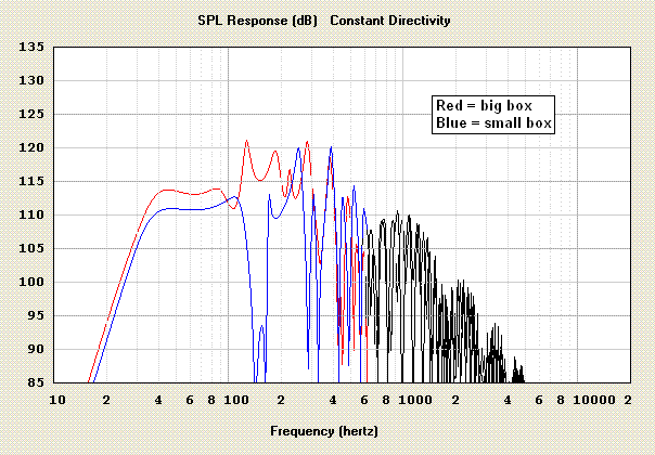

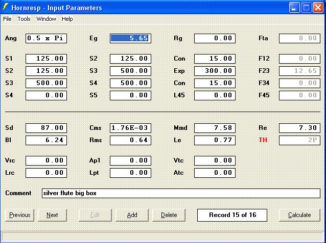

I see your point about the Xmax.
The two boxes shown below both reach Xmax with about 5.65V RMS input - about equal to 4W into 8 ohms or 8W into 4 ohms.

Thanks Godfrey, you pretty much modeled what I already have but it tells me I wasn't too far off. Now to fiddle around a bit and get what I want or as close to it as I can. Seems I can fold 10-12' of line into a box 26" tall by 10" wide by 24" deep, the folds being the hard part but with that length things start to smooth out a tad.... I have to Remember I'm not really looking for a Subwoofer, more good output for re-enforcement of the stated area where the dMar-Kens start to fall short with that being said I'm not expecting miracles from two 5.5" bass units either.
Can anyone help me do a double fold on the larger horn Godfrey modeled, I'm having a hard time grasping how to take a 9' line and fold it so it's no taller than 26". If I can fold it twice each line section will be 66cm long excluding material thickness. I'd ideally like to keep this cabinet in the 11 X 27 X 24" range if that helps at all, any guidance is appreciated... Take care.
