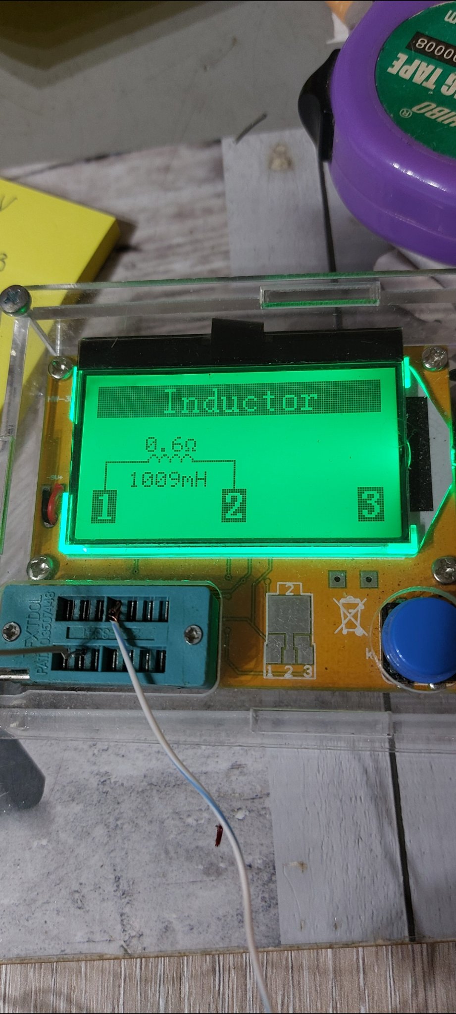

It seems that most DVMs that I have used don't have much resistance accuracy below the 10 ohm mark. Is there anything that is accurate at that level? From 1 or 2 ohms to 10 ohms.
I would be ok with a straight ohmmeter with no other functions
Even a cheap LCR meter can do it.
