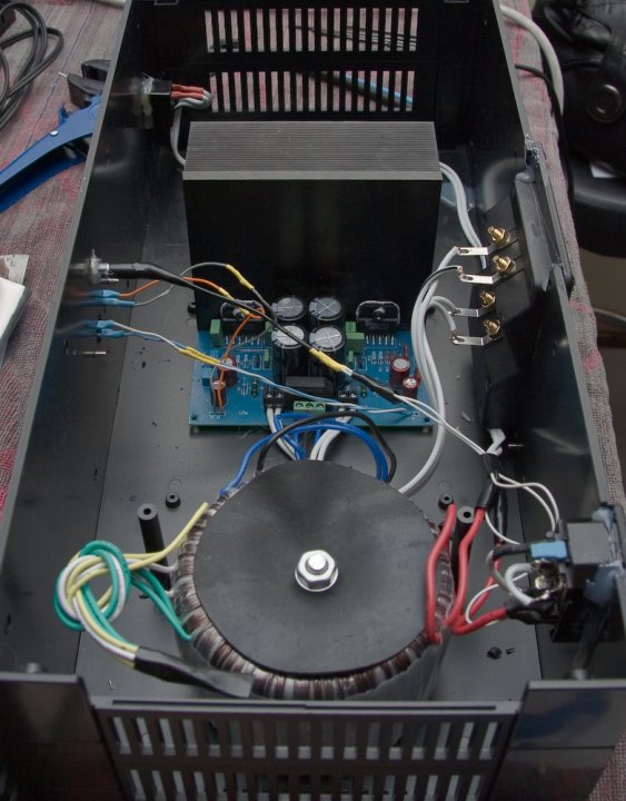

I've run into an interesting problem with my LM3886 amplifier. I get quite serious amounts of hum whenever the volume control on the amplifier is at anything other than 0 or full volume, when plugged into my diy DAC. This doesn't occur when plugged directly into a iPod, and interestingly it occurs even when the DAC is not plugged in! If the signal cable is not connected to anything it's fine, but just plugging it into the DAC without any power cable going into the DAC triggers it. Plugging in the DAC and turning it on doesn't affect the level of the hum.
I've also noticed that when turning the amp off, the hum stops immediately, while the music keeps playing for a few seconds. This seems weird to me, I would expect both to continue while the caps deplete.
I've tried floating the amp's ground by just not connecting it to main ground, but it didn't help. I can upload some pictures of its internals if need be.

The DAC is a kit, the one in the recent Silicon Chip, metal cased, with a star grounding scheme. I think the DAC is properly grounded, so it must be something I did wrong with the amp. Any pointers on how the amp should be grounded? Its plastic cased.
I've attached photo. The photo doesn't show the volume control, which was a latter addition.

Your main problem is that one or both pairs of your internal input signal and input signal ground wiring is forming open "loop area".
A time-varying (e.g. AC) magnetic or electromagnetic field induces a time-varying current in any conductive loop.
When an input is connected, the loop is closed, enabling induced AC current to induce voltages across any impedances in the loop, which would include the source impedance, and any resistance to ground at the amp input pin (as well as the resistance and inductance of the wires themselves).
The solution (mitigation, actually) is simple: Your input jacks should be isolated from chassis ground and each of your internal input signal and signal ground wire pairs should be inside of a shielded cable, the shield of which should be connected to chassis ground at the input end only, with the other end of the shield connected to nothing. If you can't use shielded cable, then tightly twist together the wires in each pair, for as MUCH of their length as possible. Only the shortest bare-minimum lengths of the wires should be unshielded (or un-twisted). And keep the wires as close to each other as possible, for those short unshielded or untwisted paths, even following against the amp input resistor to its ground end, with the ground wire, from where the signal wire connects to the resistor's other end.
Also make sure that you tightly twist together all OTHER conductor pairs, such as the AC input pair, transformer secondary pair(s), AC wire pairs to/from switch, rectifier output pair(s), DC power pairs, audio output pairs, etc, noting that Faraday's Law also works in reverse, i.e. a time-varying current in a loop will cause a time-varying field to be radiated. So tightly twist together ALL pairs, in order to minimize the effects for both "transmitters" and "receivers".
And ALSO, keep all small-signal and DC wiring as far away as possible from all AC and large-signal wiring and components. If such wires must approach each other, they should be perpendicular to each other.
Edit: Your amp is PLASTIC-cased?? Bummer. Then you might also have to worry about the interconnect cables from the DAC. But if you twist all of your internal AC wire pairs, you might not have to worry much about the interconnects.

I've rewired all internal wiring so it's now all twisted. It doesn't seem to have helped.
The original issue where the hum occured when the DAC was not plugged into power appears to have been caused by the DAC being in close proximity to the amp. Now that I've moved it futher away, it now only hums when the DAC is plugged in and connected to the amp. It doesn't matter if the DAC is on though.
So then it seems you do have an earth loop, and it seems to be input ground related (you say that hum only occurs on one channel when only one channel input is wired to the DAC). Do either the amp or DAC have a ground lift resistor (an R between 0V signal ground and chassis) ? Is the wiring diagram going to be coming out soon?;)
The DAC schematic shows that the mains earth is connected to the 0v line going into the signal board, if I'm reading it correctly. For the amp it looks like I'm just running the 3 leads from the transformer to the board, no mains earth wire. I dont have a 'chassis' ground due to the (ill-advised) use of a plastic case. So that could be the problem.
OK, its normally advisable to have some kind of ground-lifting network in place of a hard link. AndrewT should be able to advise on this, he's way more safety conscious than I:D
Well without a ground connection at all, there is a safety issue as you do have exposed metal parts. So to be totally safe you'd need to adopt double insulation standards so that a single point insulation fault doesn't turn your ins and outs into shocking hazards.
From the pov of your hum, the toroidal in your amp has appreciable capacitance to the mains (300-600pF is not uncommon). Once you connect your DAC there's a path back to ground, the amp 0V will cease floating and current (rather noisy with RF, not just mains frequency) will flow along your interconnect shields into the DAC. This is normally less than 1mA at mains frequency but will induce a hum voltage across your grounding wires. This might be part of your problem.
